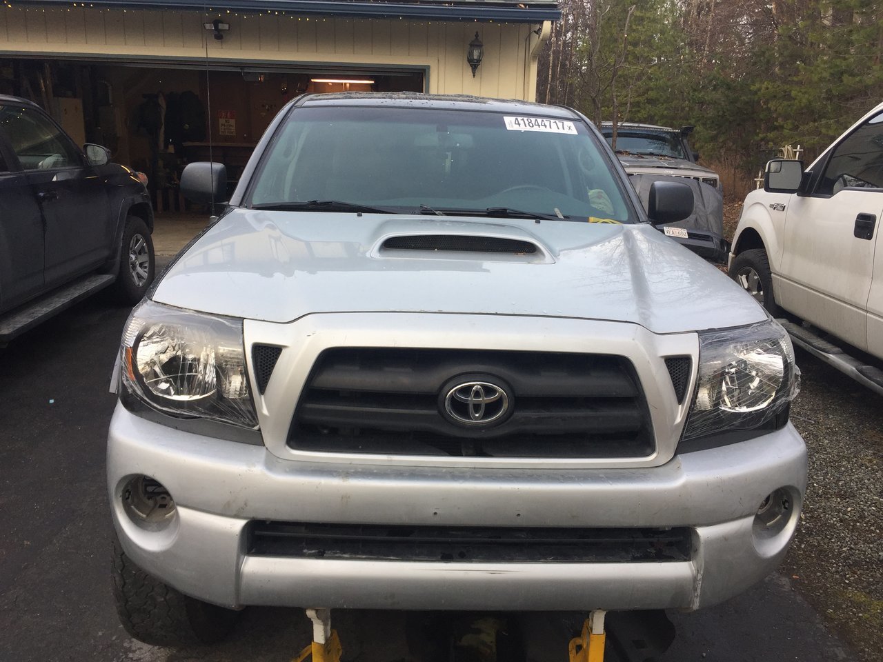

    Hi all, new around here. Here's a project I just picked up to make into my new commuter. I don't know a lot about these trucks so any help is appreciated!
    Here is what I found damaged
    LCA and LCA frame mounts
    UCA
    CV Shaft
    Coilover
    Knuckle
    Brake line
    Steering rack
    Abs lines on front Ds and rear ps
    Fender
    Hood
    Grill
    Headlights
    3 of the 4 tires
    1 wheel

    So far I have replaced/replacements these parts:
    Front struts -Bilsteins (undecided on ride height)
    Camberg BJ UCA's
    Drivers side LCA
    Knuckle
    Steering rack
    Scooped hood
    Depot headlights
    Grill
    Bumper
    Drivers side fender
    Things I still need or need to do...
    I need a used/junk UCA & LCA so I can get it rolling again and to the body shop and get it on a frame rack to straighten the LCA mounts. Any recommendations fir s good body shop out in the Palmer area? I was going to go to Metal Creek.
    Paint work bumper, grill, hood and fender
    Here's how it's sitting now:

  3. Oct 30, 2017 at 2:07 PM
    SnowroxKT
    SnowroxKT Well-Known Member
    Dec 11, 2011
    #68604
    5,312
    Kyle
    Anchorage Alaska
    '18 T4R & '06 F250
    6" lift 40s
    Looking good, what happened to it before you got it?
    Don't know of any good body shops out there, Chaz has done some pretty good work on my dad's Tundra, not happy with FixAuto though.
    I heard a rumor Worthington Ford in Anchorage (bought out by Kendall) had a frame straightening rack, don't know if thats true though.
