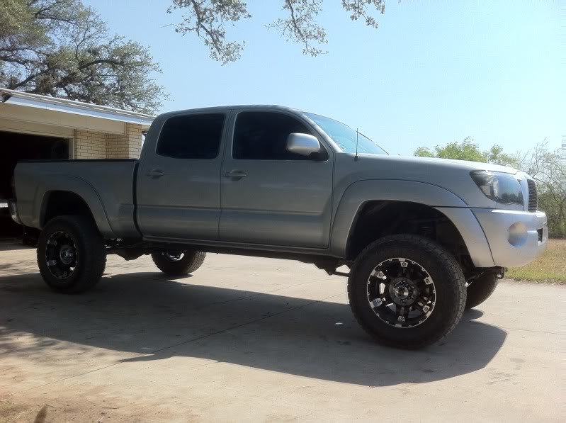

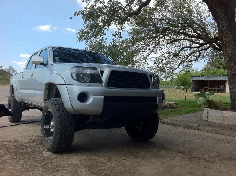

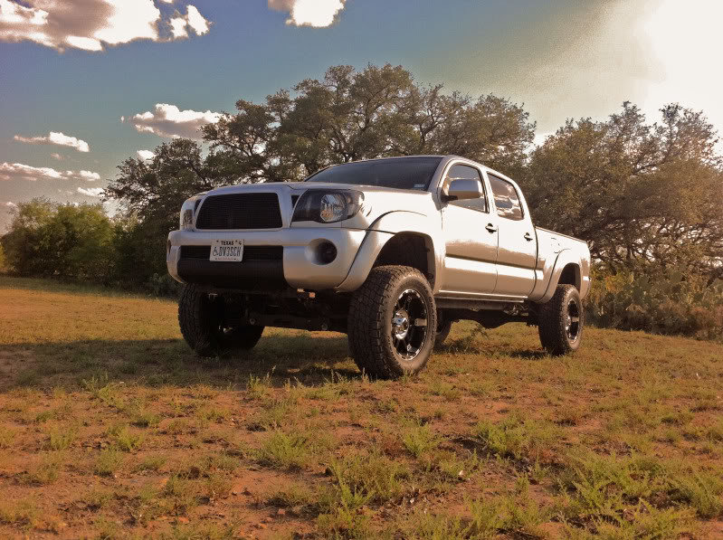

  11. Dec 23, 2011 at 3:44 PM
    4X42HEL
    4X42HEL [OP] Don't really understand 2WD trucks....
    Jul 25, 2010
    #40716
    353
    Albuturkey
    Hot Wife
    That's interesting. I contacted the shop and I even called ProComp today and they all suggested just putting the AAL on as described.
