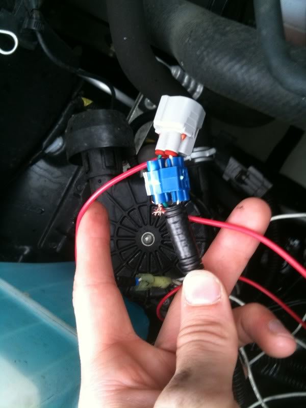

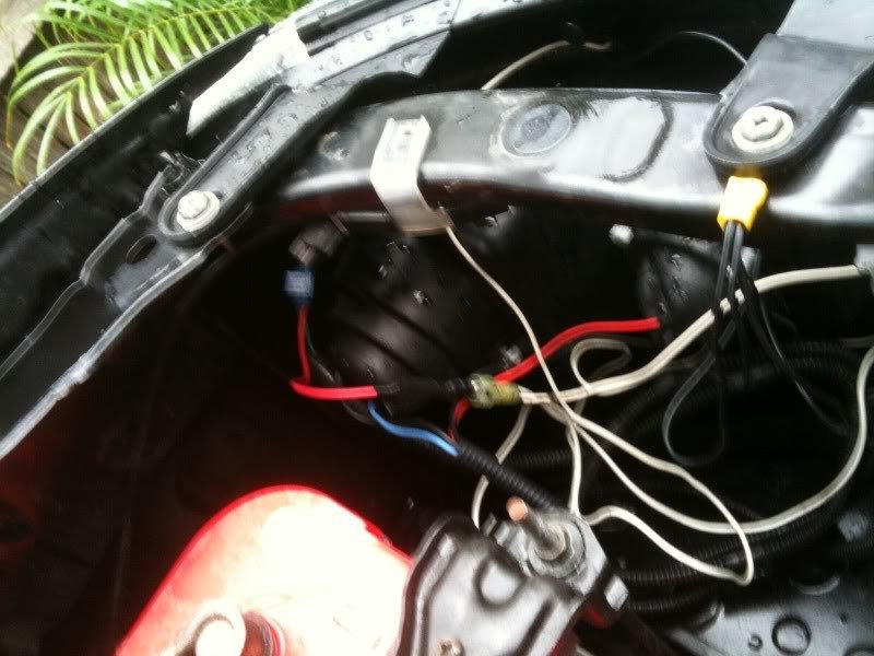

    the lights themselves work perfectly. today i tried to wire the leds, and i wired them multiple ways but nothing worked.
    the first one i wired the power cables to a male to female and quick connected it into the power for the corner running lights and put the ground wires on a grounding ring to the chassis. .... nothing
    the second light i connected both the power and the ground to their own corresponding colored male to females and quick connected both the power to power and the ground to ground of the corner running lights. still nothing. any help?

    this first image shows the first wiring i described. the black to a ground ring to the chassis and the power to the male to female to the quick connector of the corner running lights
    this one shows the black wire to a male to female quick connected to the ground. i used red wire because i did not have any black wire. also shows the power ran to male to female and then quick connected to the power

    I just used (forget what they're called) and spliced into the factory Parking lights for my LED halos just below where the factory connector is. I used those connectors that dont actually disrupt the factory connector, but just tap into it basically. I can't remember the damn term.

    so i used exactly what you did btw just a blue quick crimp connector. im thinking the connector didnt cut through the plastic properly. also, is it possible that the leds arent working and i can just change them all out?

    i got them to work!!! the quick crimp wasnt giving a connection so i had to shave the plastic off the wire
