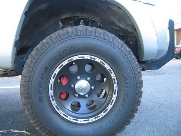

    BF GOODRICH T/A ko, BILSTEIN HDs, AMERICAN RACING RAZOR`S 16X7.5, READYLIFT SST HYBRID LIFT SYSTEMS, ALTEC LANSING AUDIO,DREGS OF THE EARTH SYSTEMS,WOLF EYES,SUREFIRE ILLUMINATION TOOLS,HK-PROTECTION!!. POP LOCK, SHORTY ANTENNA, TACO TENT #3,. NITECORE ILLUMINATION, FENIX FLASHLITES. STILL PROTECTOR`S, FACTORY BED MAT, CUSTOM BED WEB, INTRO-TECH INTRO-GUARD CUSTOM TRUCK COVER, CENTER CONSOLE LOCK MOD, TECH-SHADE M1068, WEATHER-TECH CLEAR-COVER`S, OEM MINI TIE-DOWNS, TRUCK BEDZ AIR MATTRESS EXPEDITION SERIES, McGARD TOUGH NUTS WHEEL LOCK`S, DISABLE SEAT/BELT CHIME MOD, GARMIN GPS, KERSHAW BLADE`S, SKELETOOL, WEATHER-TECH FLOORLINER DIGITAL-FIT GRAY # 461781, NITE(IZE) KNOT-BONE ADJUSTABLE BUNGEE SYSTEM, WET OKole SEAT COVERS, UNDER DASH FLYZEYE BW LED LIGHT W/CUSTOM BLUE HALOS. NITECORE IFE1 INFILUX ILLUMINATION SYSTEM. JETBEAM BC-10 HANDHELD, HK VP-70Z 9mm PROTECTION!. JETBEAM PC-10 550 LUMEN ILLUMINATION SYSTEM. SUREFIRE E2D-LED-DEFENDER ULTRA 500 LUMENS KICK ASS ILLUMINATION...VIPER ALARM SYSTEM`S,ROCKFORD FOSGATE POWER COMPONENT SYSTEM`S.KENWOOD AUDIO/VIDEO,HUSHMAT SOUND DEADENING INSULATION,3M AUTOMOTIVE FILMS.
    COULDN`T HAVE SAID IT BETTER!!!.

    that is common for all taco's - take a grinder to that part of the caliper that sticks out for no reason and take like 1/8" or so off then paint it with some black or red caliper paint and you are good to go.
