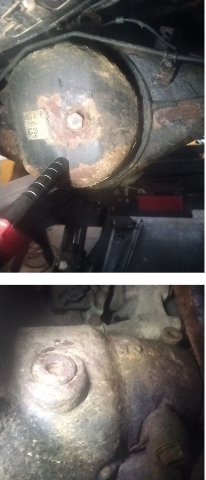

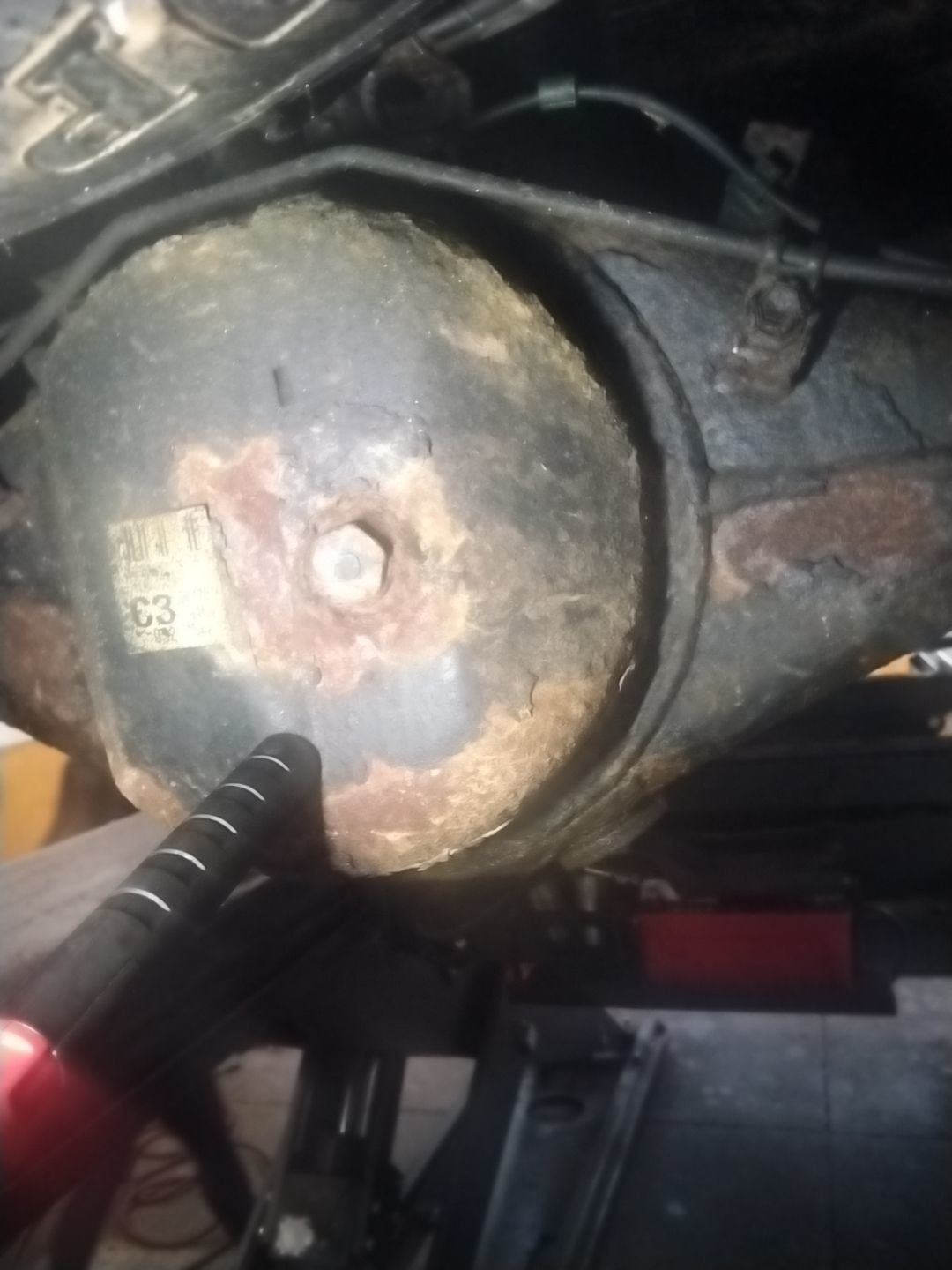

    A mechanic recently took some pictures of the front and rear differentials. This is a 2010 Toyota Tacoma base model with a 4.0L 6-cylinder engine and 117,141 miles. The truck was purchased in New Jersey in the summer of 2023, with 110,947 miles. The mechanic's assessment was to not attempt to change the oil in the differentials. One of the plugs was damaged, with the top sheared off, while the other was so badly rusted that attempting to remove it would probably result in it being damaged as well.
    So, the question is: what should I do next? Should I leave the situation as it is, and hope to get another 50-60,000 miles out of the vehicle? Or should I look to have someone drill out and replace the damaged plugs and do the oil change? This sounds like it has the risk of killing the differential. Alternatively, should I wait a year, or two, and replace the differentials?

    What is the 2nd picture of? The fill plug looks rusty but I’m sure it’ll come out, soak it with pb blaster and tap it a few times before loosening it up. I’d buy a replacement plug too. The drain plug is on the bottom, they are 24mm but 15/16 can be used.

    Take it to your local exhaust shop and have nuts welded to the heads of the bolt.
    They might might even “loosen” them up for you. :thumbsup:

    Diffs need occasional fluid changes. Rust can eventually cause a leak. There are ways to remove those plugs.
