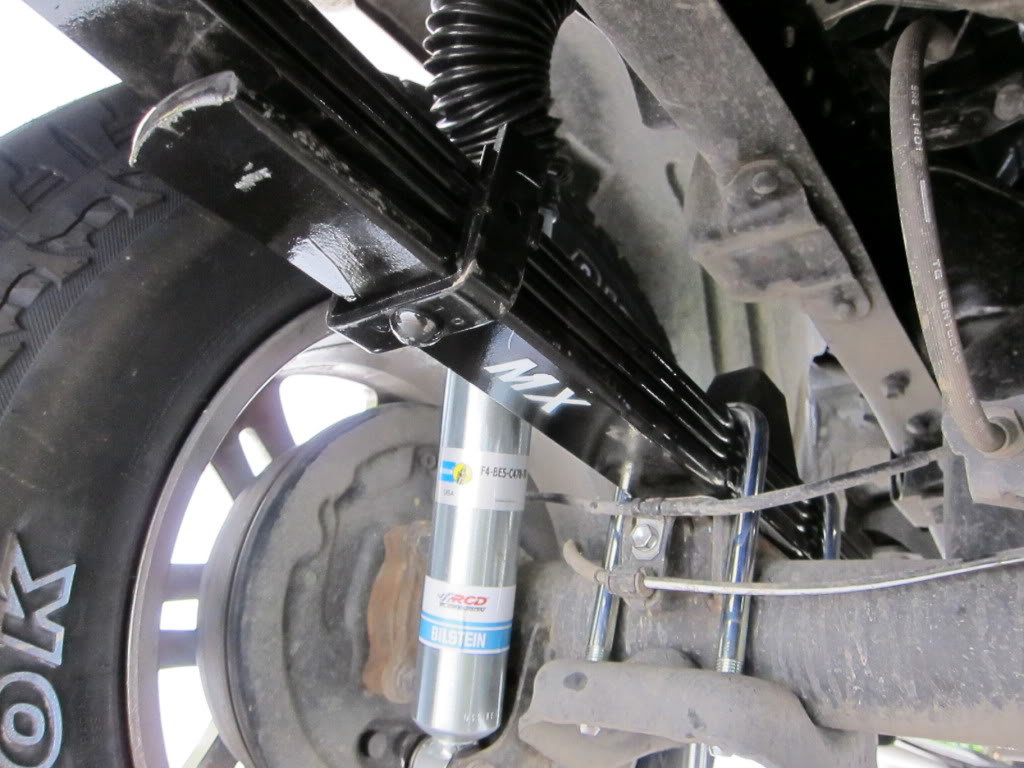

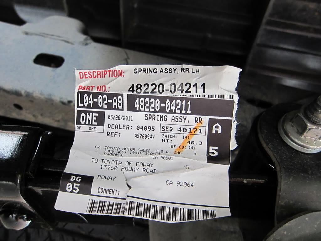

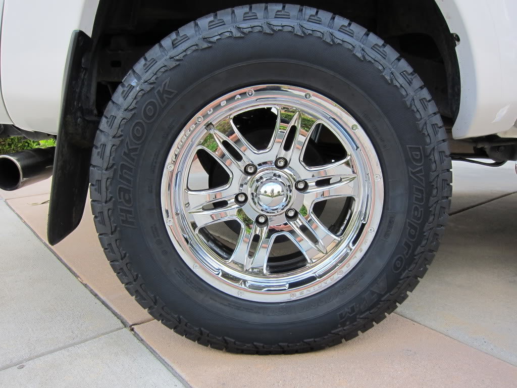

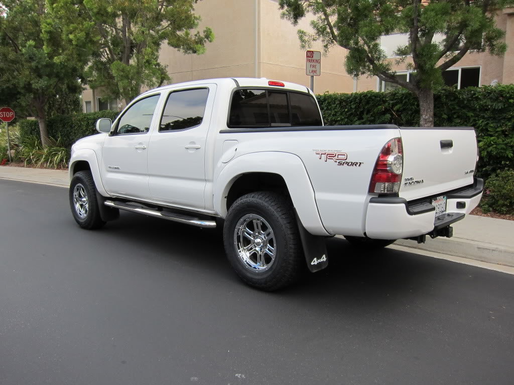

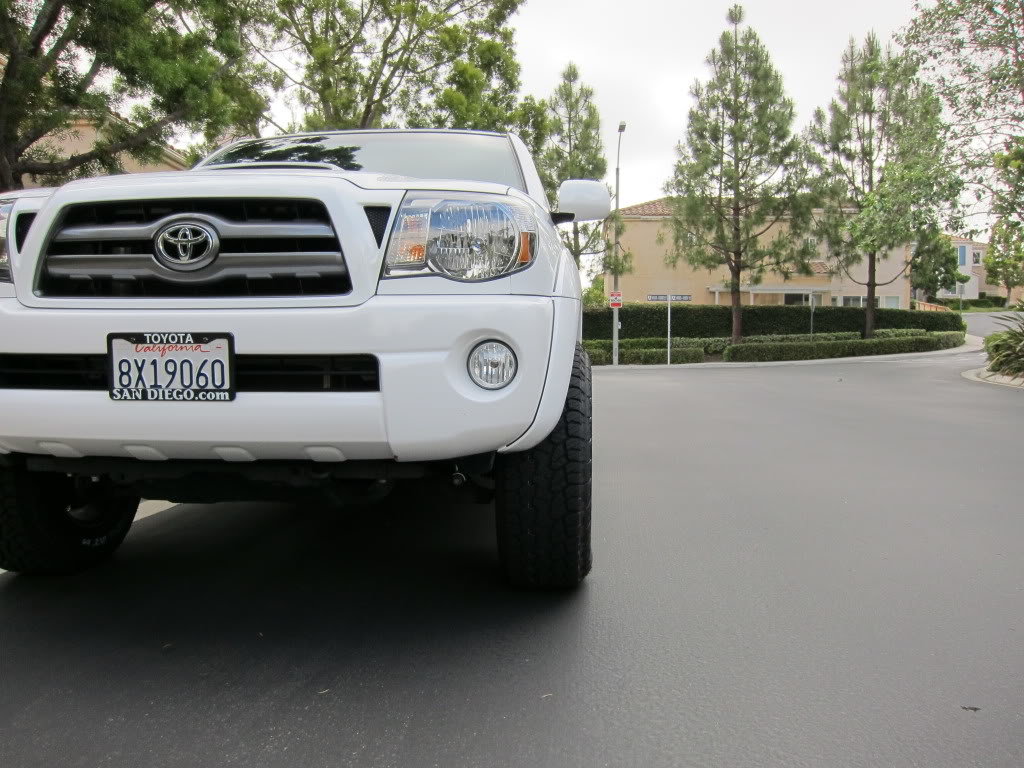

    Toyota did the rear leaf TSB on my Taco and I asked them to install the Bilsteins, with the 5100's set to 1.75" in the front. The ride is 10 times better than stock! I only have the shocks, no other spacers or stuff.
    Wheels: Weld Racing 17x8.5, 6x5.5 -6mm Backspcing 4-7/8
    Tires: Hankook Dynapro ATM 265x70x17
    TSB: T-SB-0359-10 Rear Spring Harsh Ride
    Thanks to:
    Shocks - Downsouth Motorsports (Marco)
    Tires - Extreme Custom Wheels ("Mescalero")
    Wheels - Forum Member ("Gorilla_97")
    SlideShow:
    http://tinyurl.com/3e8at9d
    Pics:

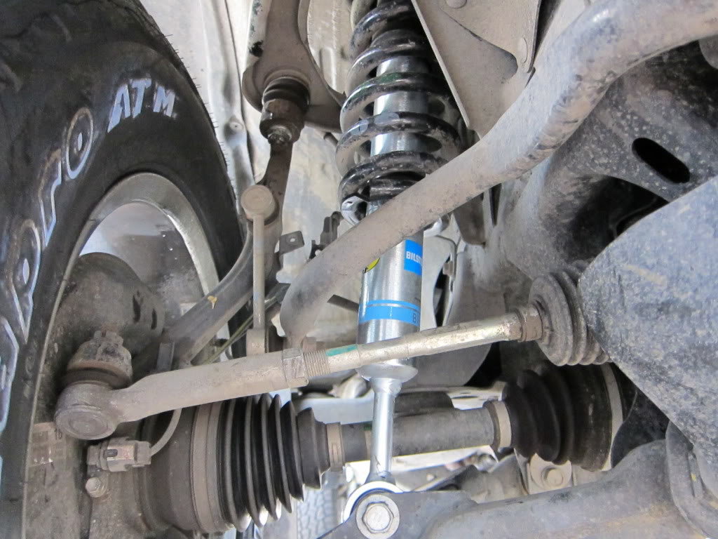

    Fronts set to 1.75"....just to level out the truck.

    Thanks, if you look at the front suspension pic, it looks like there was some rubbing on the inner front tire, not sure if that was from before the lift, or my speed bump testdrive this AM. I can't feel rubbing and it sure looks like there is enough clearance.

    The wheels look great on the white Taco!
