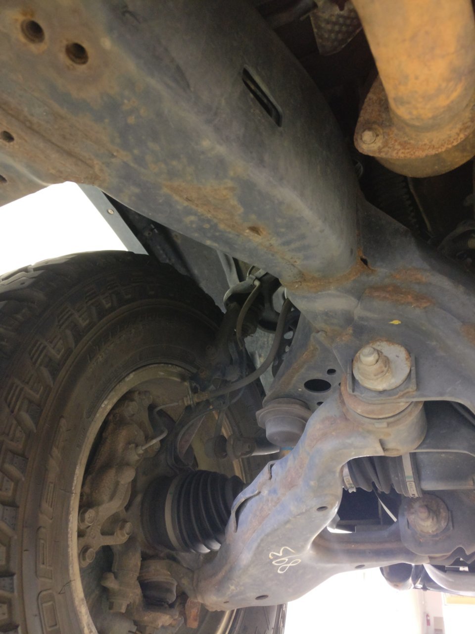

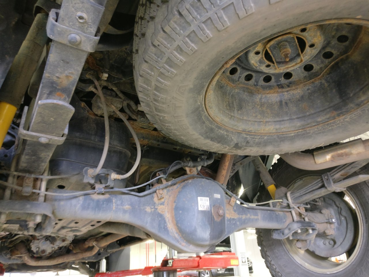

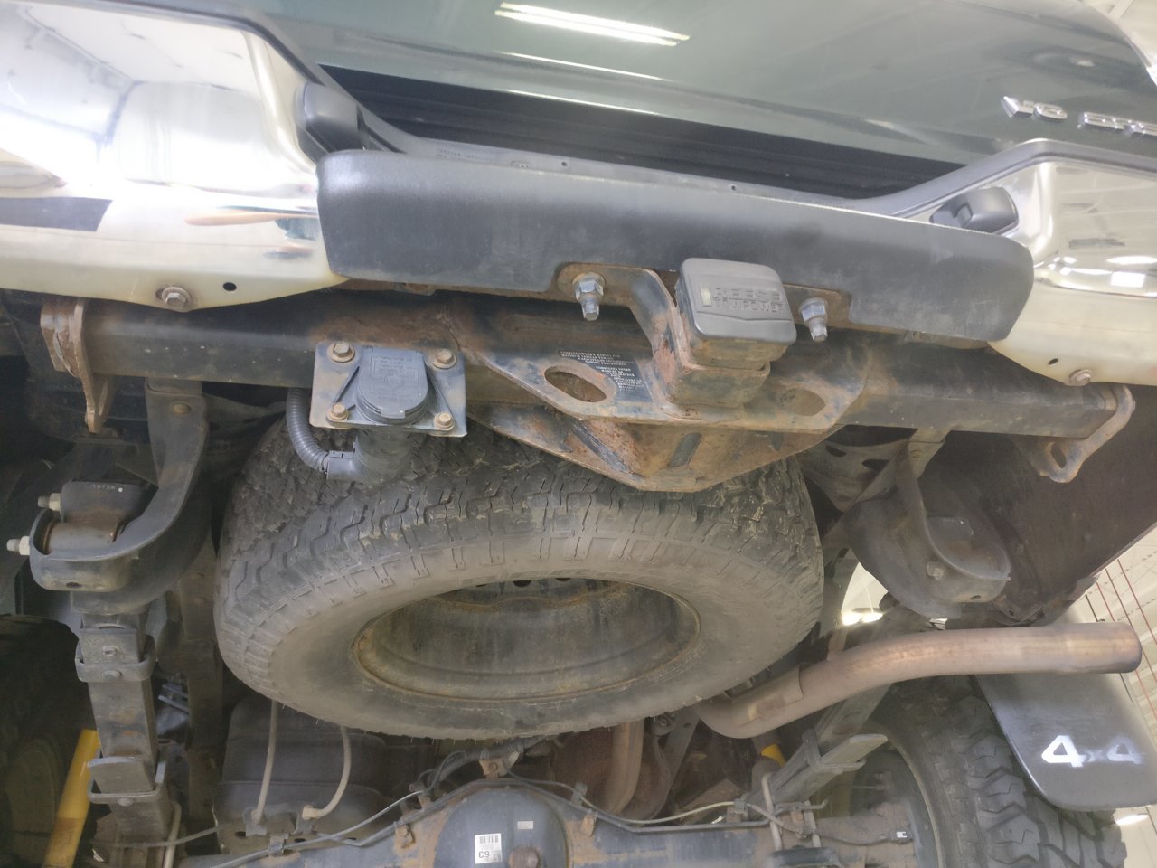

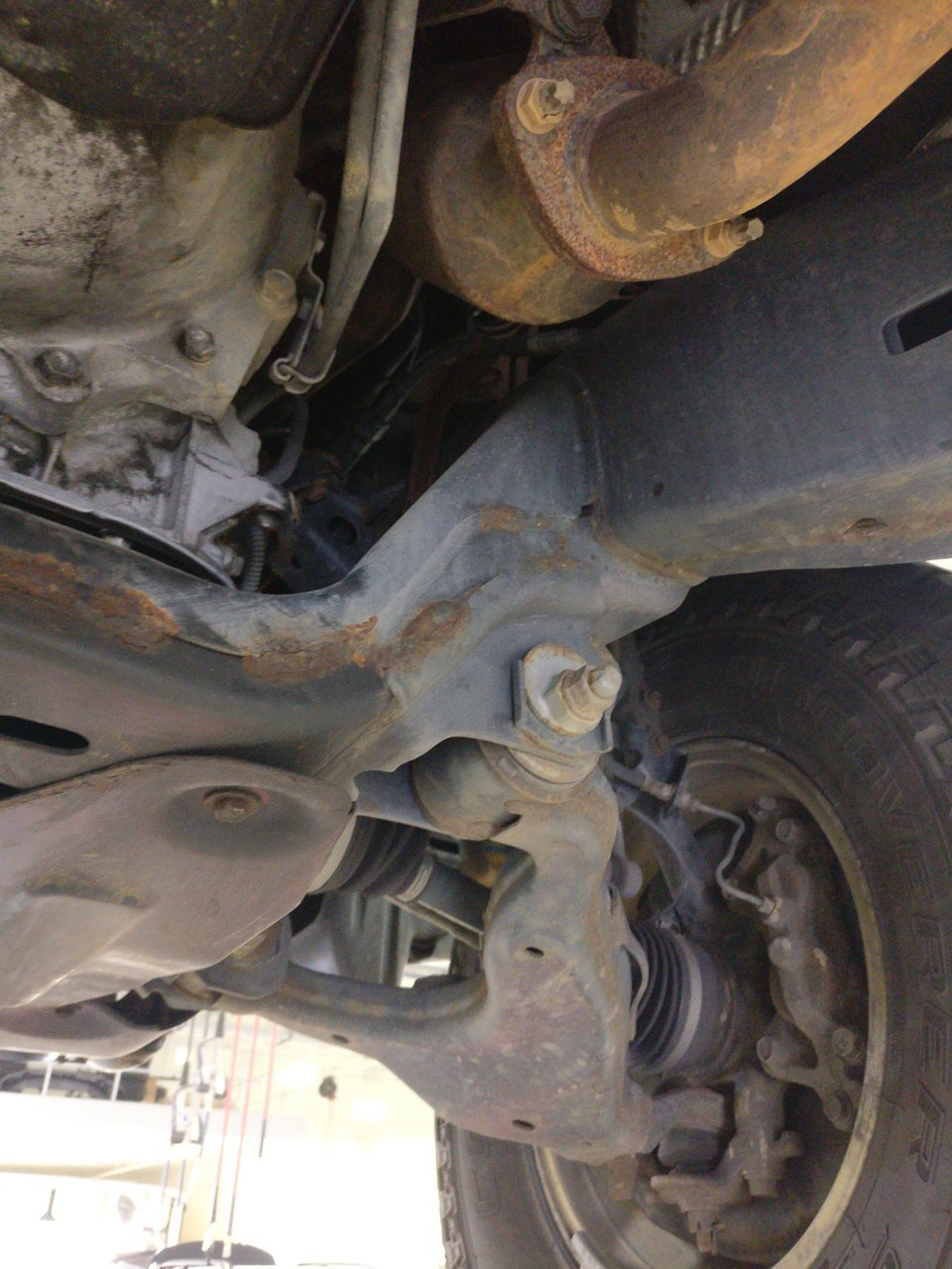

    Warranty Enhancement Program ZH6 Certain 2005 - 2010 Tacoma Extension of Warranty Coverage for Frame Corrosion
    Primary Expiration Date : 01/31/19
    Secondary Expiration Date : 02/26/22
    Status: Potentially Eligible
    Customer Support Program ZH2 Certain 2005 - 2011 Model Year Tacoma Coverage for Propeller Shaft Universal Joints
    Primary Expiration Date : 04/30/19
    aficianado likes this.

    Not much service history wise. Oil change here & there and recalls done. I would do all fluids, spark plugs, etc if purchased.

    So the frame has minimal rust and almost certainly won't qualify for replacement. Can I still get the CRC treatment? He says it may not qualify for that either, but I want to ask them to do it anyway.

    Here are some photos with it up on the lift, by the way.
