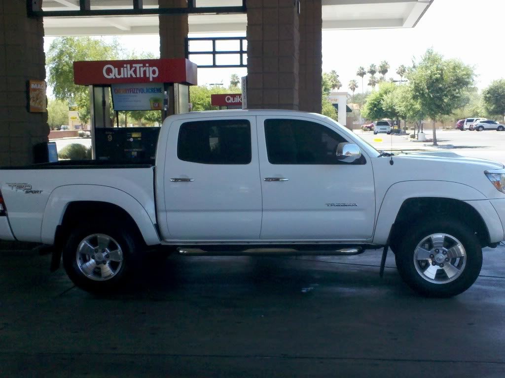

    is this much lean normal, i picked this truck up today from the dealer. i looked and it doesnt appear to have any spacers up front. not sure if the TSB has been done. just looks like its got to much "bro lean" for stock. Does this look about right?

    Something is not right , or not stock
  5. Jun 21, 2011 at 11:11 PM
    BulletToothTony
    BulletToothTony Im only a dick 90% of the time
    Feb 20, 2008
    #4833
    14,798
    You can call me Susan if it makes you happy.
    That does kinda have the "bro" lean, no spacer or nothing??

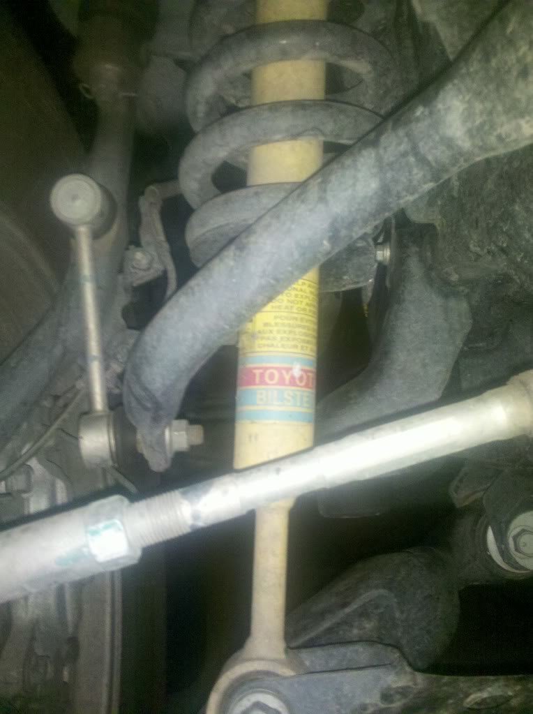

  17. Jun 21, 2011 at 11:40 PM
    #17
    zackbremer
    zackbremer [OP] Well-Known Member
    Oct 8, 2010
    #44407
    60

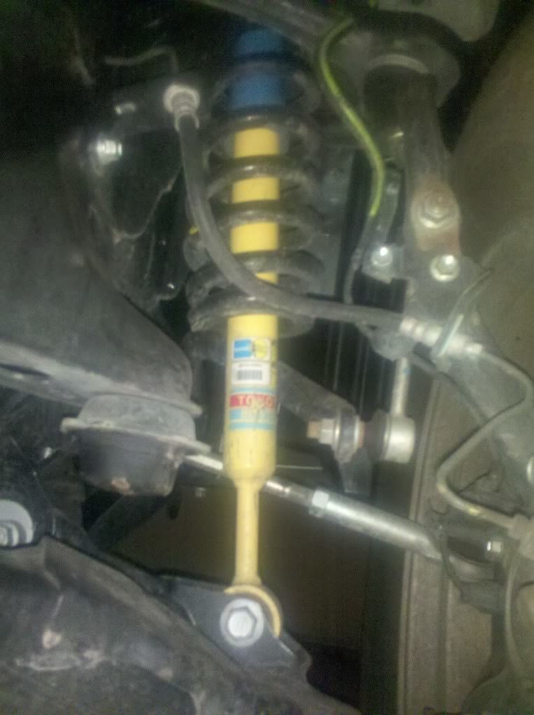

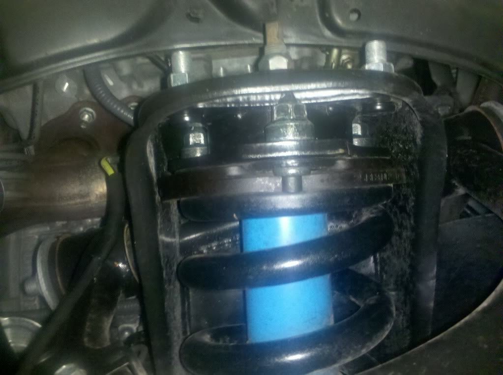

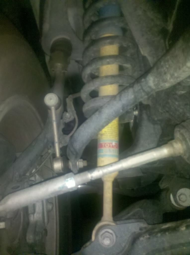

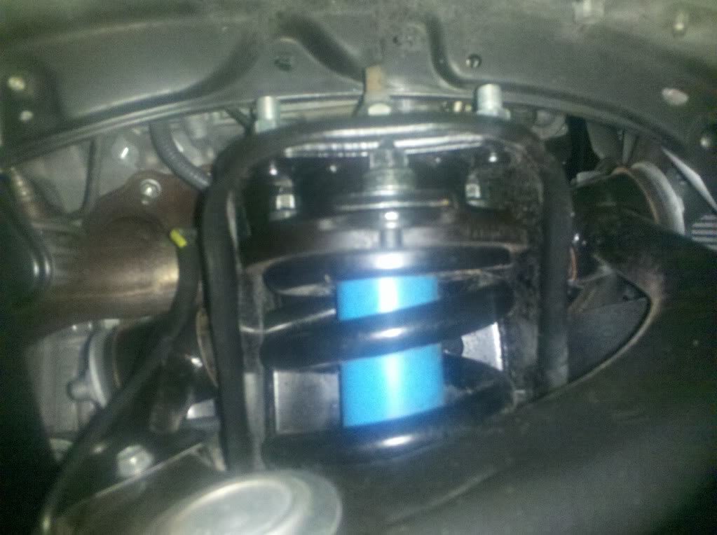

    top of front right
    also view of front from under front bumper

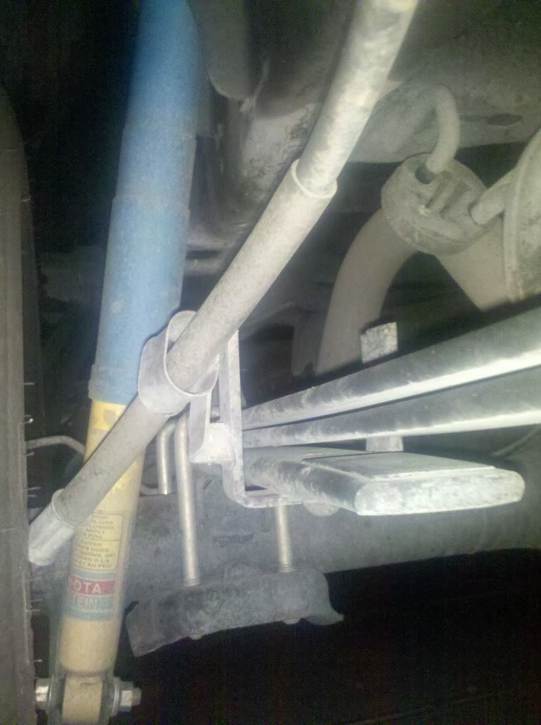

    view of leaf pack
  18. Jun 21, 2011 at 11:40 PM
    #18
    Tacomanator
    Tacomanator Boiling denim and bangin whores
    Jul 25, 2010
    #40746
    4,614
    Clam Slammer
    Southern Cali
    King 2.5" extended travel coilovers with compression adjusters, Camburg UCA's, King 2.5" rear shocks, TRD 1st gen CAI.
    It has a spacer...
  19. Jun 21, 2011 at 11:41 PM
    #19
    OZ-T
    OZ-T You chose ... poorly
    Dec 15, 2009
    #27584
    43,921
    Peter North
    British Columbia
    What kinda top spacer set up is that ?
  20. Jun 21, 2011 at 11:41 PM
    #20
    OZ-T
    Dec 15, 2009
    #27584
    43,921
    Peter North
    British Columbia
    And non - TSB leafs
