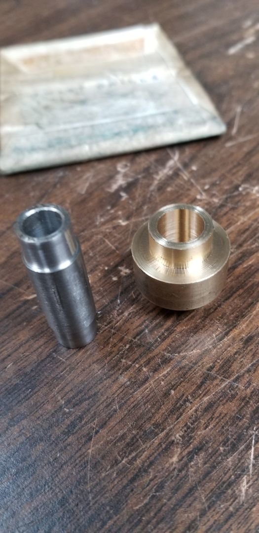

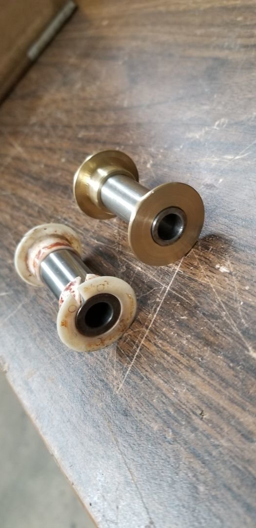

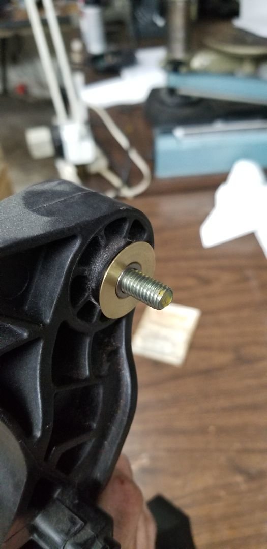

    Made my prototype clutch pedal bushing today and installed it for testing. Initial results are instant. That slight less bit of slop really helps with gear changes. The original design has poor tolerances and allows the pedal to rock all over the place and deflect your input. I did write down the dimensions I ended up with. I'll be making these on the cheap as a kit if I can get at least 20 people interested in them.

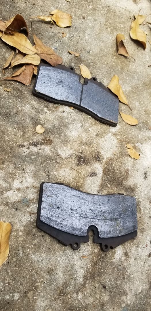

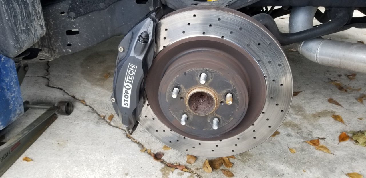

    Changed out the brake pads as well. You could say they've been well used. Bled with DOT 4 and the fluid had some gunk in it, but nothing to worry about. Installed were the StopTech ST40 Sport brake pads, since all the exotic offerings were $100 plus. I don't play that shit in Miami traffic, and these front rotors have maybe 30k left on them before they are below spec.
