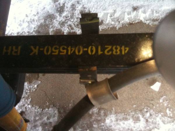

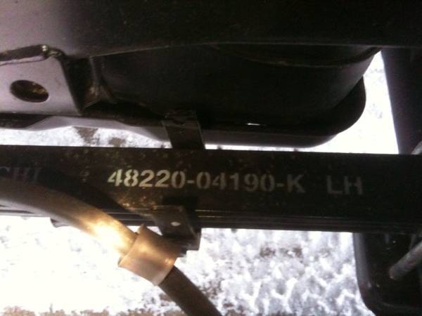

    Here is a pic of the part numbers I took off my leaf springs. I saw some people were wanting to see a pic of where the numbers are so I thought I would post it. I also want to have my ammo when I talk to the dealer on Monday. Good luck everyone with getting there's done.
    [​IMG][​IMG]

    That's great, thanks for those pics. Does anyone have any idea if I would have any additional resistance for having it done on a leased truck?

    New springs this morning. Ride seems a little better. The service manager stated that if the part numbers are the same as the previous TSB he could order and replace. No real difficulty getting change other than initial visit to check #s, second to change springs.:)
