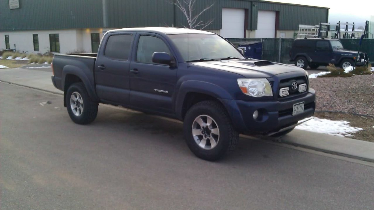

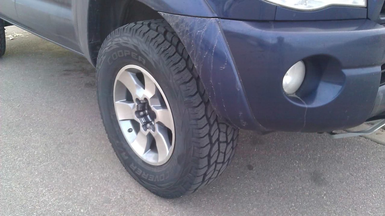

    Thought I'd contribute this combination since I hadn't see it anywhere before. Rims are from a 2011 4Runner SR5 and are 17x7 with 4.75" BS. Tires are Cooper Discoverer AT3s in 275/70/17 Load Range "C."
    No lift on this truck...bone stock suspension save for airbags in the rear. Everything clears with no rubbing anywhere that I've found yet. My front mudflaps were torn off some time ago, so I can't say they wouldn't rub there and I did trim the little plastic nub off the air dam in front of the front tire when was running Spidertrax.
    Switched to these tires from BFG ATs. WOW what a difference! First thing I noticed upon driving away from Discount Tire was how quiet and smooth they were! They put 38psi in the tires and, honestly, the ride is more supple and compliant than the BFGs at 34psi. Really a nice ride.
    Seem to hook up very well in the snow....no excessive spinning on the slick stuff.
    No center caps yet, but I'm scrounging for a pair. Kind of like the look as is, but I think I'll pick up a cheap set somewhere and paint them black or dark gray.

    I just ordered the exact tire (size and all) to go on my truck with FJ oem wheels. I'm currently rubbing pretty good on the flaps and the front plastic while turning with 275/60/20 (33") and lifted 2", so I'm thinking I will be in the clear with the new tires.

    You just might. Let me know if you clear. My flaps were torn off a while ago, so I don't know if they'll clear or not.
