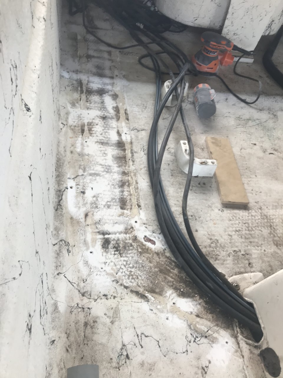

    I’ve torn up the cable channel and filled old holes in. I also don’t see a need for some of the rod holders on the gunnels and not happy with holes there filled in with silicon. Previous owner had cracked the bow while launching I guess, and put a tube of silicon to fix it, so I put a bunch of glass there to patch it up. Almost ready to gel coat.
    Once the gelcoat is repaired I’ll replace old copper wires for marine grade tinned copper. And install a jack plate...

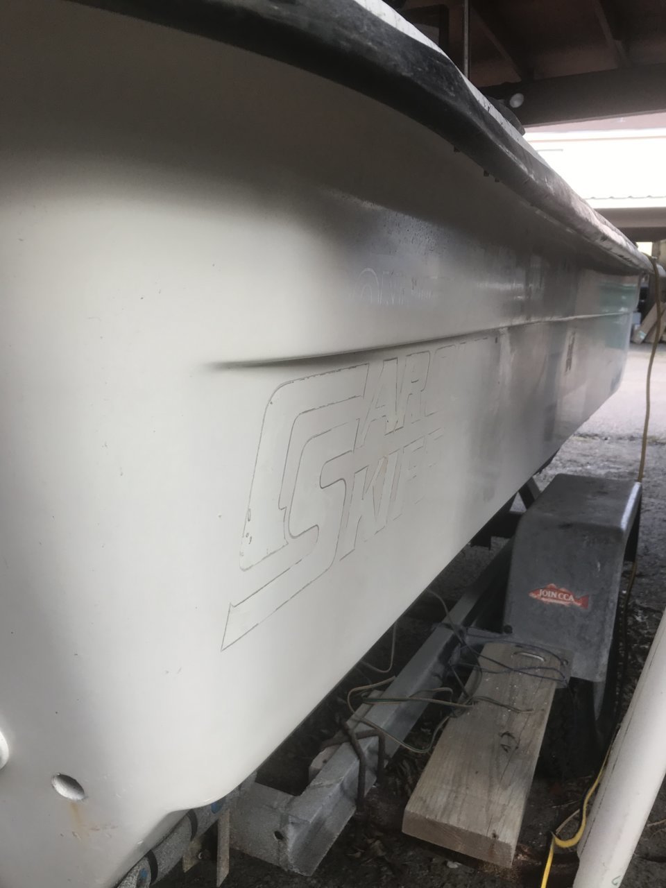

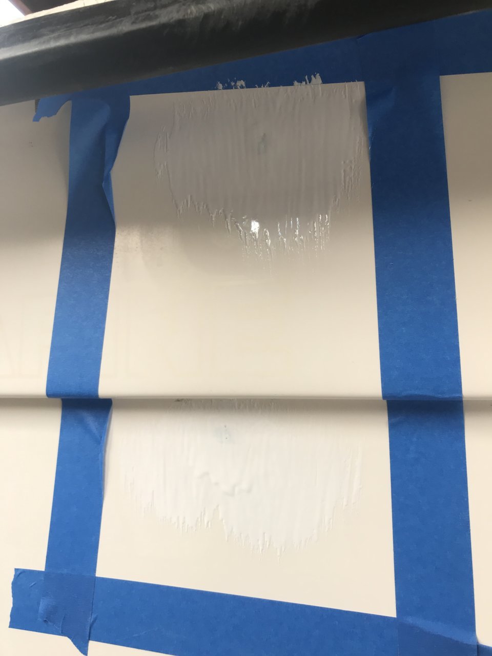

    Got some gel coat from the store that rhymes with pest latrine. Only had about 10 min of work time and it started chunking up. Blue tape really is to remind me where to touch up.
    Next I’m gonna wet sand with 600 grit. Then 1000, 1500 and 2000 if I can find it. Then rubbing compound and wax.

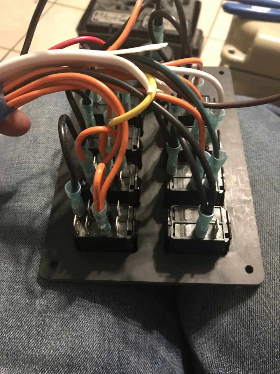

    Almost ready to install this on my skiff 2A651D81-8CEF-46C4-A68B-D5134FE2F2D0.jpg5D744BFA-4C60-4F1E-B746-8B6E30C14F9B.jpg

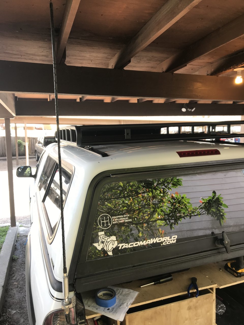

    Installed Yakima tracks and a Baja Rack today. 51767BBF-C546-4A33-B45B-07CBD36DBD79.jpg4CC9F816-E085-47A0-8DB8-304C111BA9E4.jpg
