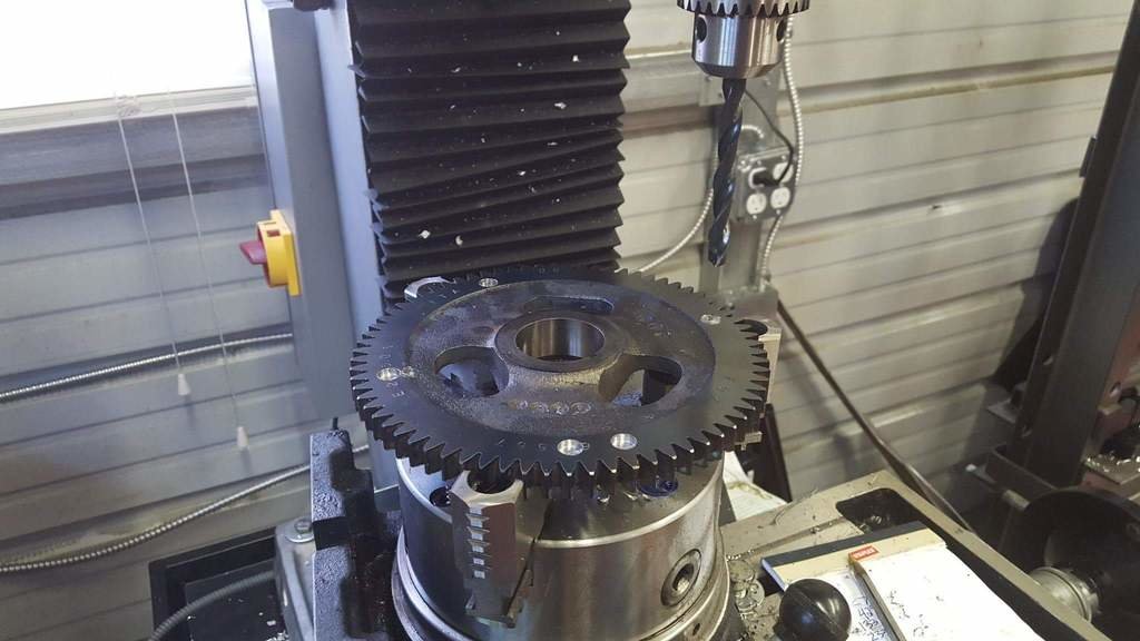

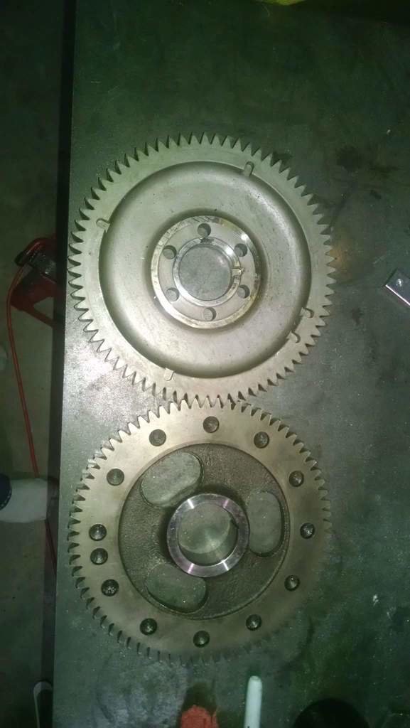

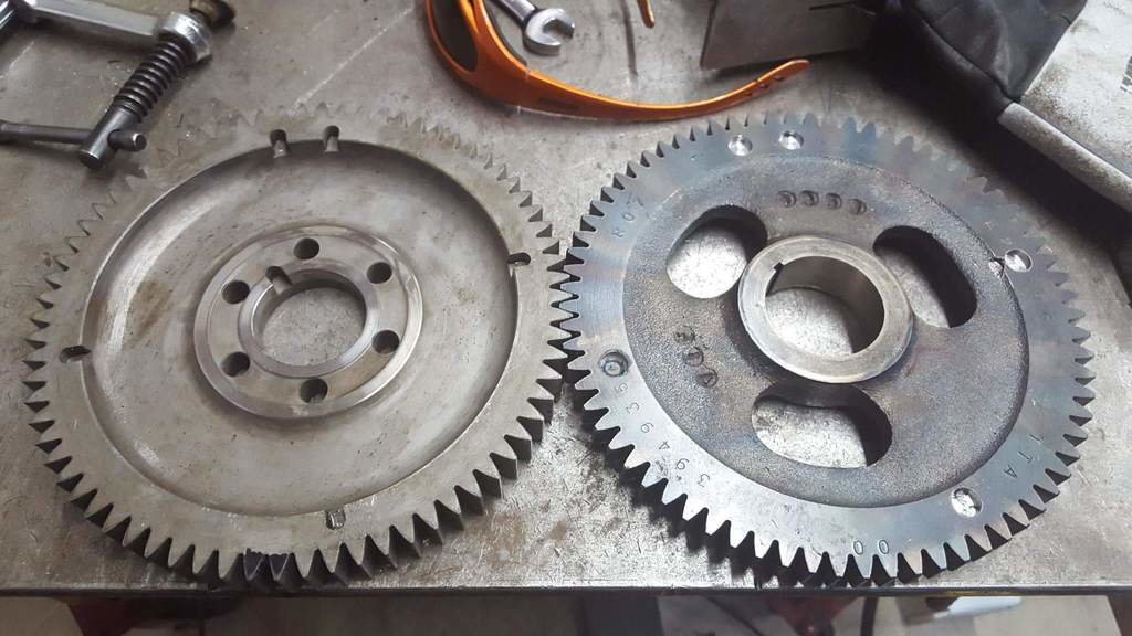

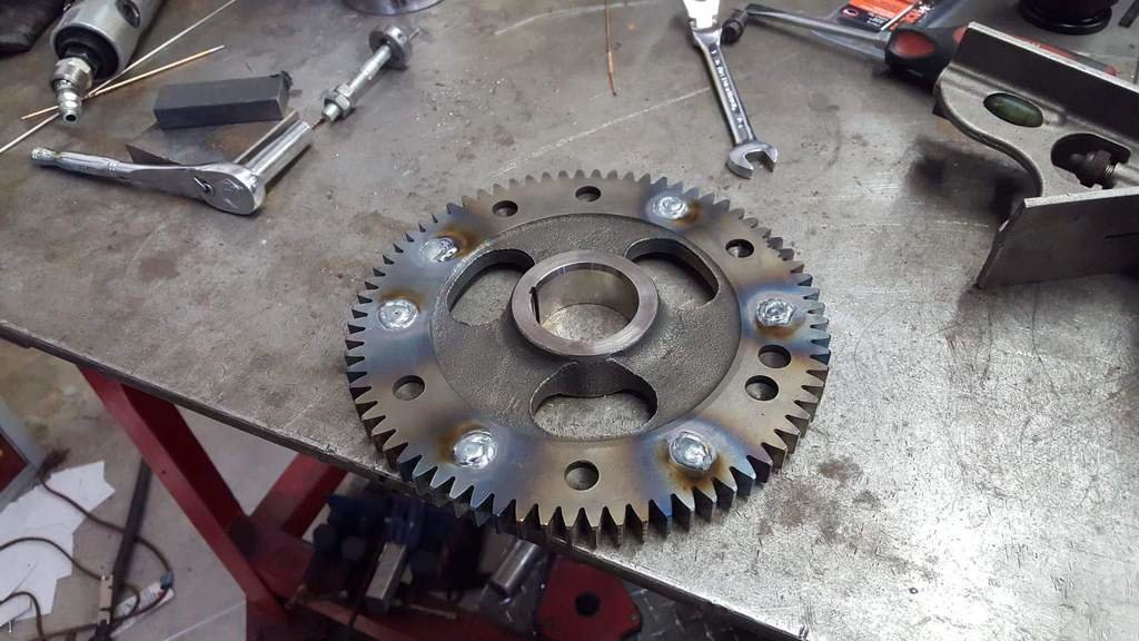

    Well, got some help from my Navy buddy who owns Fouled Anchor Fabrication in Jacksonville Fl. He welded and remachined the Cummins 6.7 gear to match the ISBe3.9 rear gear tones.

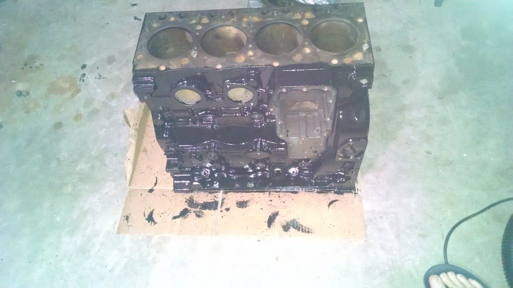

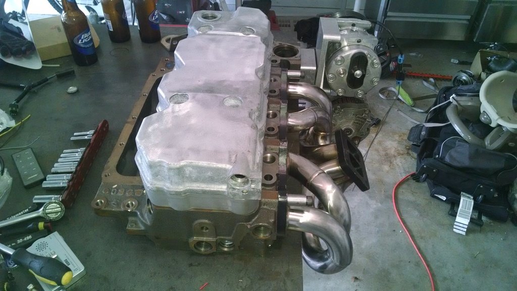

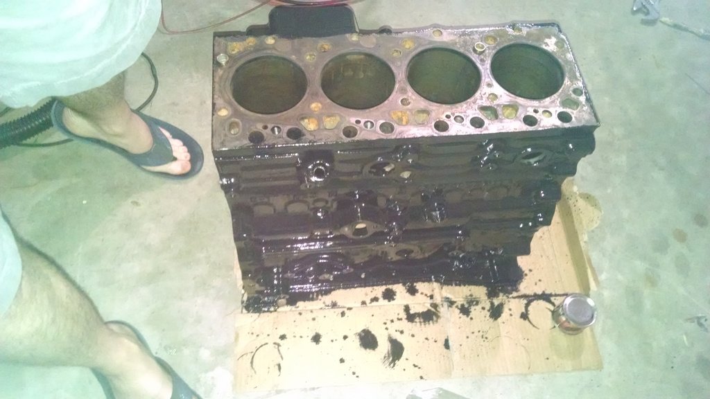

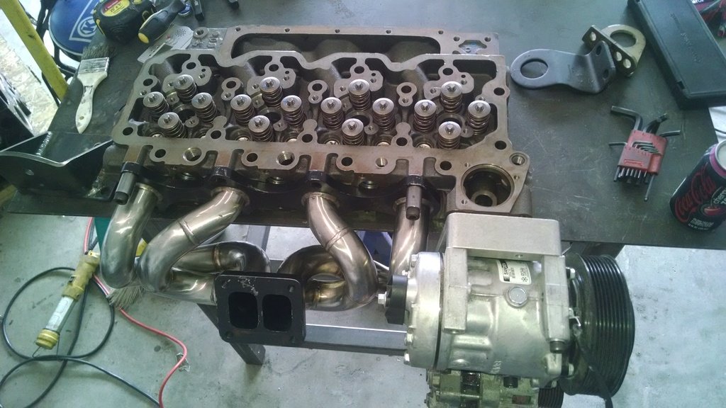

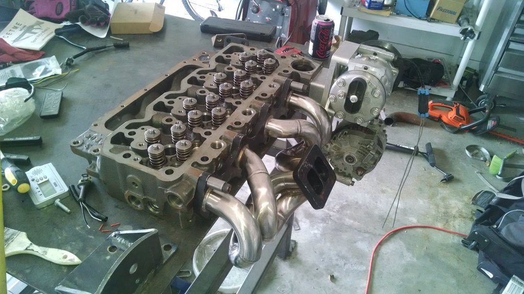

    Well I made a little progress. I built a electrolysis tank using a 24 volt, 60 amp power supply to clean the block, then I used POR 15 Engine Enamel. Turned out pretty nice, I have a few spots I want to sand down and repaint. I also picked up a tuned turbo manifold, which is pretty killer.

    Steed
    Tacoma
    Made some progress, I made a electrolysis tank to clean the engine block then used POR 15 engine enamel to paint it. Turned out pretty good, but I need to sand down some spots and repaint it.
