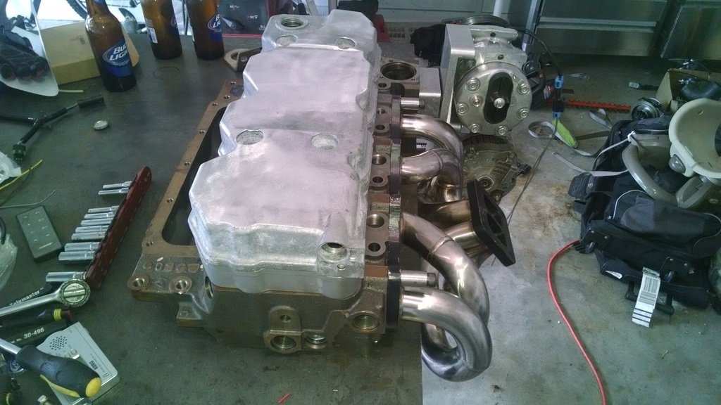

  1. Mar 28, 2016 at 5:29 AM
    #41
    steed
    steed [OP] Well-Known Member
    Feb 3, 2016
    #177003
    48
    Steed
    Tacoma

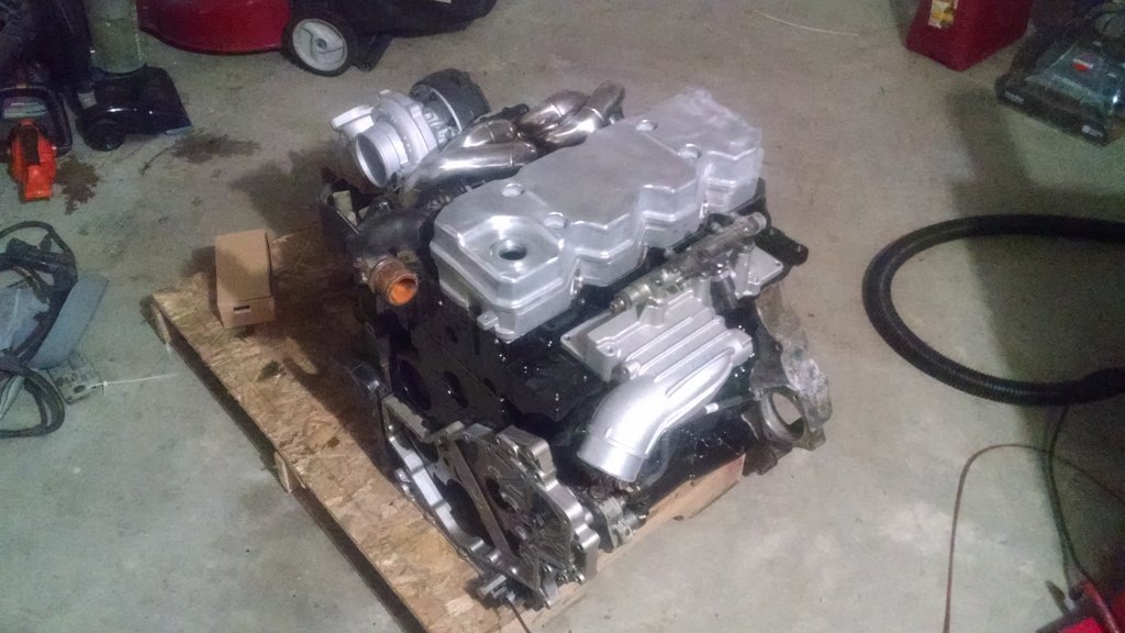

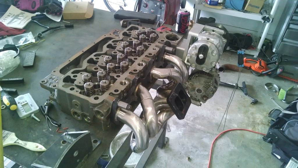

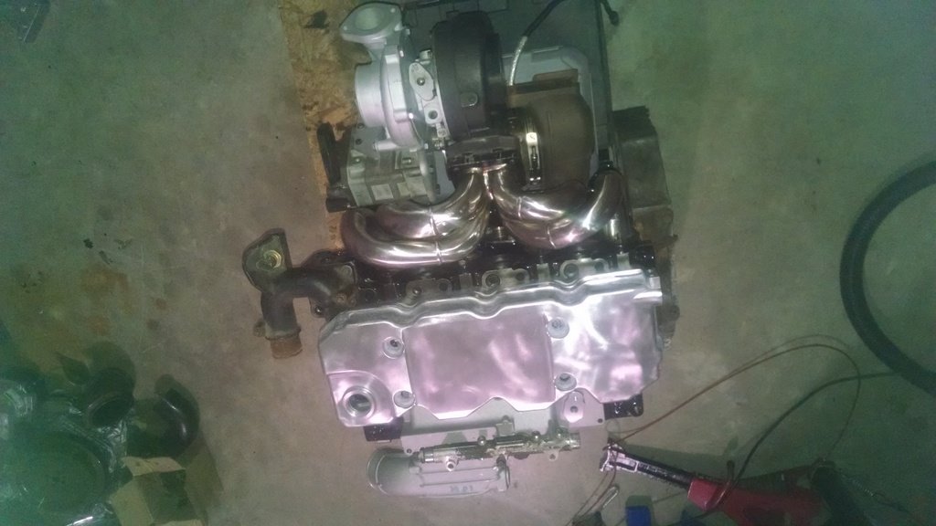

    Also, picked up a BAE turbo manifold. This thing is pretty sweet!
    Sadly my alternator AC bracket isn't going to work with the manifold. So ill need to figure something out.

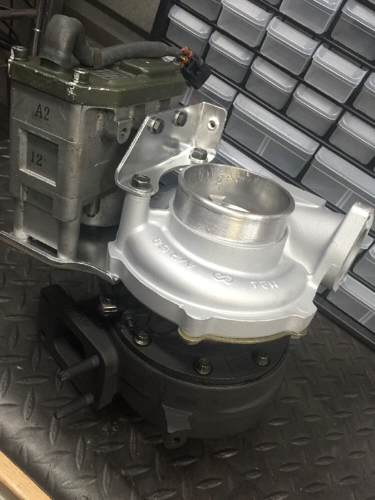

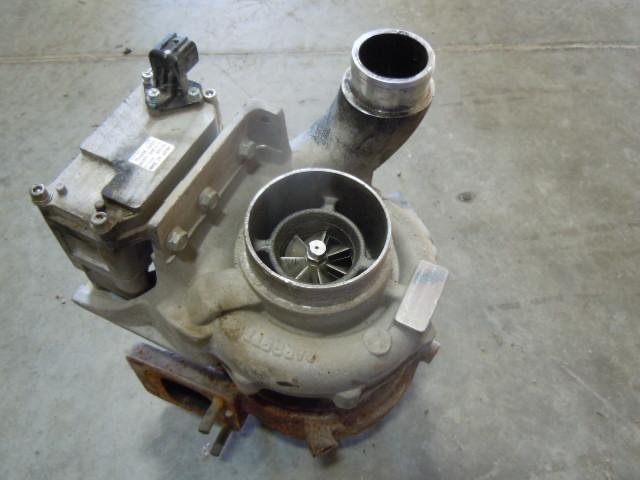

    I decided on compound VGTs, spent the weekend looking HINO trucks and I'm going to use a GT3571KLNV as my high pressure and a GT4082KLNV as my low pressure. The turbo's are pretty close together, I might need to see if I can get a bigger wheel for the GT4082.
    GT3571KLNV
    Wheel Inducer Diameter: 51.2mm
    Wheel Exducer Diameter: 71.0mm
    Turbine Specs:
    Wheel Diameter: 68.0mm
    GT4082KLNV
    -compressor inducer 59mm
    -compressor exducer 82mm
    -turbine exducer 64mm
    -turbine inducer 73mm
    GT3571KLNV
    GTA4082KLNV

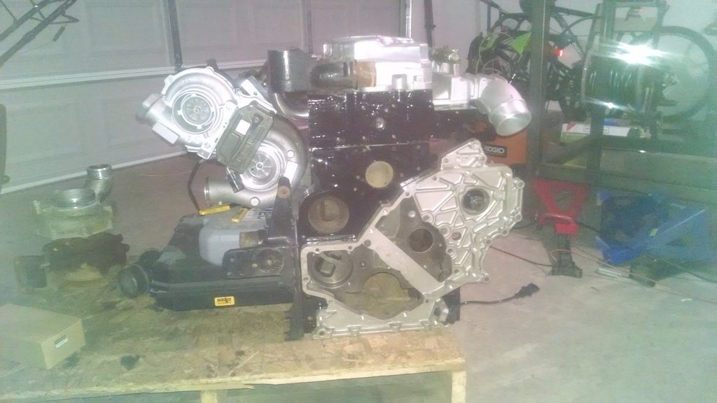

    Tacoma

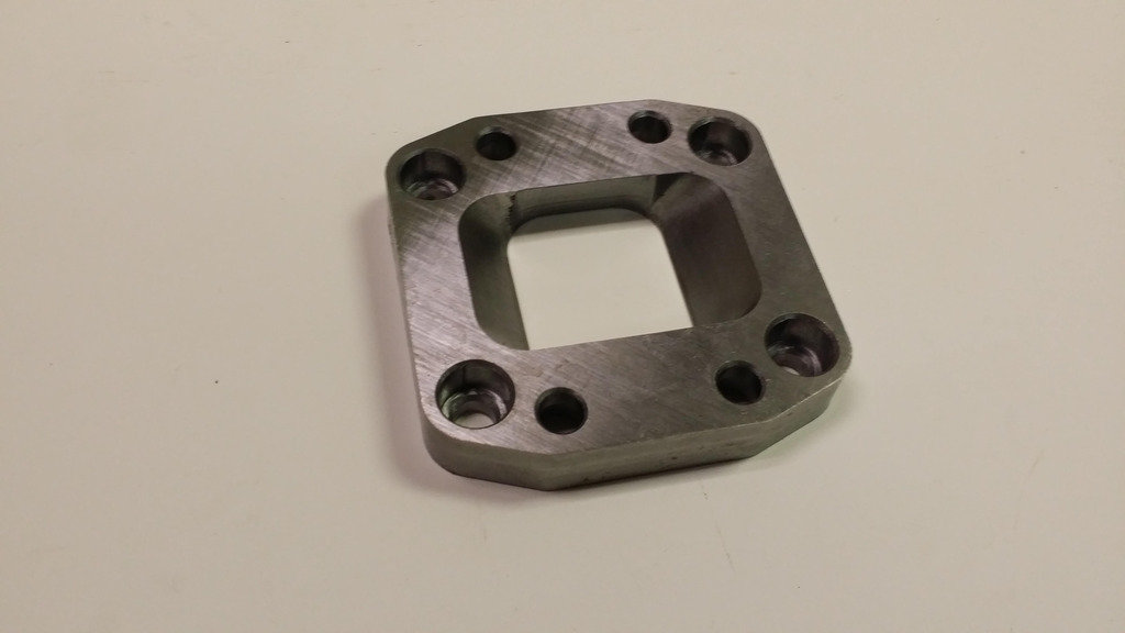

    Making a little progress on the engine, this is a T4 to 90 degree inverted T3, I can also get these in T3 to T3 as well.

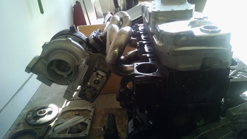

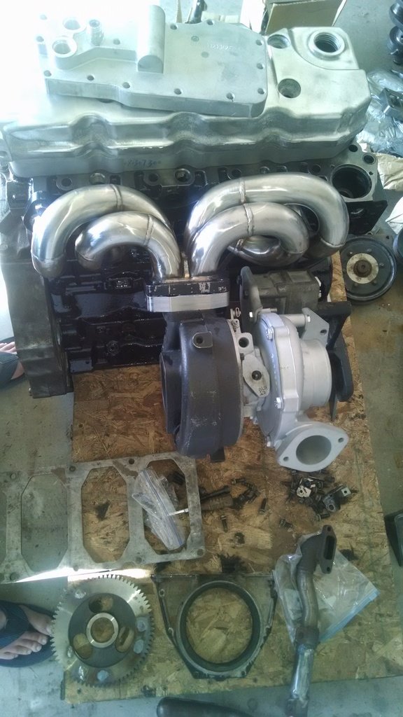

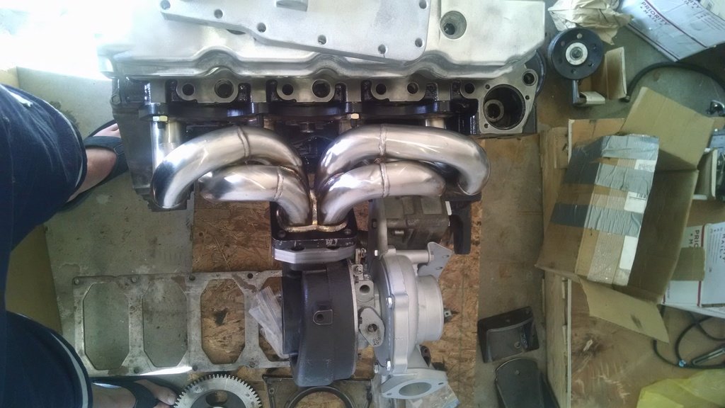

  7. May 12, 2016 at 2:52 PM
    #47
    steed
    Feb 3, 2016
    #177003
    48
    Steed

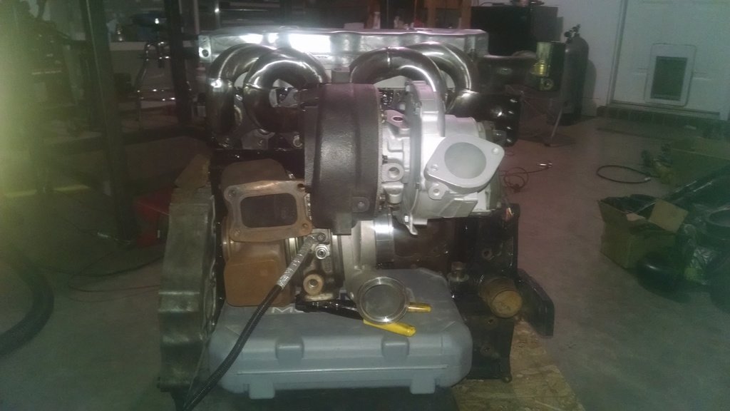

    Tacoma

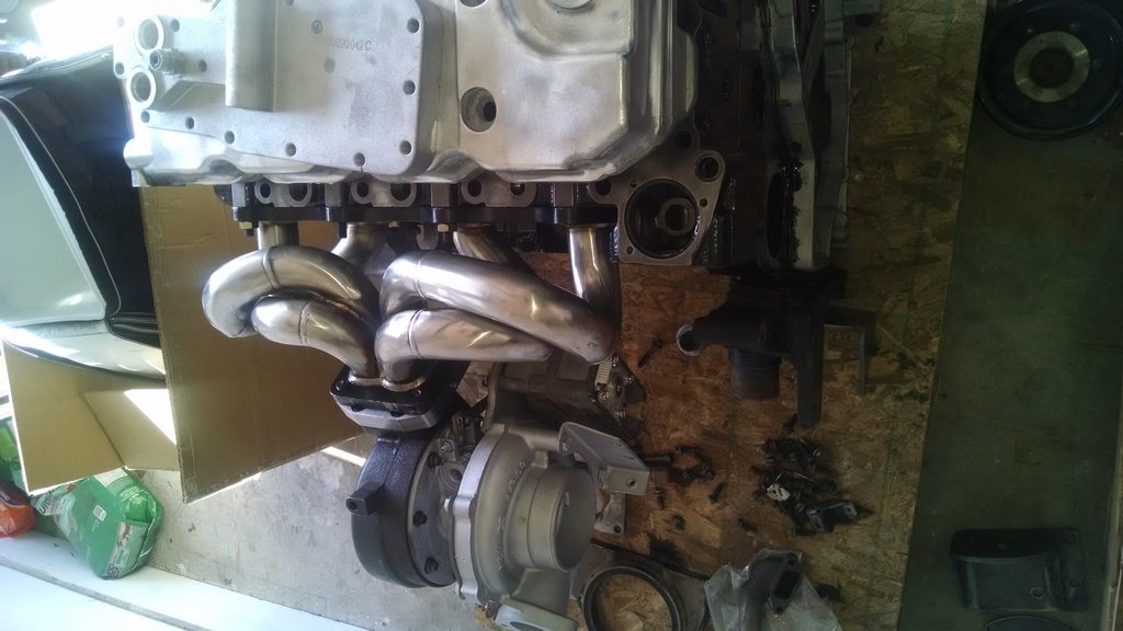

    Still have a lot to do, but I mocked the turbo up.

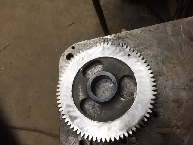

  11. Jun 1, 2016 at 6:07 PM
    #51
    steed
    Feb 3, 2016
    #177003
    48
    Steed
    Tacoma

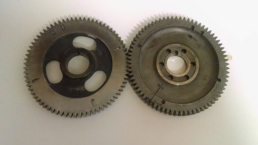

    The cam gear is machined!
