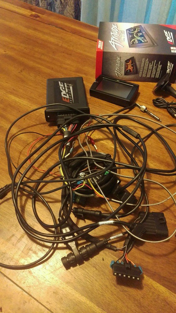

    Well I picked up a Edge Juice w/Attitude for $375 off eBay. Here in a few weeks I'll start bringing the j1939 data to OBD2. Can't wait to get this completed!

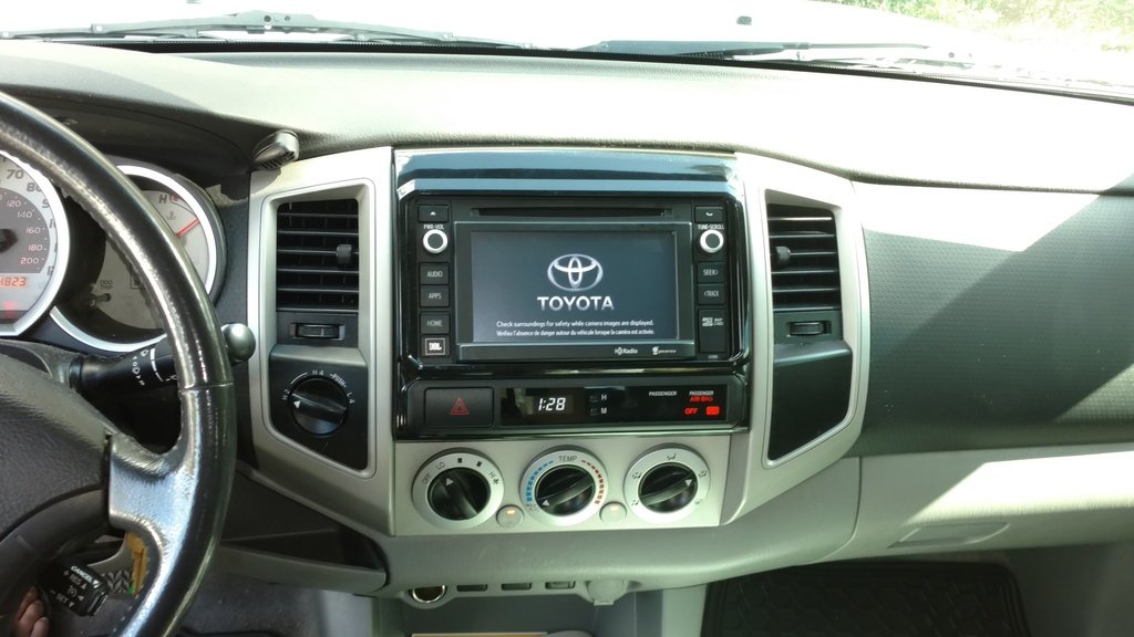

    Well going JBL strong on the stereo.
    Turns out you can't adjust the volume without the amp. Which is interesting, guess all the speakers are preamps and it uses a bus to adjust the volume.
    I bought a amp and sub on eBay for $150. I might experiment with the bus and see if it's entertainment CAN or something proprietary.
    Should look and sound pretty sweet once it's finished.
