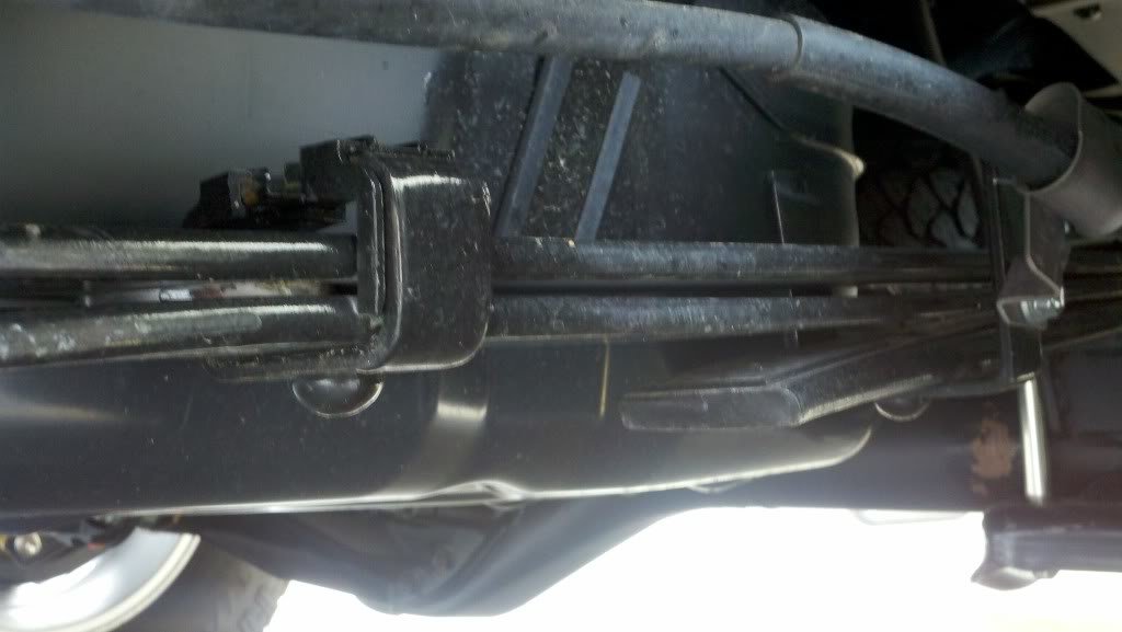

    I just purchased a 2011 and just hauled my first load of wood and thought the same thing. Here is a pic of my leaf springs. I obviously have only three. What did everyone say to the dealer when they called? Does anyone have the TSB Number?

    I called with my issues, then said I was doing some research and found the TSB information. They told me over the phone that they didn't stock the parts and I would have to bring my truck down to be evaluated.
    About 20 minutes into the evaluation they called me and told me that it turned out they had the parts in stock (ordered wrong parts for a 2wd taco that was having the tsb done) so I told them that I wouldn't mind waiting. (Dealership is an hour away and I didn't mind not having to come down again).
    Took about 3 hours or so (I think), picked it up, truck all better.
