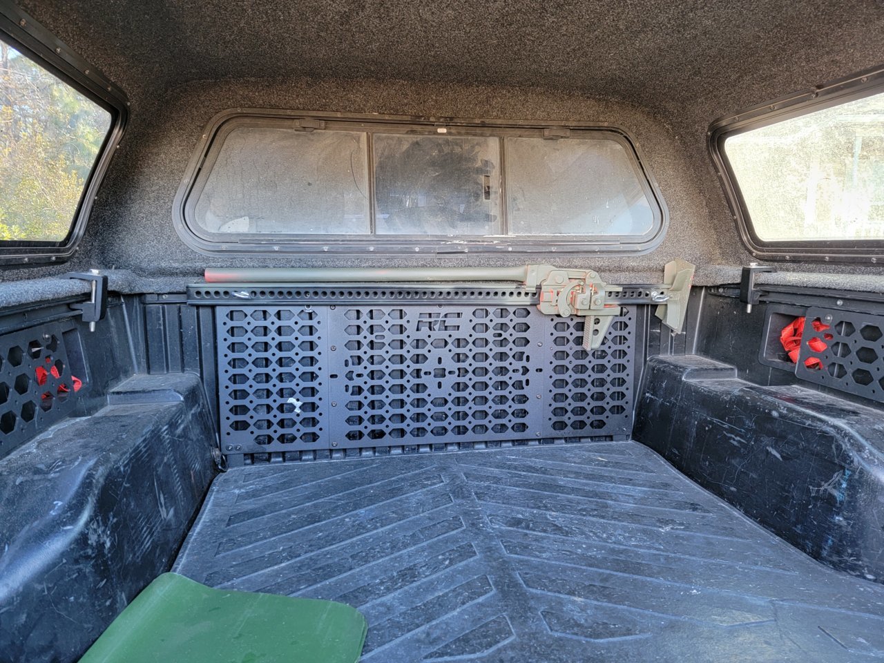

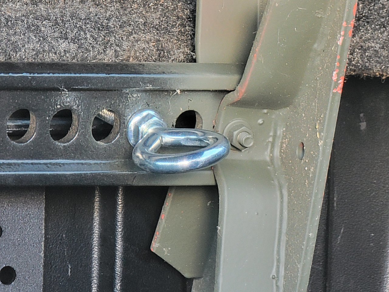

    Mounted my Hi-Lift Farm Jack using some T-Nuts and 3/8 Eye Bolts and washer nuts
    The T-Nuts that I bought aren't in stock but these should do the trick if anyone wanted to do the same thing just verify your thread size:

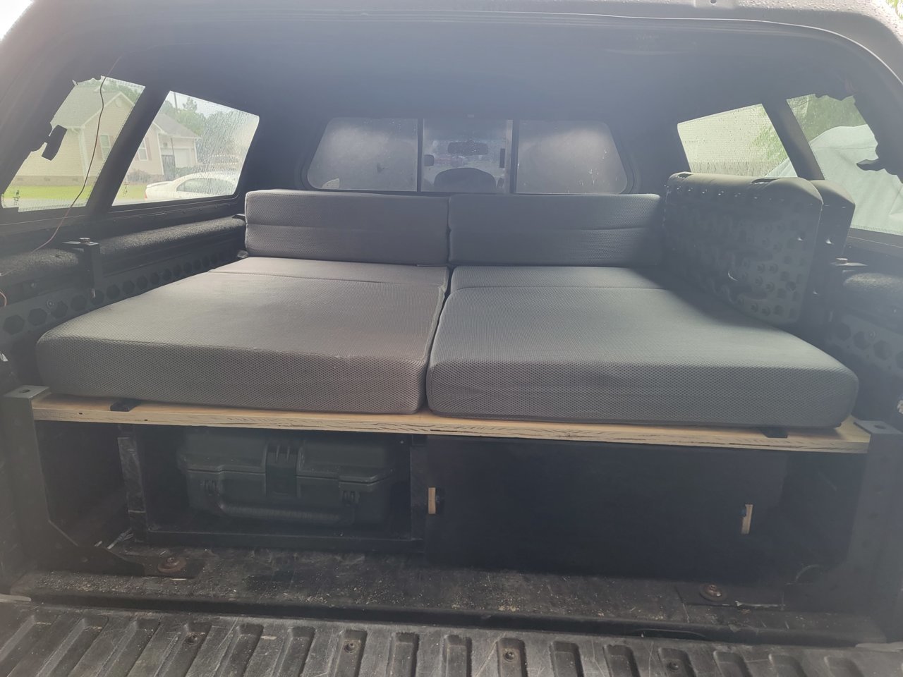

    Lastly, the fold up Mattresses came in!
    The plan is to fold back one of the 12.5" sections as a pillow. They are both 25" wide so they will fit perfectly snug on top of my flush deck that I'm building in a few weeks

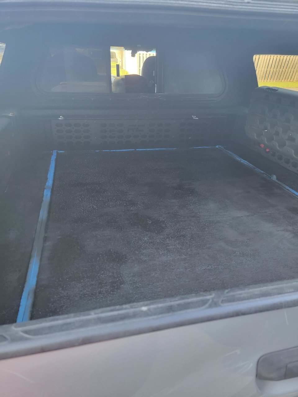

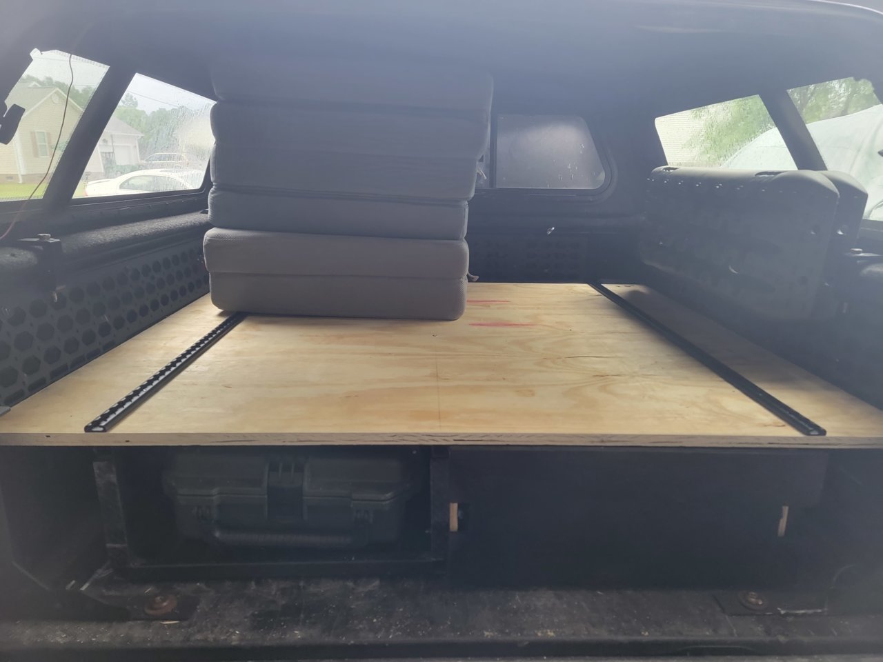

    Further development on my track/bed system. More eye bolts with track nuts. Spaced the camper clamps perfectly to be able to wedge the first board in without screws, that way that tension keeps me from fighting the initial boards line up. Then I routed an old woodland sustainment pouch on the RC Molle platform. Im gonna hold off on any more pouches/mounting until I have my deck system constructed completely. I ordered some rails for the deck to attach slidable tie down anchors. I have all the materials. Its just waiting until my pops can come down with his welder and a weekend free of work obligations.

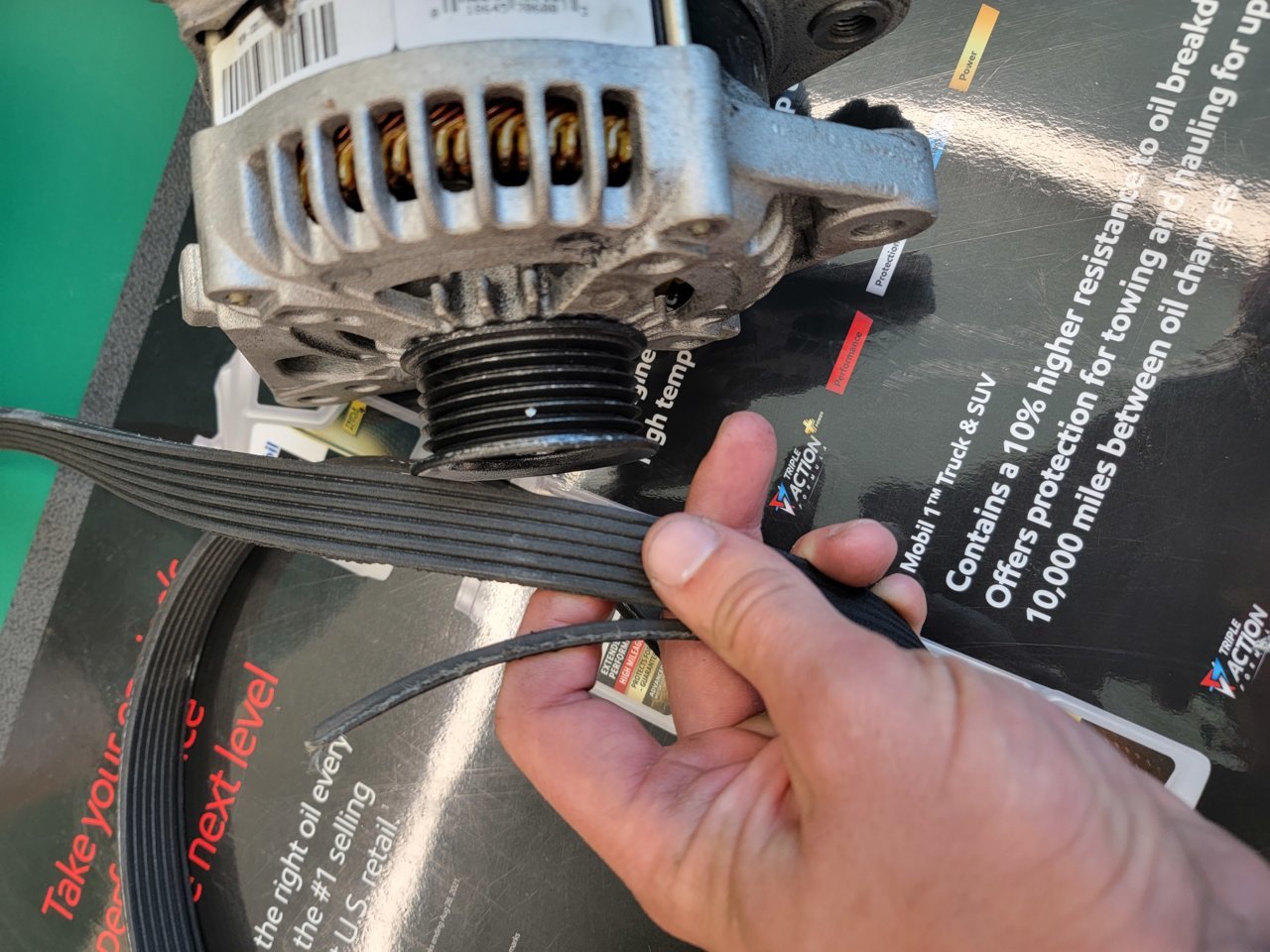

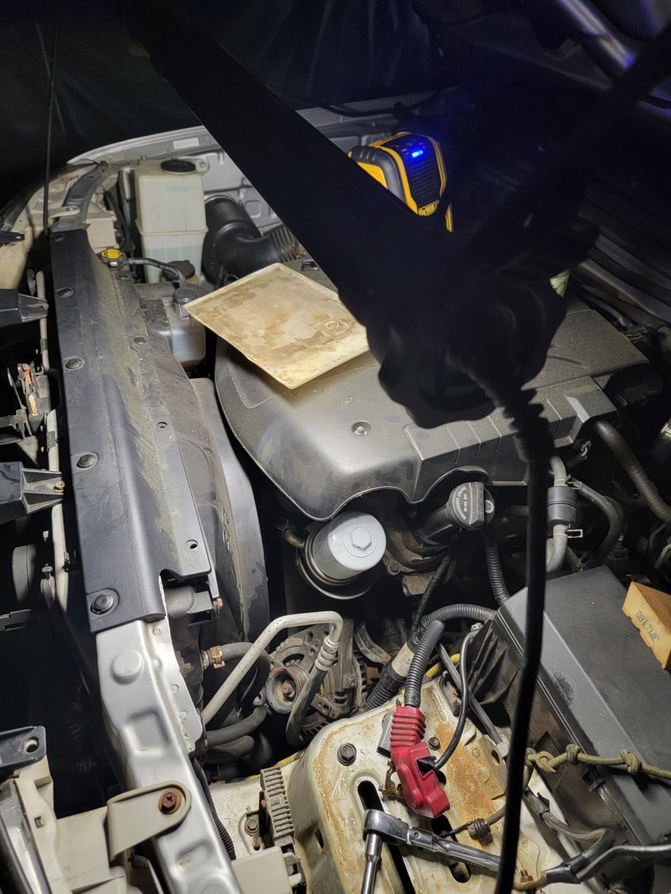

    So since the last post I had my alternator die, at first I thought it was the crappy NAPA battery, so I bit the bullet and upgraded to an Optima Yellow Topper to help with the winch. Got the alternator off myself and found out that O'Reillys did me a solid and gave me the wrong one....the plugs that we have on 2nd gens are quad prongs versus the double pronged alt they gave me. Oh well, it was a satisfying maintenance op.....going to hit them up in the morning and then also swap my serpentine while I have my tensioner pulley loose.
    IvanhoeTaco likes this.
  7. Jun 11, 2022 at 11:56 AM
    #27
    Danny72
    Danny72 [OP] Well-Known Member
    Apr 23, 2019
    #291040
    381
    Wilmington, NC Area
    2011 DCSB 4x4 TRD Taco
    35x12.5r18s RC 6" Lift w/resies, Camburg UCAs, 3rd Gen Leafs, Brute Force Fab Front Bumper, HC Coastal Offroad Rear Bumper w/Swing-Out
    Watch the grooves on your non OEM parts....manufacturer error on this guy they gave me one with 6 grooves when ours need 7. Taco is up and running nicely now!

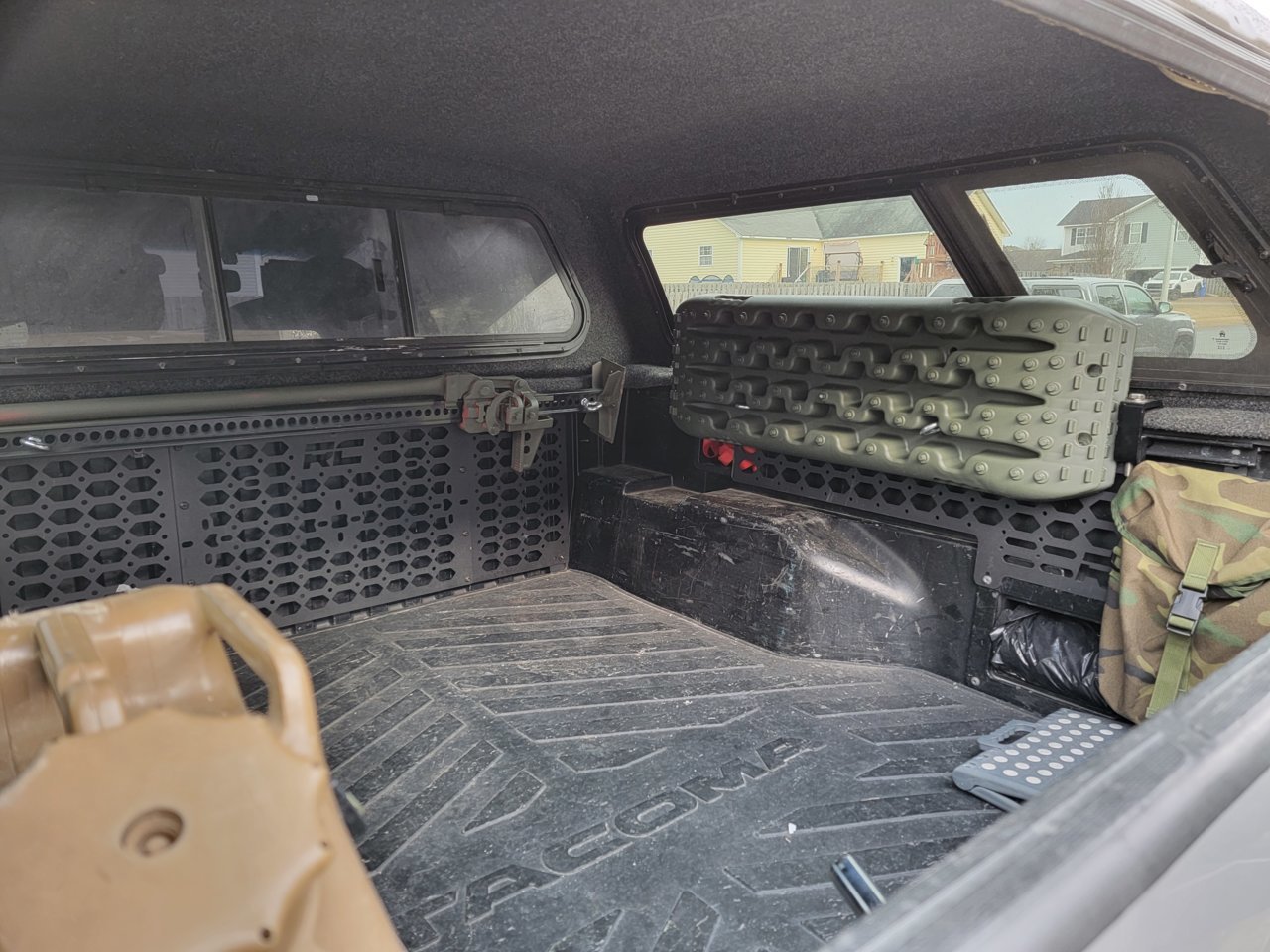

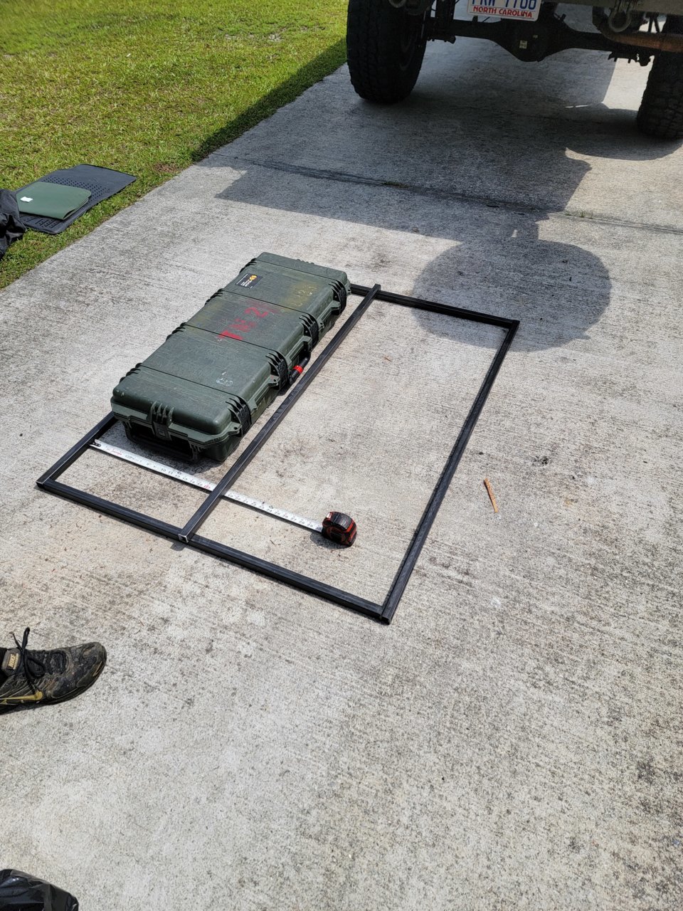

    And so the bed deck project begins

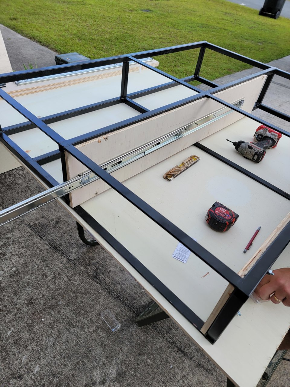

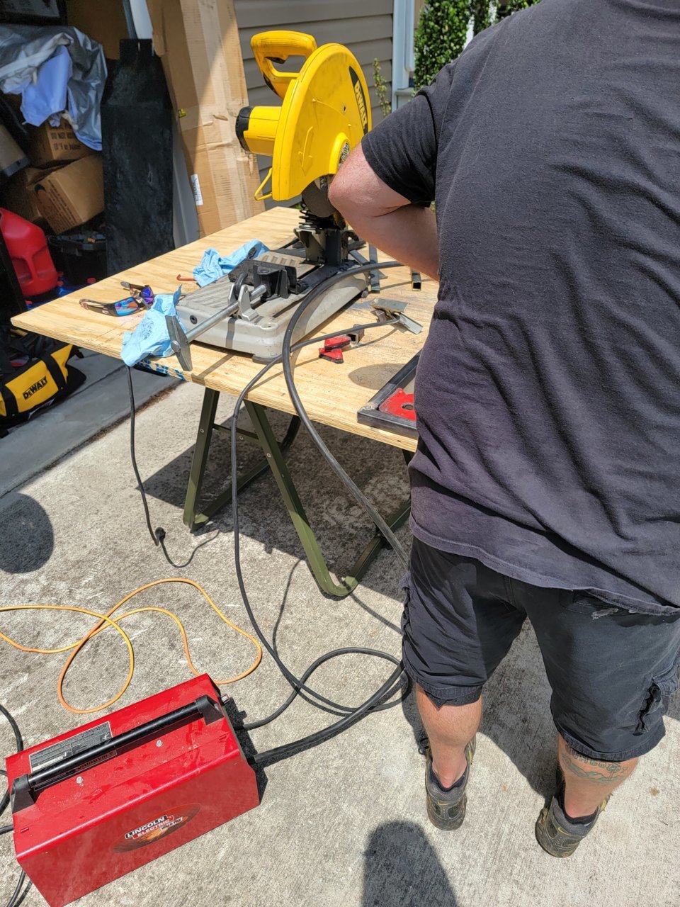

    Started with the frame
  10. Jun 12, 2022 at 12:20 PM
    #30
    Danny72
    Apr 23, 2019
    #291040
    381
    Wilmington, NC Area

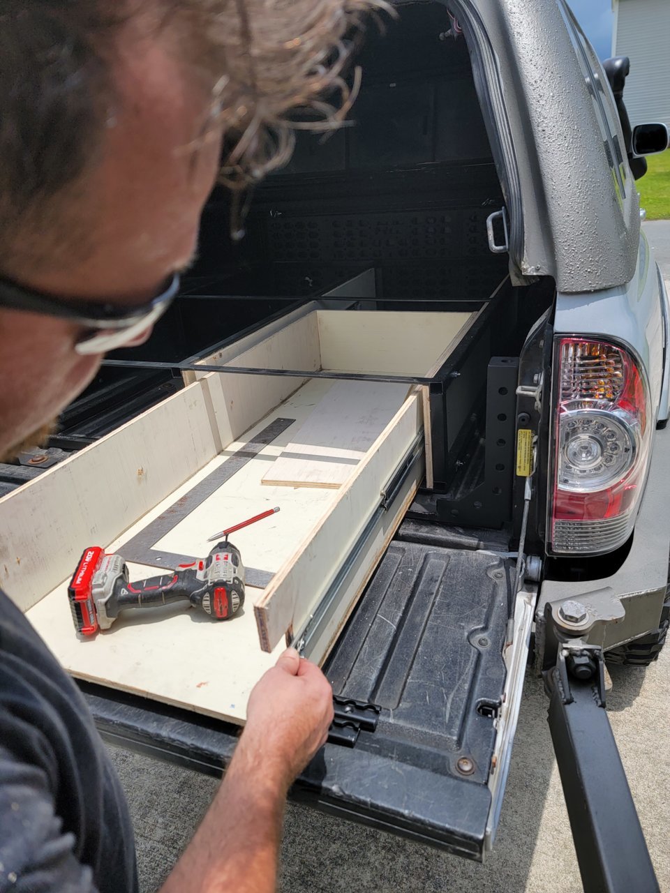

    Then the drawer and cubby
    Then the platform itself
    All in all about $450 and 12hrs of work with my pops
    Then used herculiner to seal the base board up

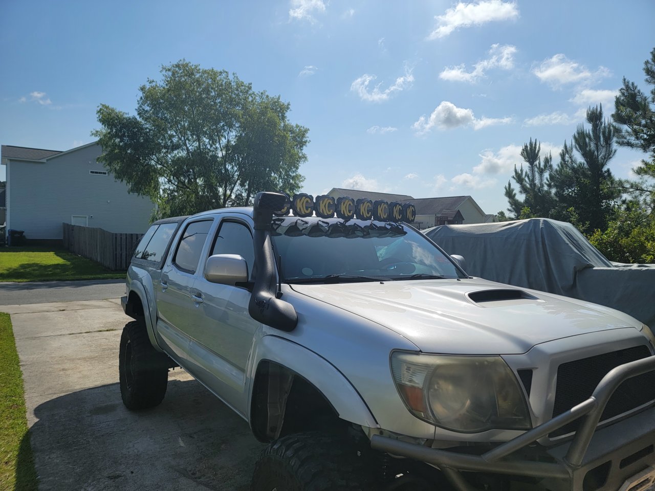

    And it was on this day that @IvanhoeTaco blessed the Razor Crest! He sold me this cherry 8x KC Pro6 Gravity Light Bar.
    For anyone looking to figure out the mounting hardware, it is metric M6-1.00x16 screws that work best

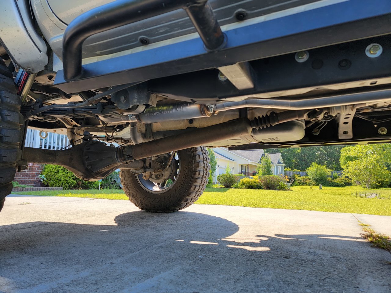

    Finally put my sliders on, deleted my OEM exhaust, and slapped on my Flowmaster FX Cat Back Exhaust.....damn good day for the Razor Crest

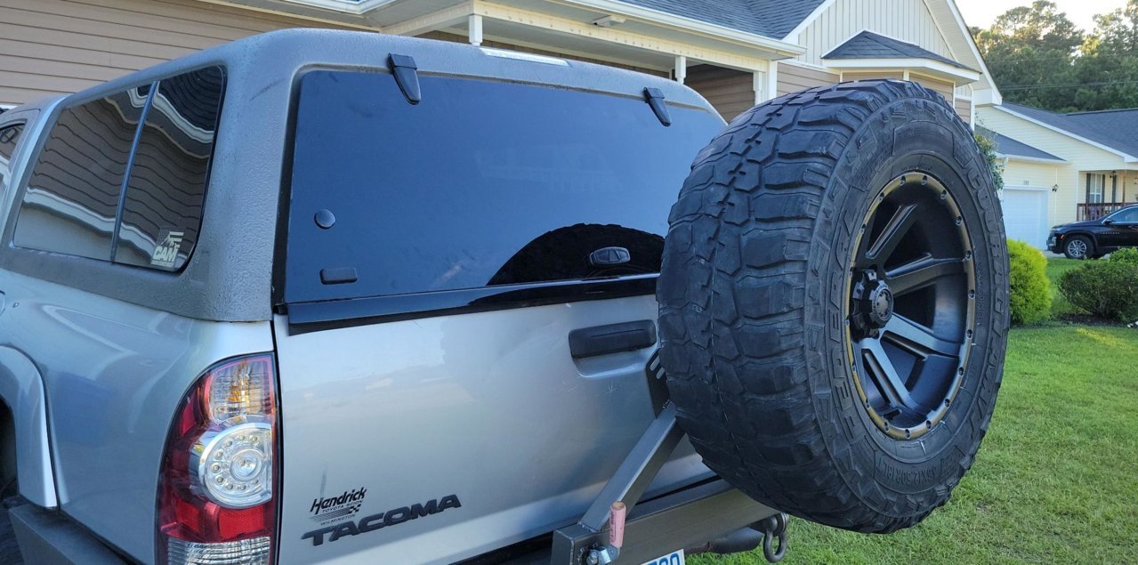

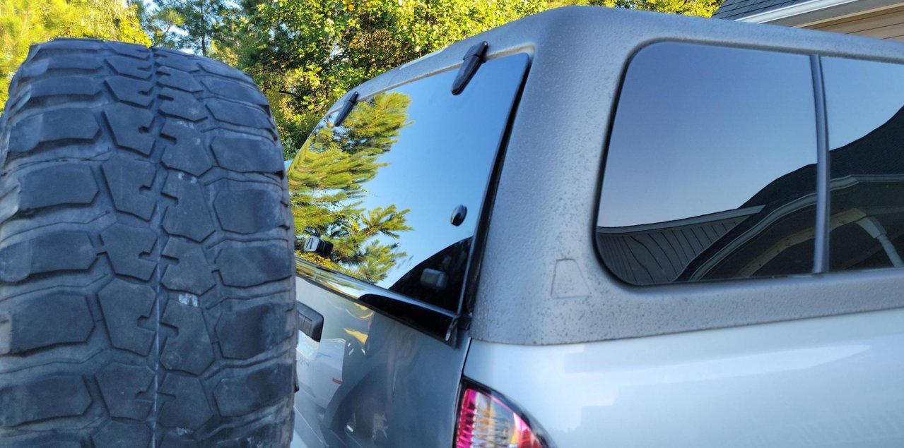

    Then I placed the order yesterday for my back glass for the camper
  16. Sep 17, 2022 at 6:39 AM
    #36
    Danny72
    Apr 23, 2019
    #291040
    381
    Wilmington, NC Area
    Currently Deployed but the wife took the truck in to have its back glass replaced, came out great!....expensive though!

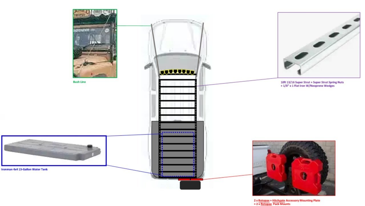

    Just a few DIY ideas on "the drawing board"
    Top Left: Brush Wire inspired by thr Camel Trophy Trucks.....limbs smacking the windshield are a real thing in the Carolina Woods...replaced glass as a kid...never again do I want to do that!
    Top Right: My SuperStrut obsession...came from the pics of my black tacoma when I made my own bedrails using Strut, Super Strut Spring Nuts, and drilling out Tacoma Camper Shell Clamps to keep everything torqued down. Plan is to get 13/16" Strut and use that down the roofs seal lines and bolt directly into the OEM roof rack holes. Bottom Left is a water tank (Whole reason for the rack project) Then Bottom Right will be my DIY plan for fuel mounts to keep Gas "outside of the hotel room"
