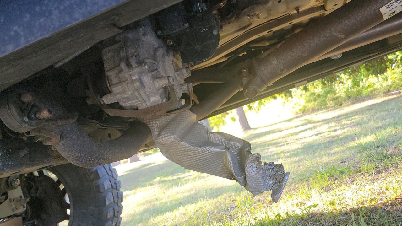

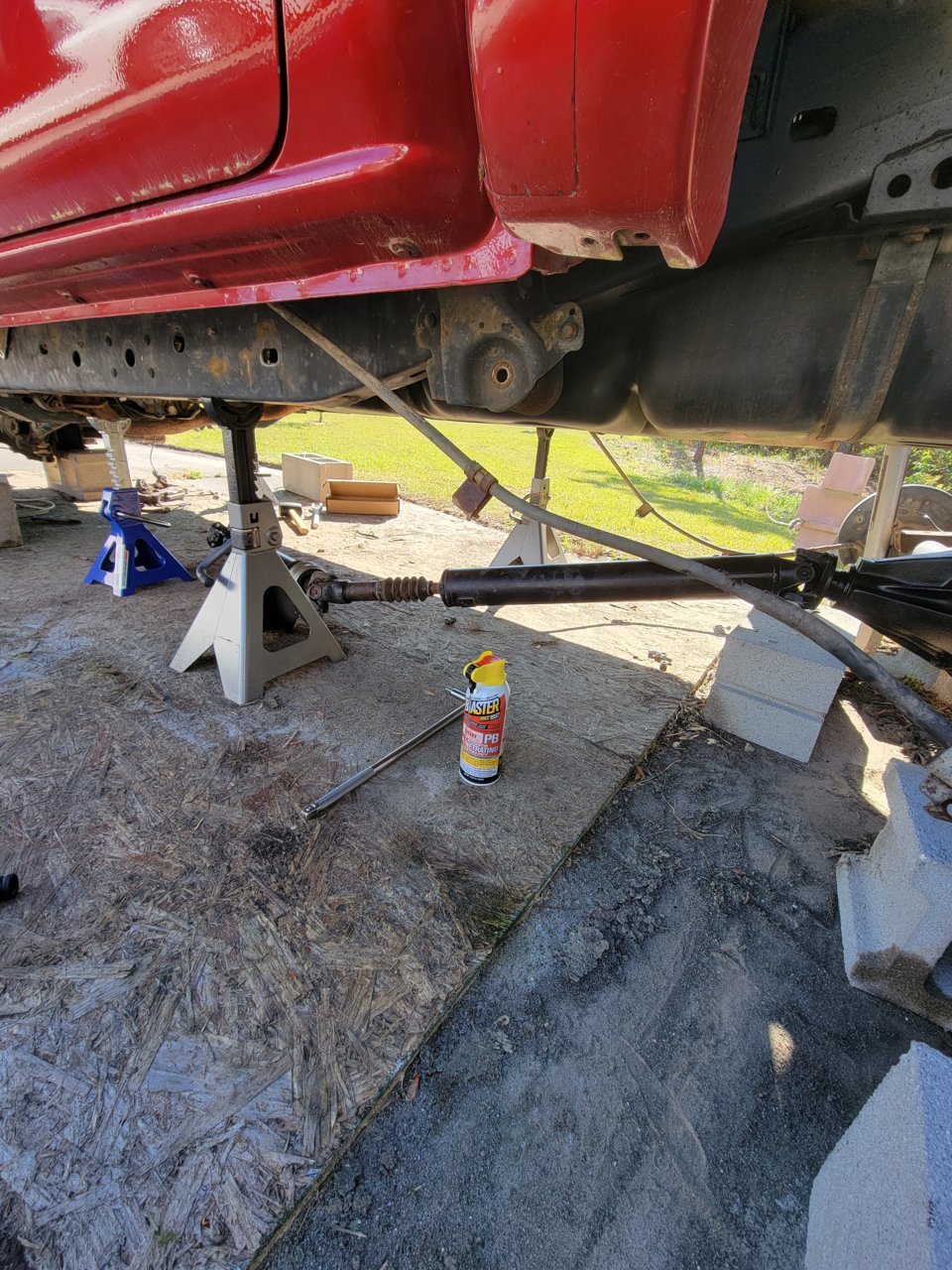

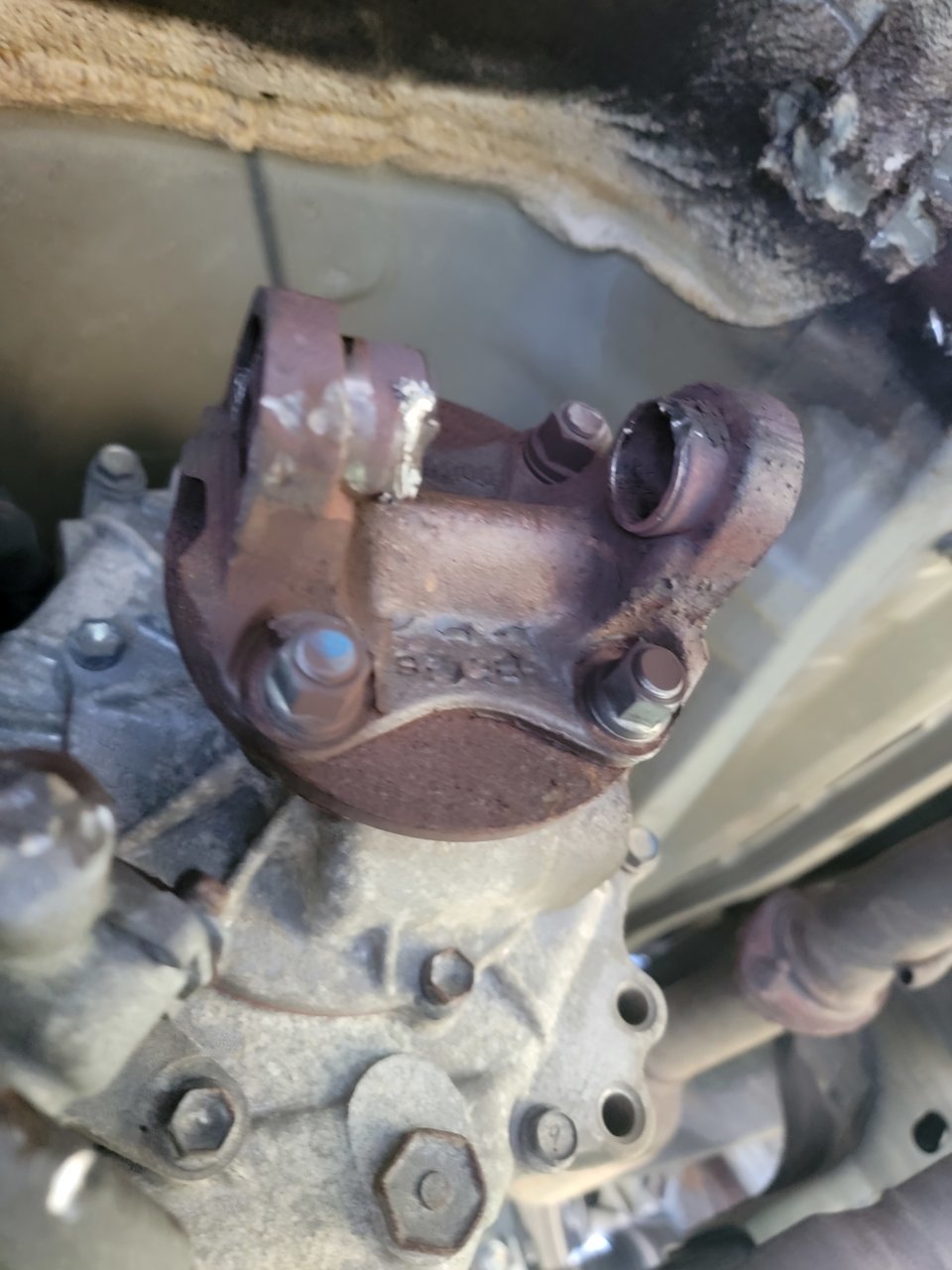

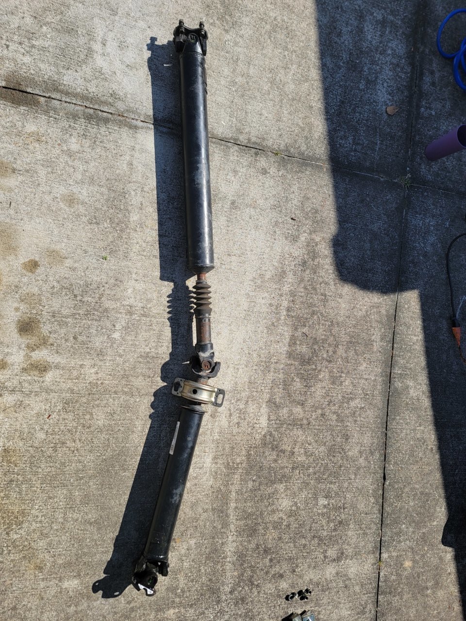

    About a month back I was headed into work when a u-joint failed and my rear drive shaft dislodged. Got hit with an initial estimate of $867.....but luckily no one pulled the trigger on my old red truck so I pulled the drive shaft from the parts truck and saved $740! Buying back that truck pays off yet again!
    PB Blaster FTW!
    This had been the first time I really did any significant wrenching since getting back from deployment becuase of a Jiu Jitsu warpath/fighting internationally in London and Italy....and what does that naturally do?...Sparks the fire again haha

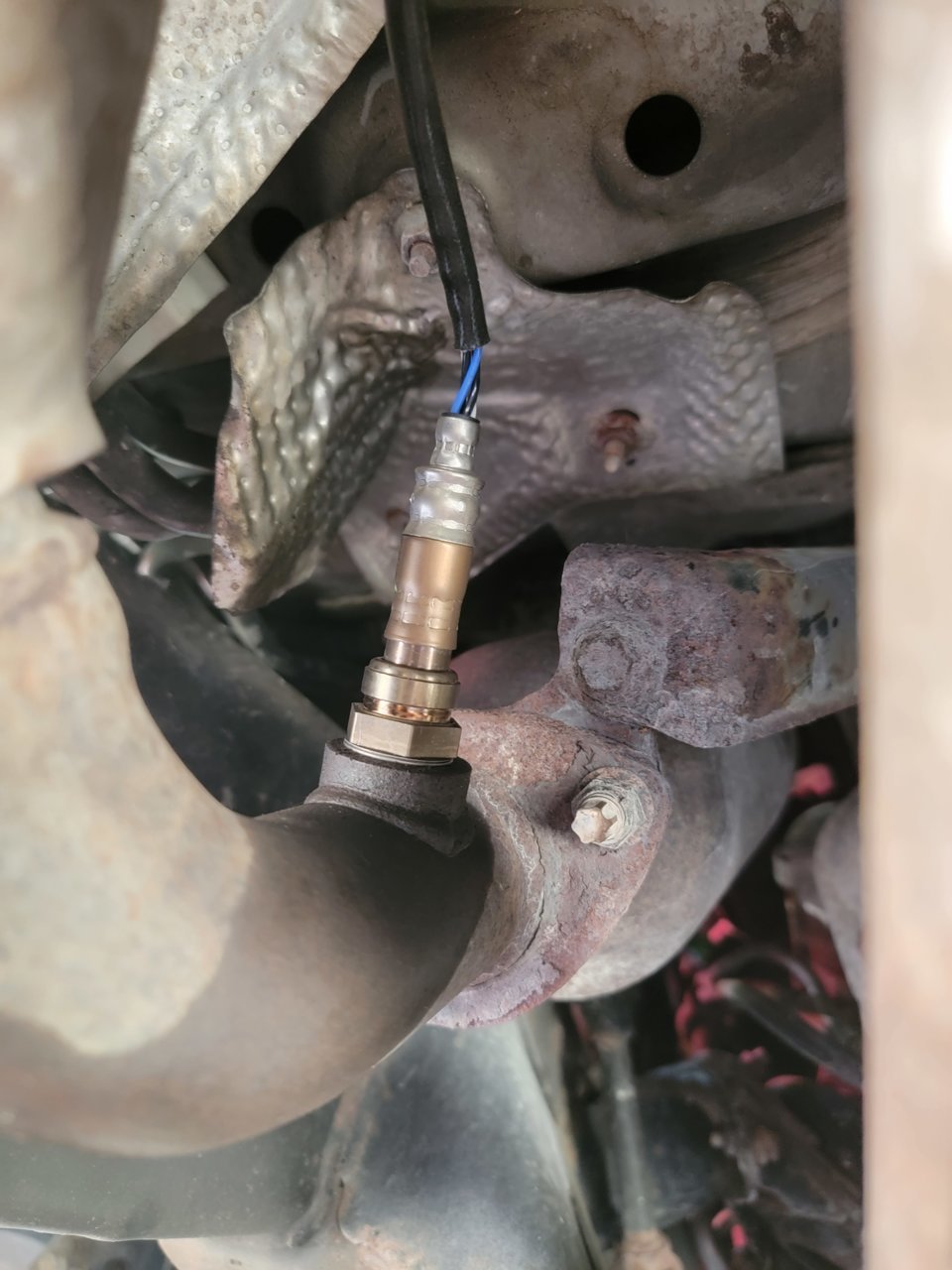

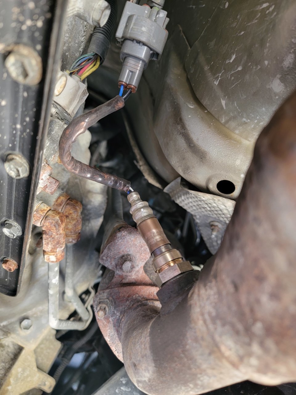

    The infamous P0430 / P0420 codes decided to pay me a visit. Bought a code reader (A must...kinda ashamed I went this long without one).
    Did some research and found out that the 02 sensors by the Cats can be:
    Denso 234-4260 (Passenger side)
    Denso 234-4261 (Drivers side)
    $48 Denso 234-4260 Oxygen Sensor
    http://www.amazon.com/gp/product/B00199FBQY?redirect=true
    $52 Denso 234-4261 Oxygen Sensor with 4-Wire 10” Harness for Lexus/Toyota V-6 Downstream Left/Front
    http://www.amazon.com/gp/product/B0016NBBQW?redirect=true
    I went as far as using cat clean
    https://www.amazon.com/gp/aw/d/B07N7RZ5ZV?ref=ppx_pop_mob_b_asin_title
    For the record you can do this job with just a 23mm wrench if you disconnect the sensors and run the closed end around the wire. I bought the special socket and becuase of the tight space only used it for ease of reinstallation really fast. Job took 20mins...90% was trying to losen the corroded sensors.
    Sources:
    https://www.tacomaworld.com/threads...tem-efficiency-below-threshold-bank-2.391165/
    UPDATE: It was the driver side cat converter

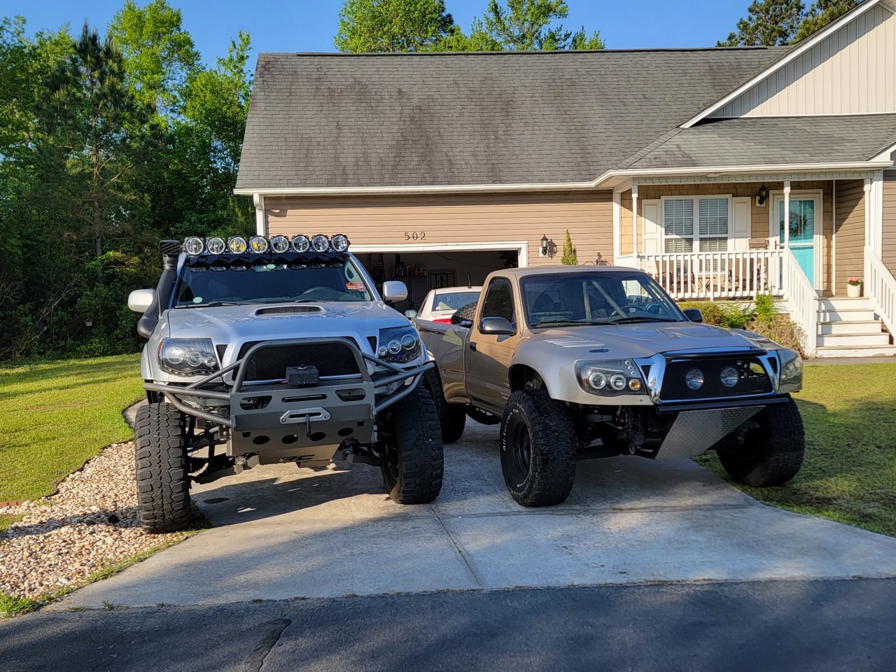

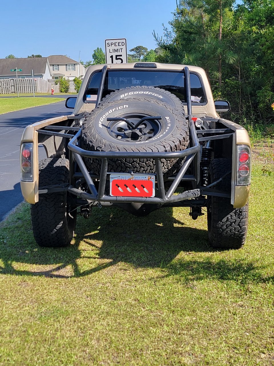

    Side note: Bought a 3rd Tacoma....lil '03 single cab prerunner that's longtraveled out. Details to follow BUT this allows the 2011 to take breathers/less mileage, get actual maintenance done, and not have me puzeee-footin around on trails in fear of hurting my DD.
    A LOT has happened. Re-negged my life decisions on the red truck wanted to restore it lost hope wanted to sell it, no one wanted to deal with it for the asking price, so NOW I'm dropping the Diffs out that have ARB airlockers...putting those in the '11 Razor Crest, regearing to 5.29 after this recent adventure to Uwharrie I've also decided that the supercharger will stay and eventually get slapped in the truck......screw it man! Can't get the price/smoothness of a transaction that I want and I can afford it.
    That sets conditions to swap the current 4.0 V6 that is in the '11 Razor Crest right now and slap that into the '03 Long Traveled yote
    (Been meaning to blog this for a while haha)

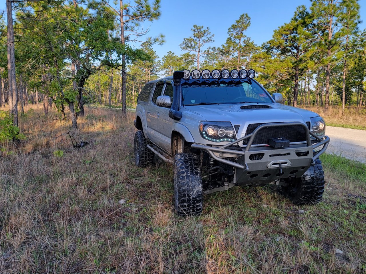

    Uwharrie Trip May 2023
    It was a blast, only casualties were my CV axle boots. Already ordered the All Pro Long Travel boots.
    Everything went grate, we camped out, I used the bed set up, Sliders kept the cab from scraping, the thousands I've invested in recovery equipment all paid for itself when we had to help a Suzuki Samauri

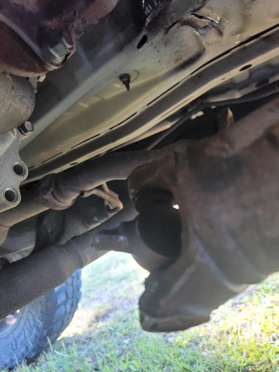

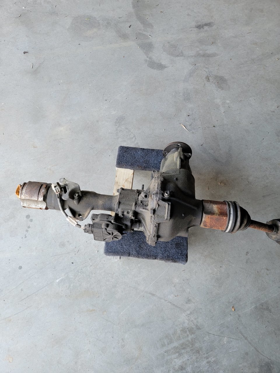

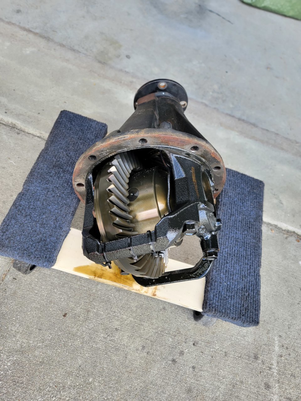

    Rear Diff and Locker is out of the red truck.....1/2 to getting the from Diff dropped then its all getting sent off to ECGS for 5.29s!

    Front diff/ARB locker is out. Taking them to Low Range to ship off to ECGS
