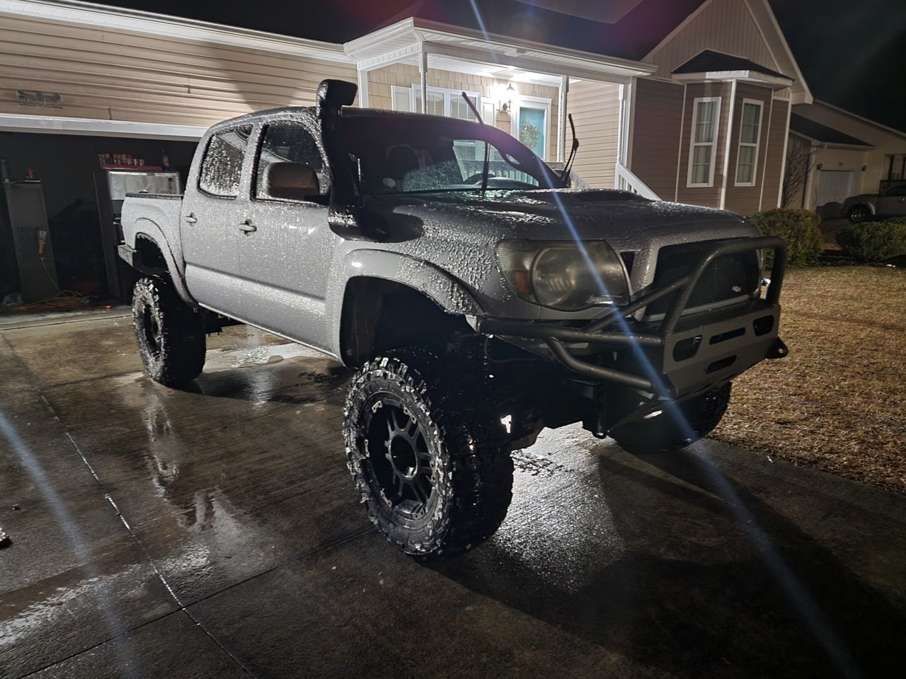

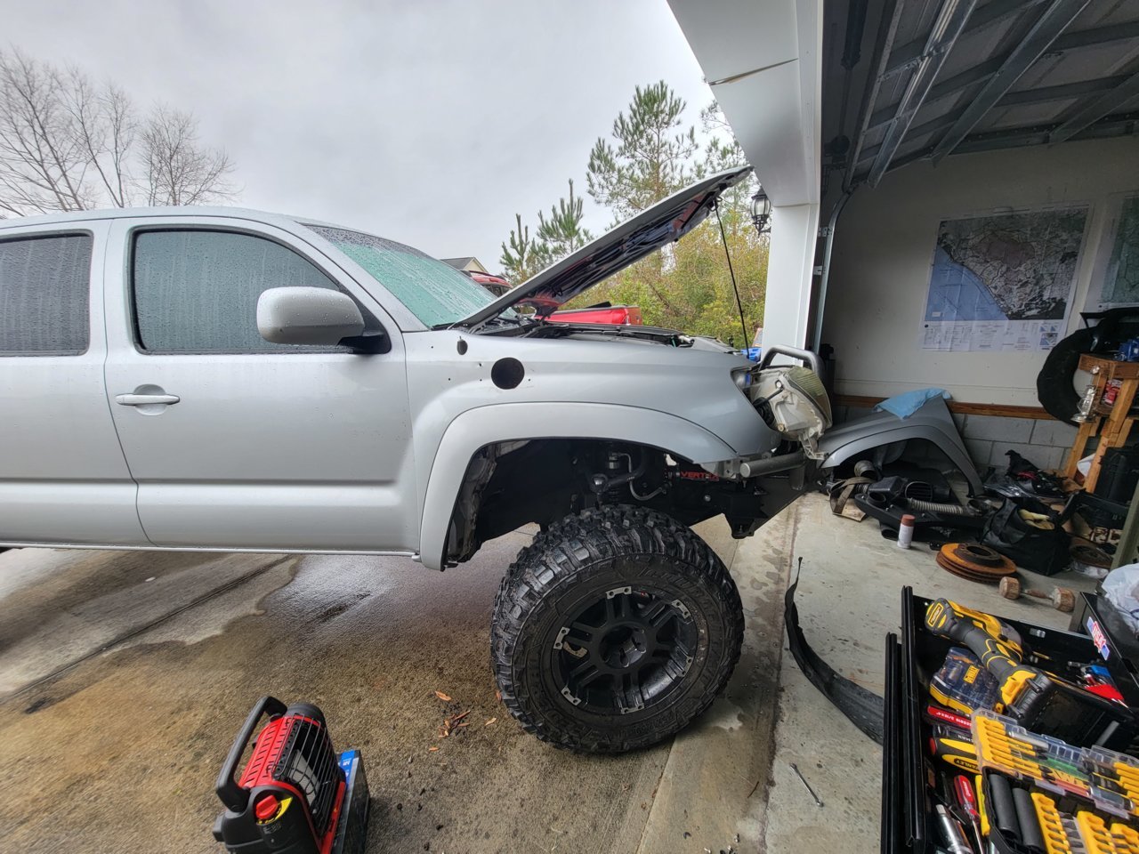

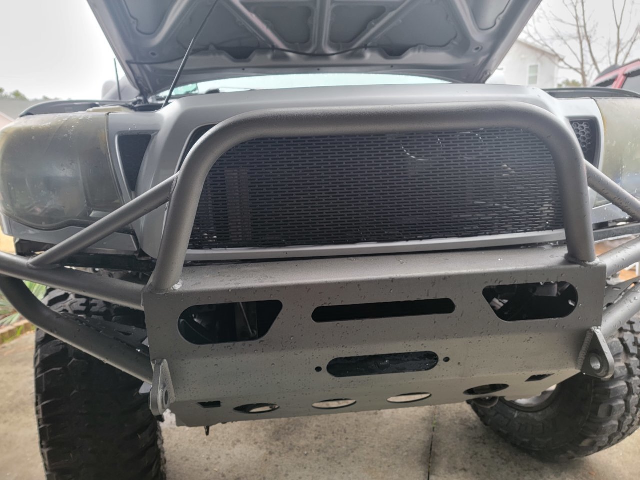

    Got my snorkel and gutted Fenders from
    @IvahoeTaco bolted on
    Maritime Optima Battery
    Raptor Mesh Grille
    Rain-X Wipers

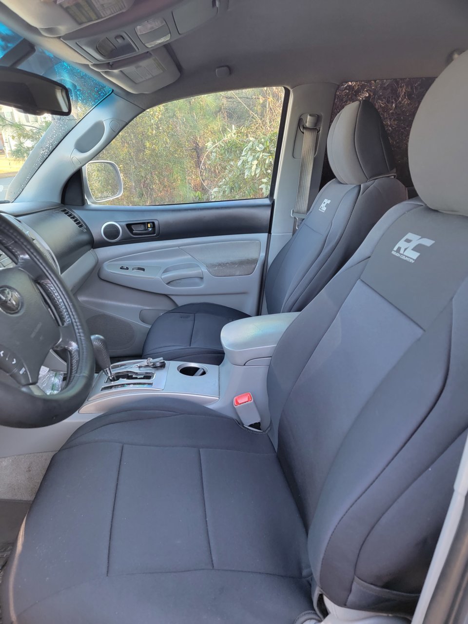

    Got my third gen RC seat covers installed. They fit AMAZINGLY! Highly-highly recommend them!
    Also plugged in the pedal commander and am very impressed, it is the way to go if you are running 35s like I am, reminds me of reds super charger when it comes to response. I can't imagine how it'll rip once I get my SC put in

    I'm looking at the 3rd Gen RC seat covers for my 2012. Any issues fitting these on 2nd Gen seats?
    Danny72[QUOTED][OP] likes this.

    Fit perfectly man

    Thanks, this looks like a good deal for seat covers

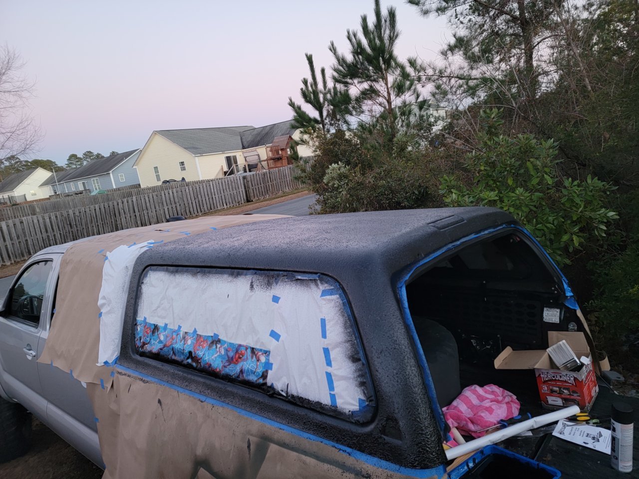

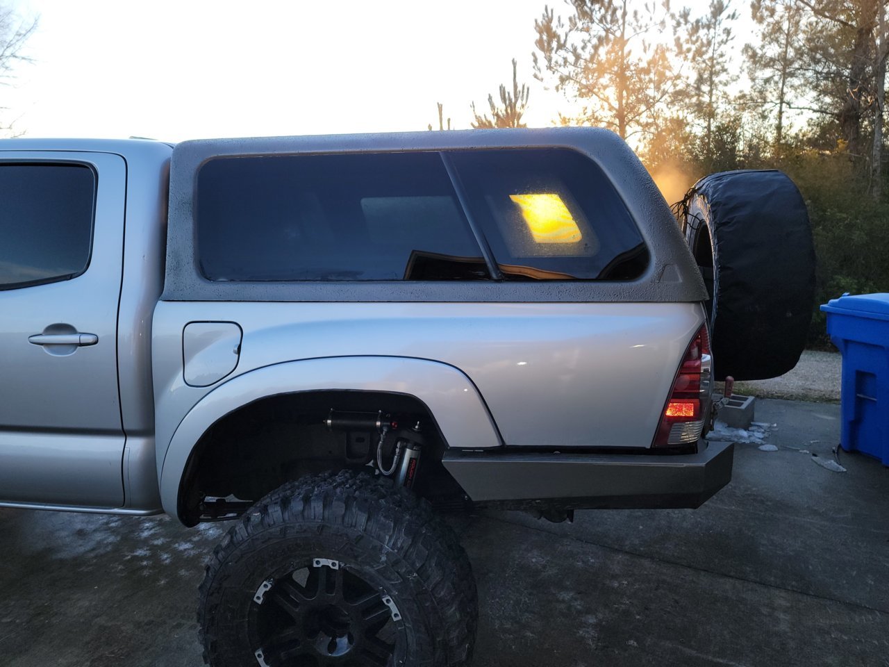

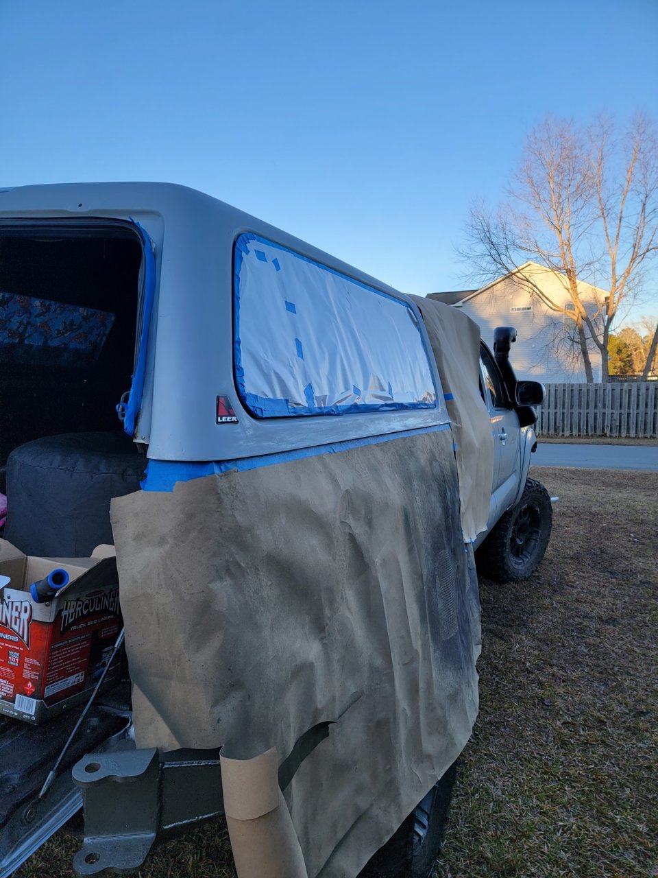

    Got the camper back.....instantly prepped and Herculined it......going to do a cast iron coat as well since painting around these parts is cumbersome and I already had it all in the garage
  18. Jan 24, 2022 at 4:44 AM
    #18
    Danny72
    Danny72 [OP] Well-Known Member
    Apr 23, 2019
    #291040
    381
    Wilmington, NC Area
    2011 DCSB 4x4 TRD Taco
    35x12.5r18s RC 6" Lift w/resies, Camburg UCAs, 3rd Gen Leafs, Brute Force Fab Front Bumper, HC Coastal Offroad Rear Bumper w/Swing-Out
    Still need work, but it will do for the first attempt. Once the base layer 110% cures I'll see about touch ups, then mount it flush with the cab....also attached the Swing gate/spare!

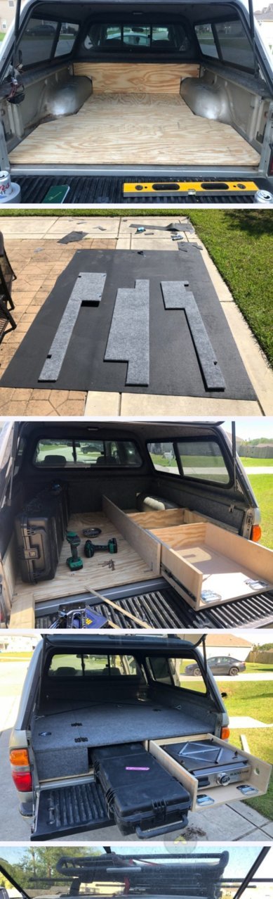

    So the more and more I have stared at a decked system, the more and more I have become obsessed with the concept.
    I'm stealing a lot of inspiration from an old friend of mine @chuckers and his custom build of a bed drawer system
    This is HIS picture!
    Luckily my dad is a part time carpenter so between our know-how's it's time to hit the drawing board!

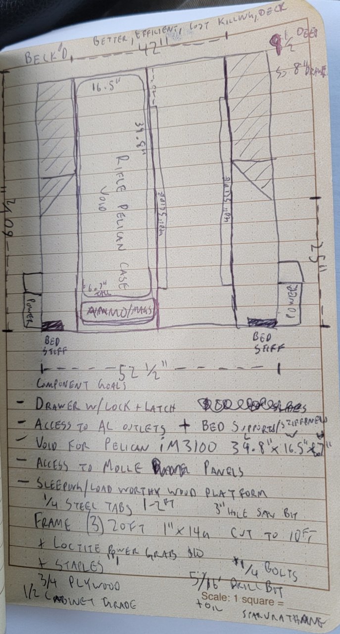

    Decked bed systems are sweet but they can't fit what I want and for $1500 it's not what I'm willing to spend for my needs
    My bed system is now underway!
    The rough draft of my blue print:
    To translate my quick-hand chicken scratch
    I'm making a deck thats flush with the wheel wells using:
    (1) 23/32 CAT Plywood (Mainbase board) - $51
    (1) 1/2" Blondewood Cabinet Grade Plywood (Drawer) - $32.50 (50% Off)
    (1) Redwood 4" x 1" x 4ft Plank (Drawer Face) - Free
    (3) 1" x 14G x 20ft Square Tubing - $108
    (1) 1" x 1/4" x 10ft - $7
    (9) 1/4" x 2" Hardware - $3
    (1) Loctite PowerGrab Ultimate - $10
    (1) 40" Heavy Duty Drawer Slides w/locks - $80
    (2) Single Folding Mattresses - $73.50ea
    (1) 1" Staples 100 pack $10
    (1) Roll of 2" Adhesive Velcro - Free
    (1) 3" Desk Wire Routing Cap - Free
    (1) Half Gallon of Sparurathane Outdoor furniture sealant -$25
    (4) 4 1/2" Hinges - Free
    (2) 48" L-Tracks - $94
    (6) Rated Track D-Rings - Free
    (1) Hooke Offroad Bed Stiffeners - $47 (Needed to go with these because of the way they mount mid pillar)
    Goals:
    - Single Drawer System for Recovery Equipment
    - Conceal a iM3100 Rifle Pelican Case
    - Route Wiring/Use of AC outlets
    - Sleeping Deck for the Wife/Myself when we camp/hunt
    - Weight bearing deck to still use the bed for heavy loads
    - Maintain the ability to hang pouches on my RC Molle Bed System
    - Clear my Hooke Bed Stiffeners
    - Look Cool....let's just be honest, it's a fun project
