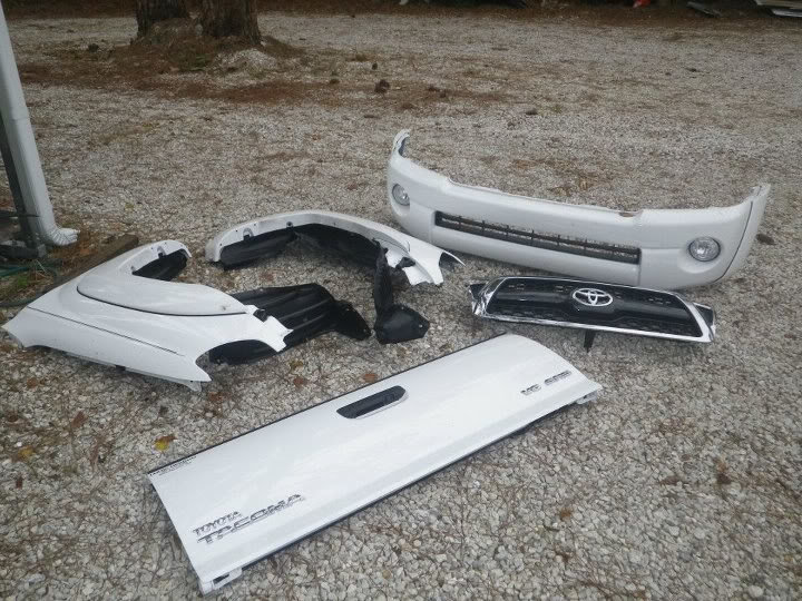

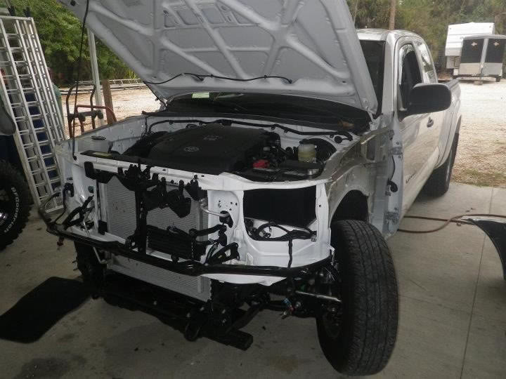

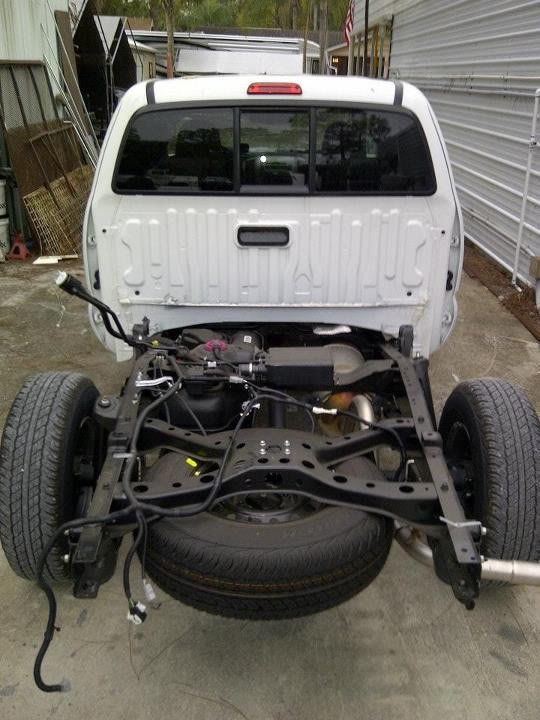

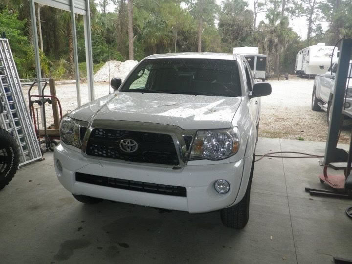

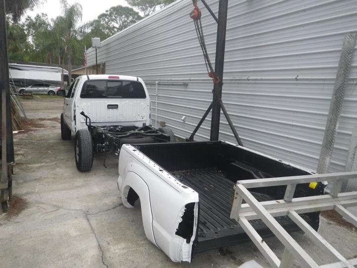

    Brand new 2011 Tacoma ready to be stripped

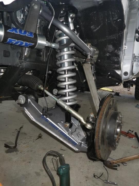

  4. Aug 6, 2012 at 4:36 PM
    Milowilli
    Milowilli [OP] Milowilli
    Jan 17, 2012
    #70857
    370
    Miles
    Naples FL
    05/ 07,09/11Tacoma access cab 4x4

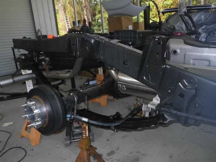

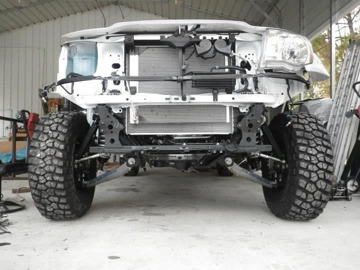

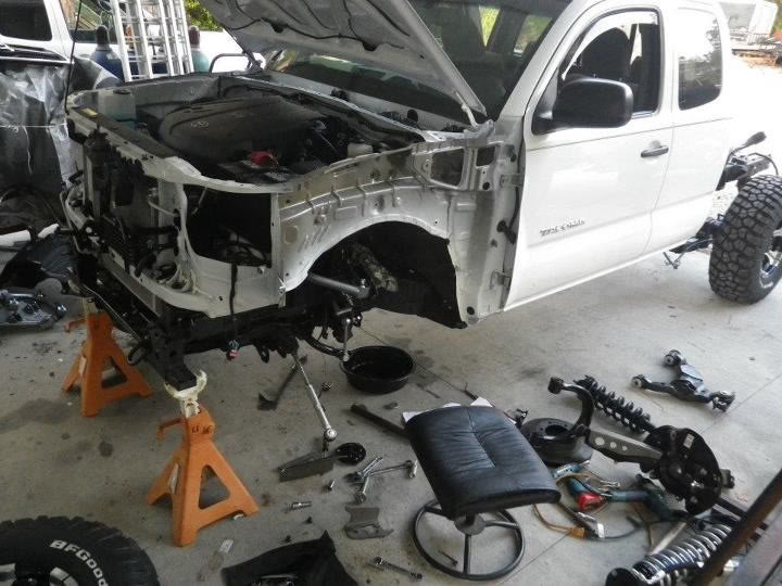

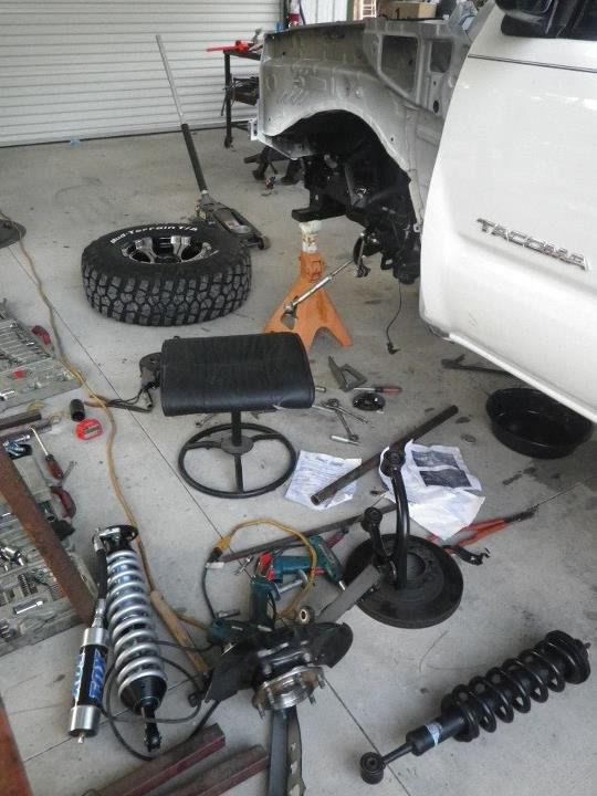

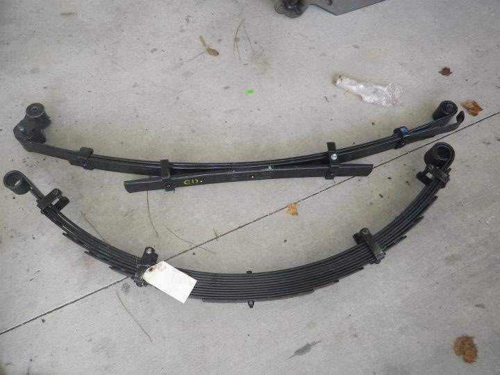

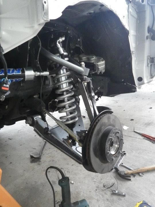

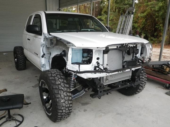

    Deaver spring for spring under conversion.
    Spring Under conversion.
    Installing Defined Engineering shock hoops.
    Glassworks fenders ready to be drilled and installed.

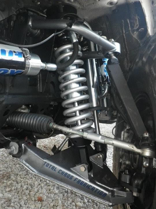

    Total Chaos 2inch long travel.
    ChadsPride likes this.

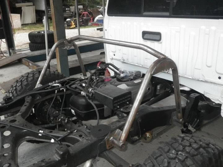

  5. Aug 6, 2012 at 4:39 PM
    Milowilli
    Jan 17, 2012
    #70857
    370
    Miles
    Naples FL

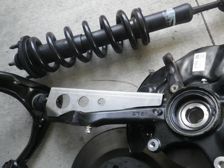

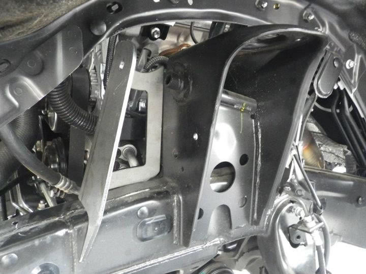

    Chaos fab upper A Arm gussets.
    Spindle gussets
    Controlled chaos

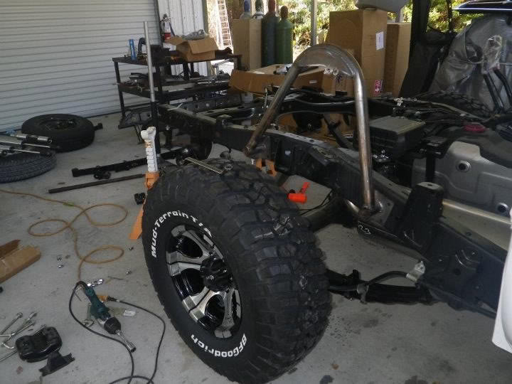

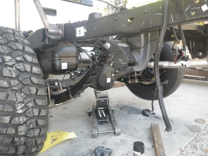

    More controlled Chaos!!!

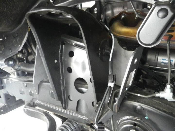

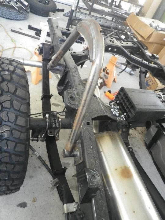

    Defined Engineering rear shock hoops.

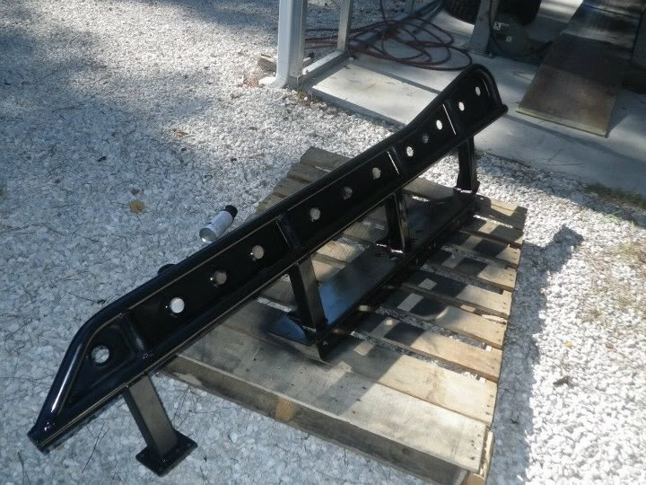

    All pro side rails with fil in plates.
    I eventually bodified this kit with a shackle flip for more droop and travel.

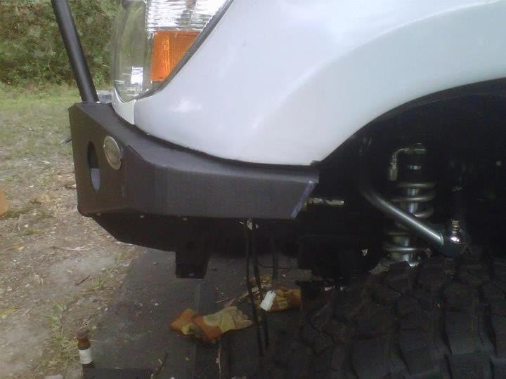

  10. Aug 6, 2012 at 4:46 PM
    Milowilli
    Jan 17, 2012
    #70857
    370
    Miles
    Naples FL

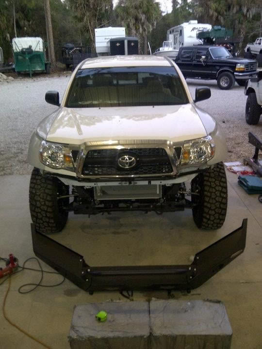

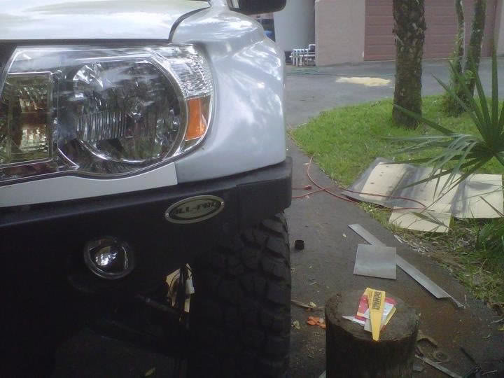

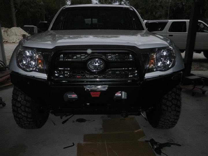

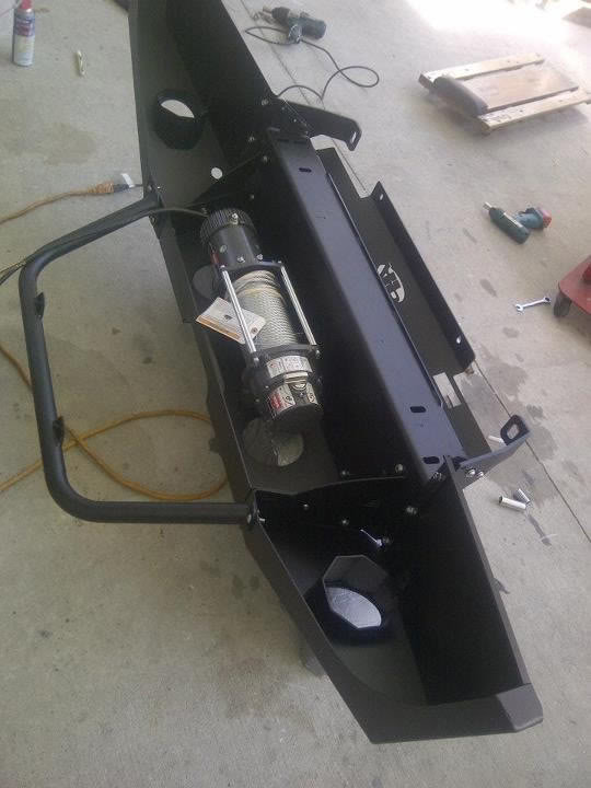

    All pro front bumper with Warn winch install.
    Got to modify the bumper ends!!! They dont fit!!!

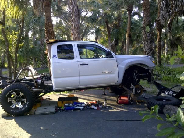

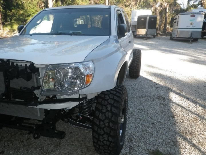

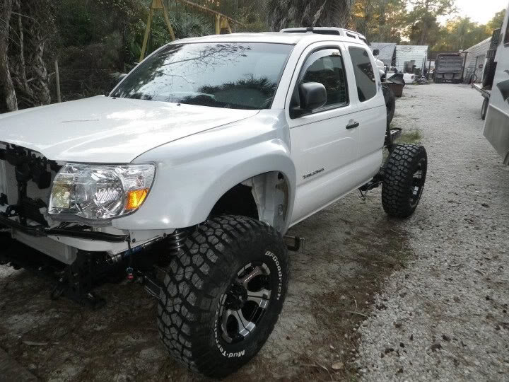

    Lots more travel!!!

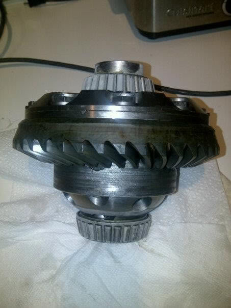

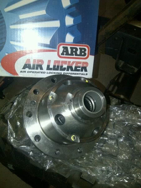

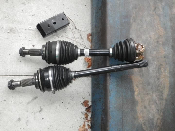

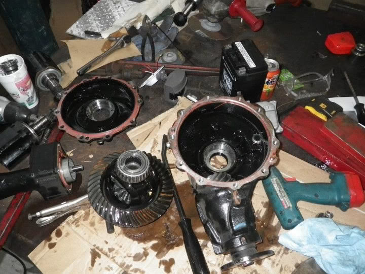

    Removed for front ARB locker..rear will have TRD limited slip..best combination...locker front LSD rear.
    Longer CVs for Chaos kit
    Opened for diff locker.
    My wife had a fit!!!
    Boiling ring gear
    Frosty locker with hot ring gear!!

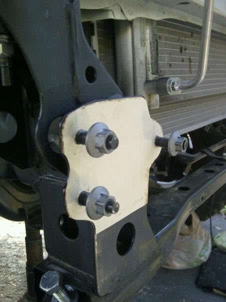

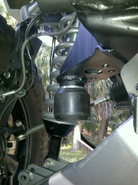

  17. Aug 6, 2012 at 4:56 PM
    #17
    Milowilli
    Jan 17, 2012
    #70857
    370
    Miles
    Naples FL

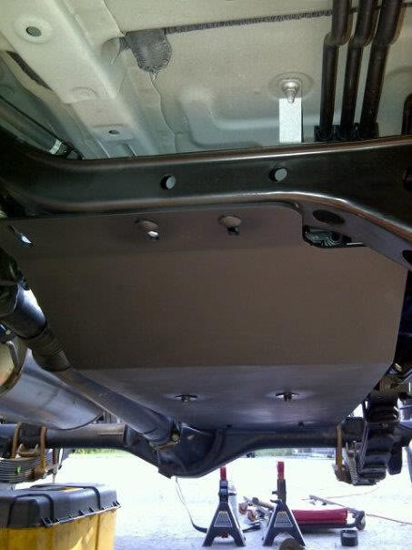

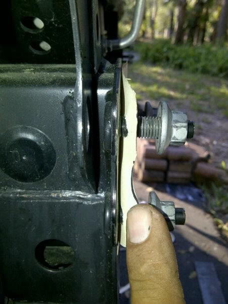

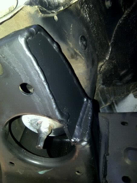

    This bracket needs a plate or else bumper will fall off.
    Template for bracket plate
    Budbuilt gastank skid plate
    Timbren SES front bumpstops..work sooo great!!!

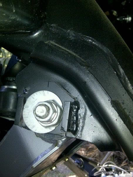

    Alignment cam gussets

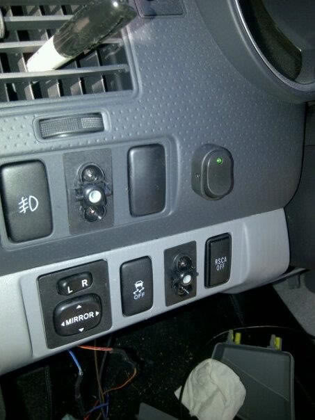

    Locker switches

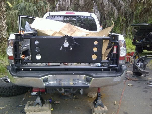

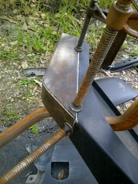

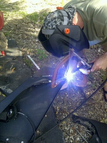

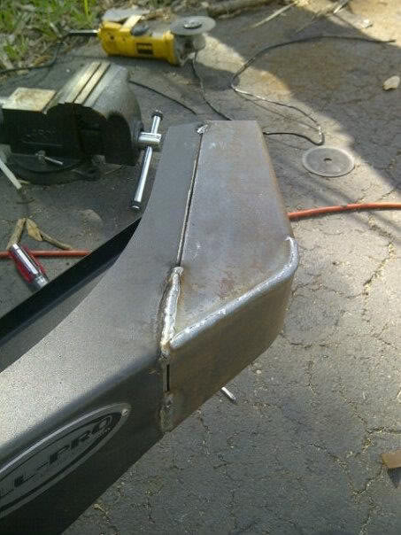

    Cab mount trim for tire clearance.

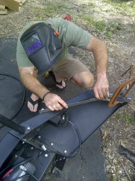

    Bumper extension template.
    Welded by my friend Jerome Smythe.
    Tiregate came with a warning...Do not install with fiberglass fenders!!!.....i made it work with reenforcement...sturdy as a tank!!!

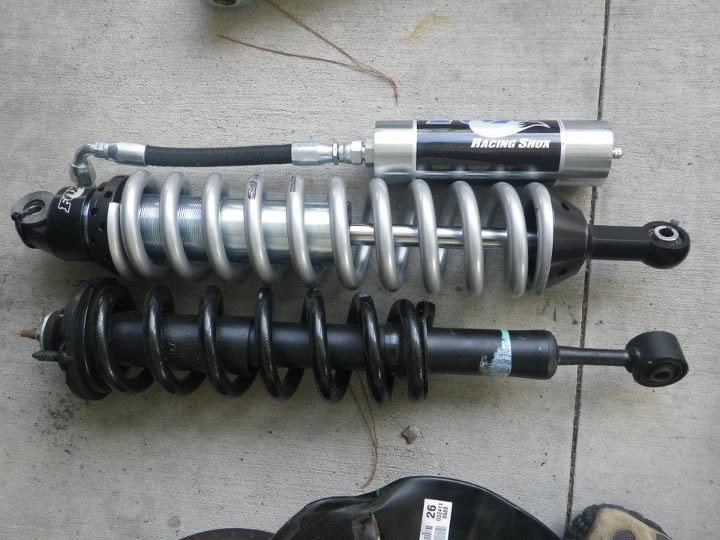

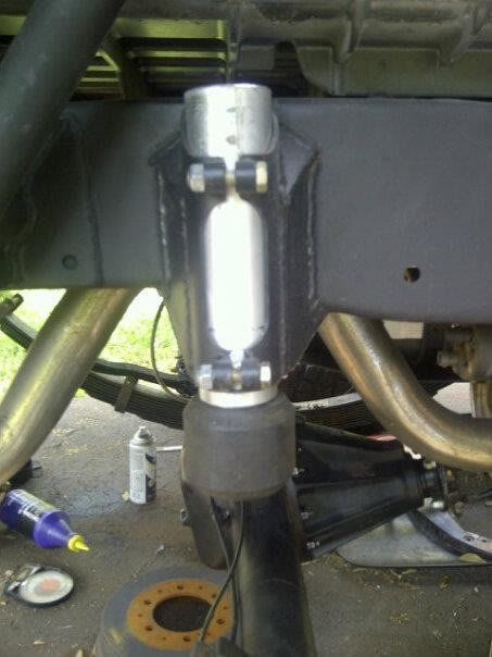

    Mockup for fox air bumps.
