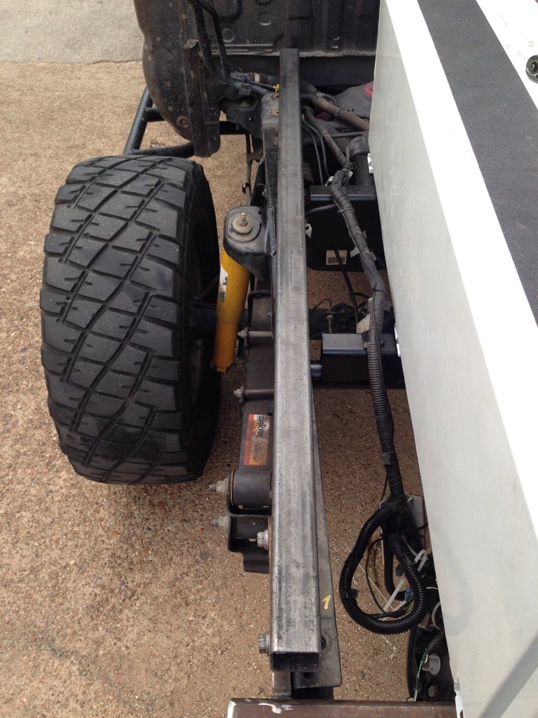

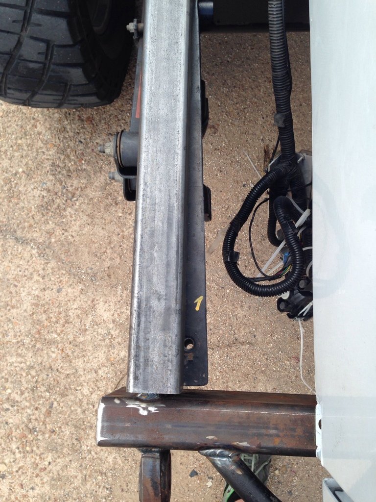

    Finally starting on the bed, and the first step seems to be the most critical.
    The frame rails are tapered, but I want a square bed. The current plan is to drill out the middle hole for the sleeve and then place the two end sleeves.
    The end sleeves will have to be cut into the side of the tube as they are not under the tube. The sleeve material I chose is 3/4" sch 80 pipe. The bed bolts have a nice tight tolerance with that pipe.
    Once the sleeves are in place I will reinforce them, but I have to get them in the right place first.
    So.... Does anyone see any issues with the plan?

    Won't be a problem, just wrap some plate over the exposed sched 80 and burn it in.

    The only "pipe" that will be used on the bed is for sleeving material for bolts. Not that it really matters any way. I'm not going to get into a pipe vs. tube argument here. I will say that both pipe and DOM tubing have a welded seam. :D

    Depends on what DOM tubing you get. Erw DOM has a welded seam just not visible. Then there is DOM that starts out as solid bar stock which actually has no seam at all.

    Well.... there's DOM tubing and then there's DOM tubing. It can be welded, drawn and heat treated to the point that the area of the weld becomes metallurgically indistinguishable from the rest of the tube.

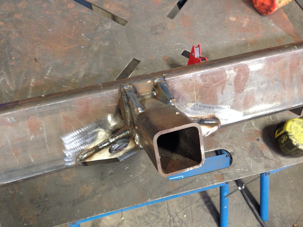

    What are you doing for towing chain attachment points? Need to add some to my bumper.

    I built them into the stiffeners for the receiver tube.

    Your ATO high clearance doesn't have chain keepers?
