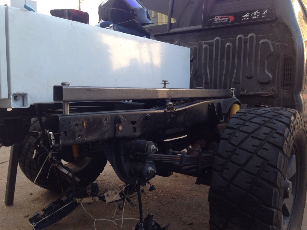

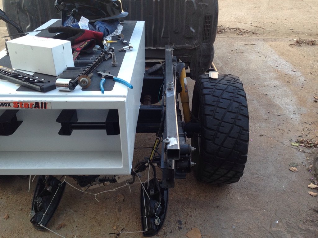

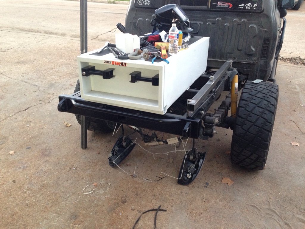

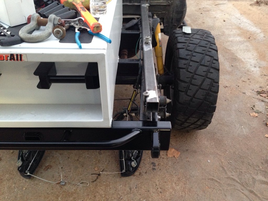

    Made some progress today. After several setbacks due to too much heat from welding I was able to lay out the lower bed rail on the passenger side. I also cleaned up the bumper and painted it.

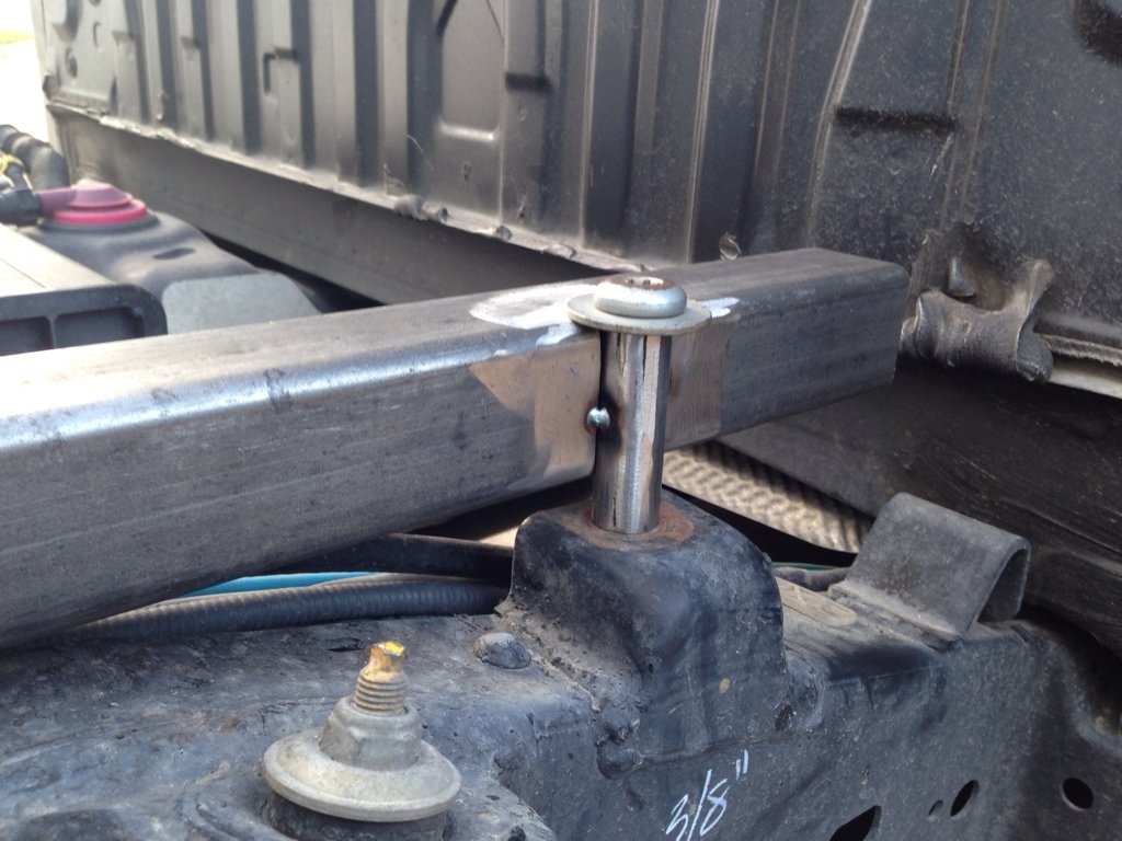

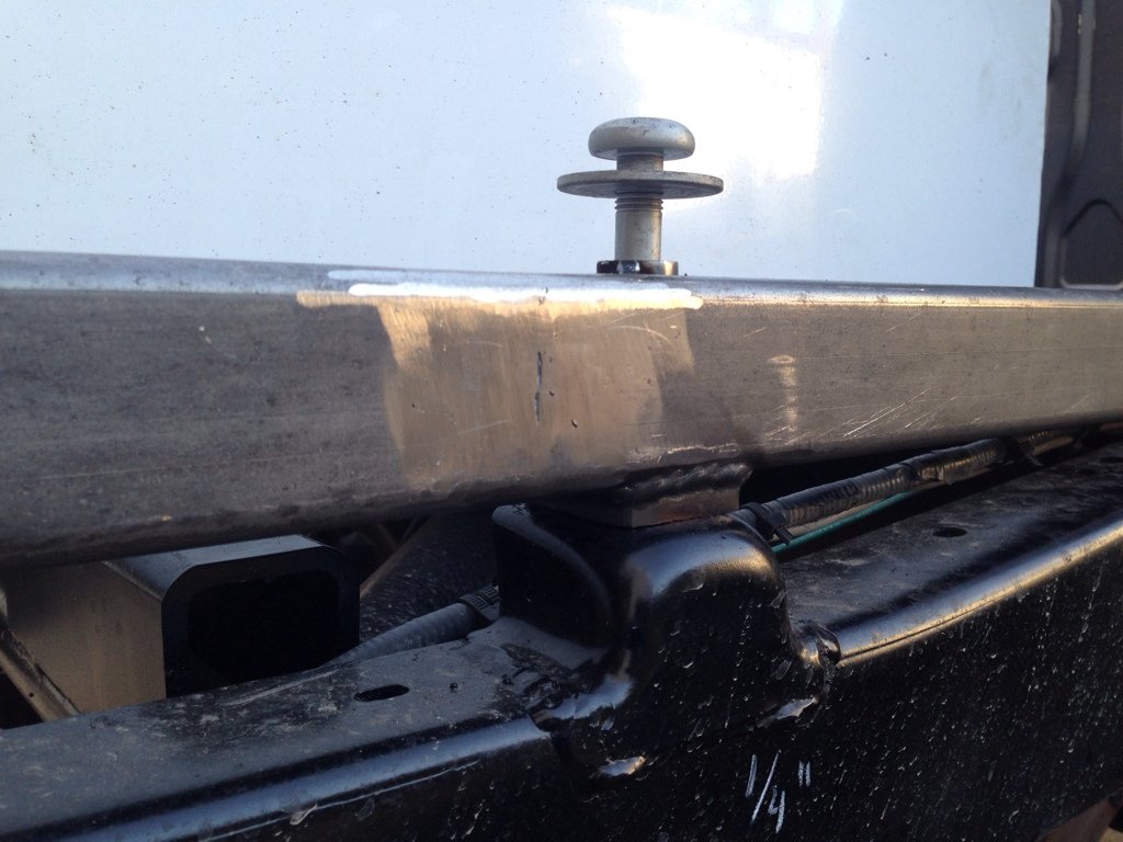

    Glad to a see a real project versus bolt ons and paint.
    Nice progress and skill level. Wish I had time to tackle a large project again.
    You will probably change it or add to it, but I would distribute the stress put on the frame rails were the tube steel sleeve rests that the bed bolt goes through.

    Yup, trying to keep the square tube square to the cab isn't easy. So far so good.
    Thanks. Yes, there will be plenty more steel added to the sleeves. I won't rely just on the sleeve for my bearing point.
