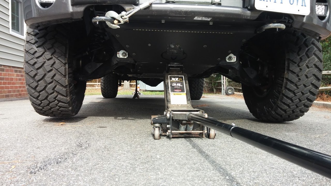

    I agree. There's better options than a huge chunk of heavy steel. Want to try something new since I proved the haters wrong on the alum skids on my old yota. Hopefully I can test mine more than with a jack here soon. Not sure if the subframe will work over a thin skin of material behind it since its only 1/2"

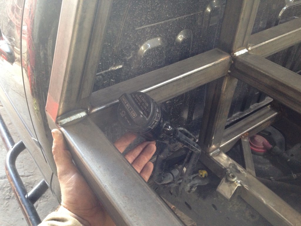

  18. Nov 29, 2014 at 8:07 AM
    #318
    SMKYTXN
    SMKYTXN [OP] If it can't be overdone it's not worth doing Vendor
    Mar 11, 2011
    #52810
    14,040
    Nathan
    Houston
    11, 4dr, TRD Sport, 6sp
    DCFB

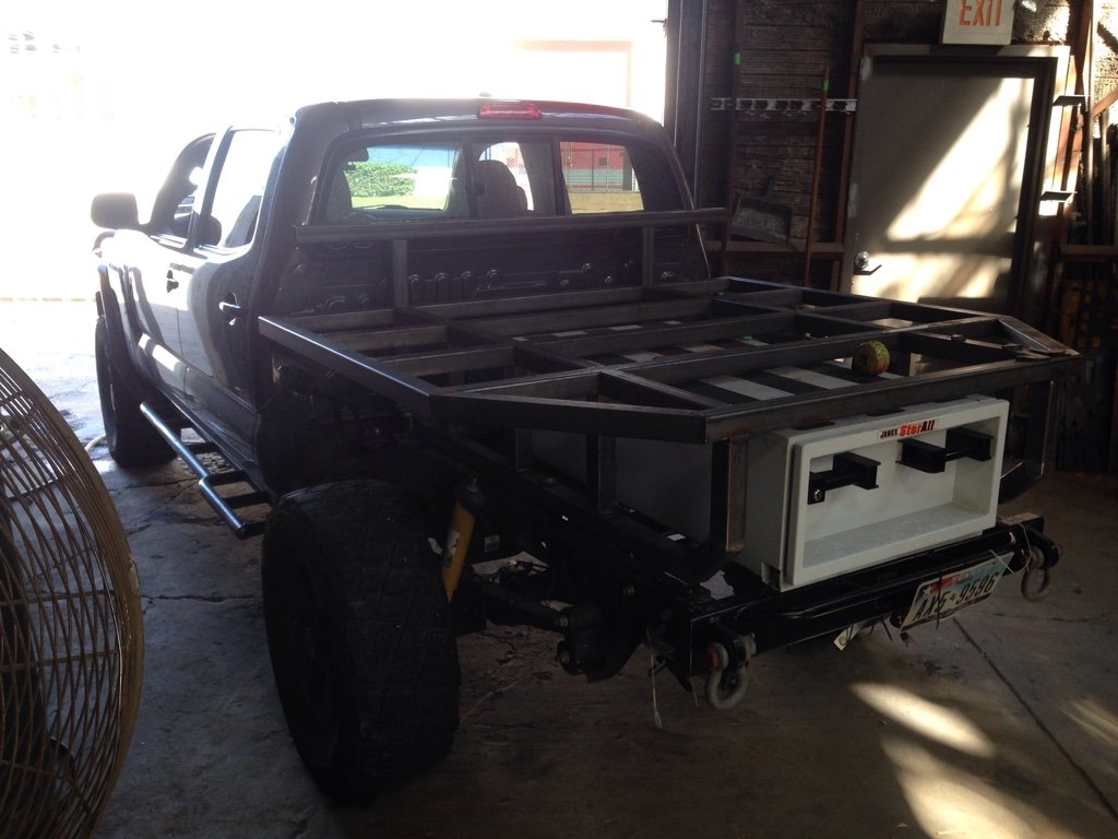

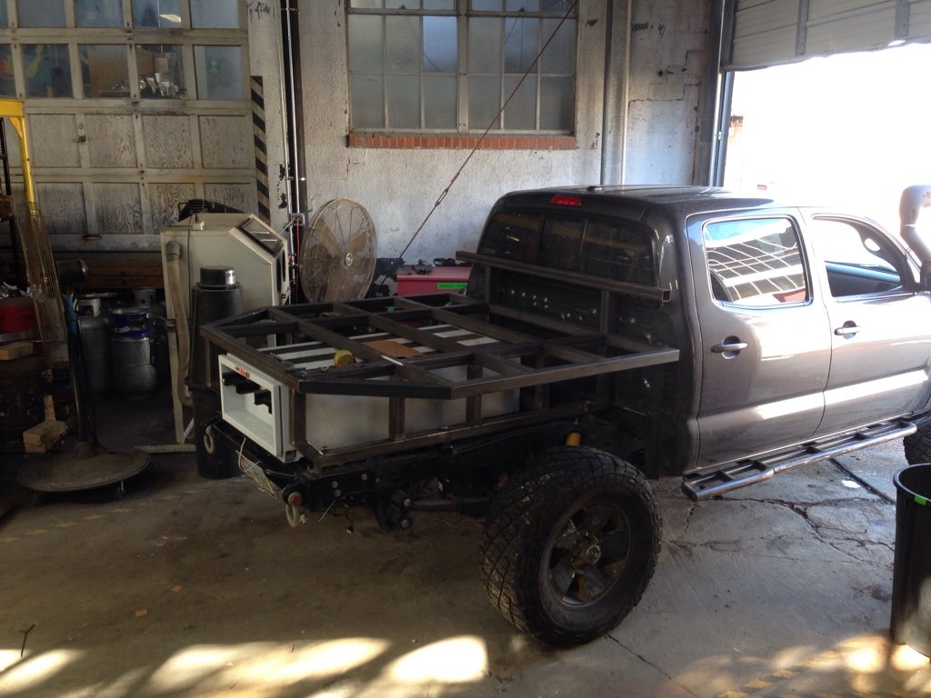

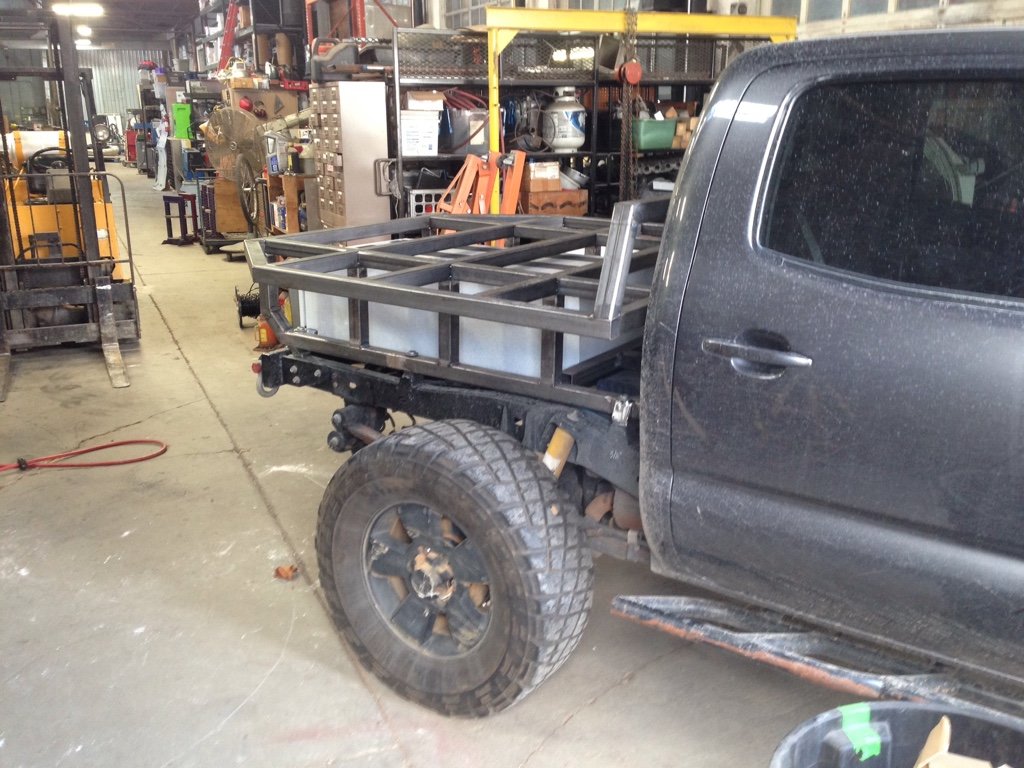

    Well that's not going anywhere. 33837b9556f380d68985249a66fe80b5_4523d6e18bf93d4b801d358ccecf9e5a9a16aaed.jpg

    I'm liking the headache rack.
  20. Nov 29, 2014 at 1:01 PM
    #320
    SMKYTXN
    Mar 11, 2011
    #52810
    14,040
    Nathan
    Houston
    DCFB

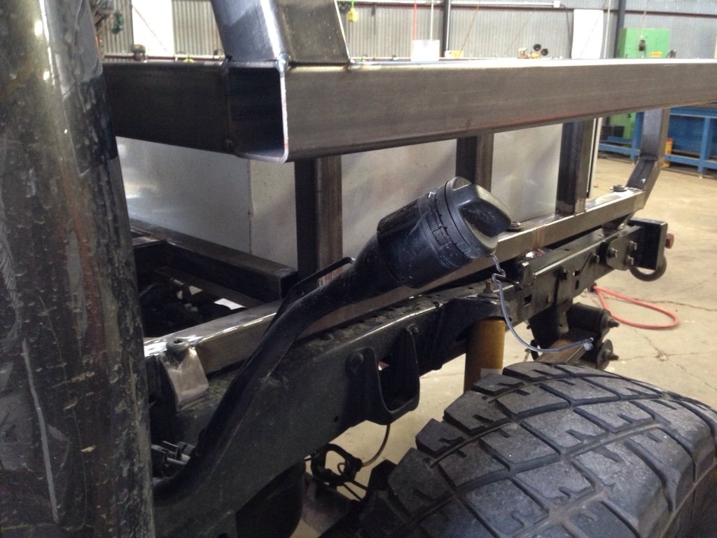

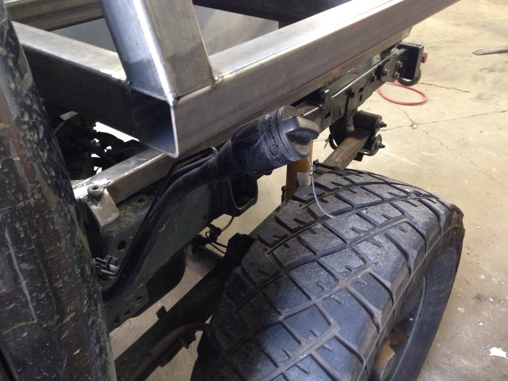

    Above or below the deck for the filler neck?
