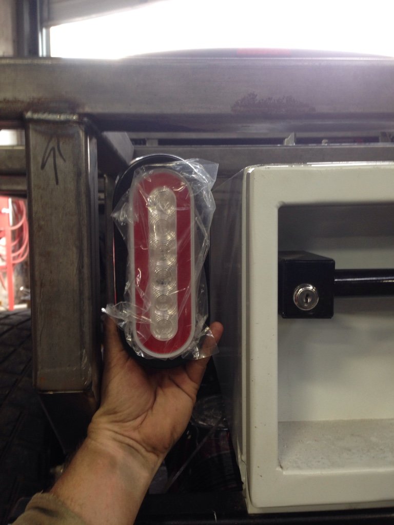

    Need to get some heavy rubber for the filler neck surround so I'll leave that for another day. On to the tail lights!

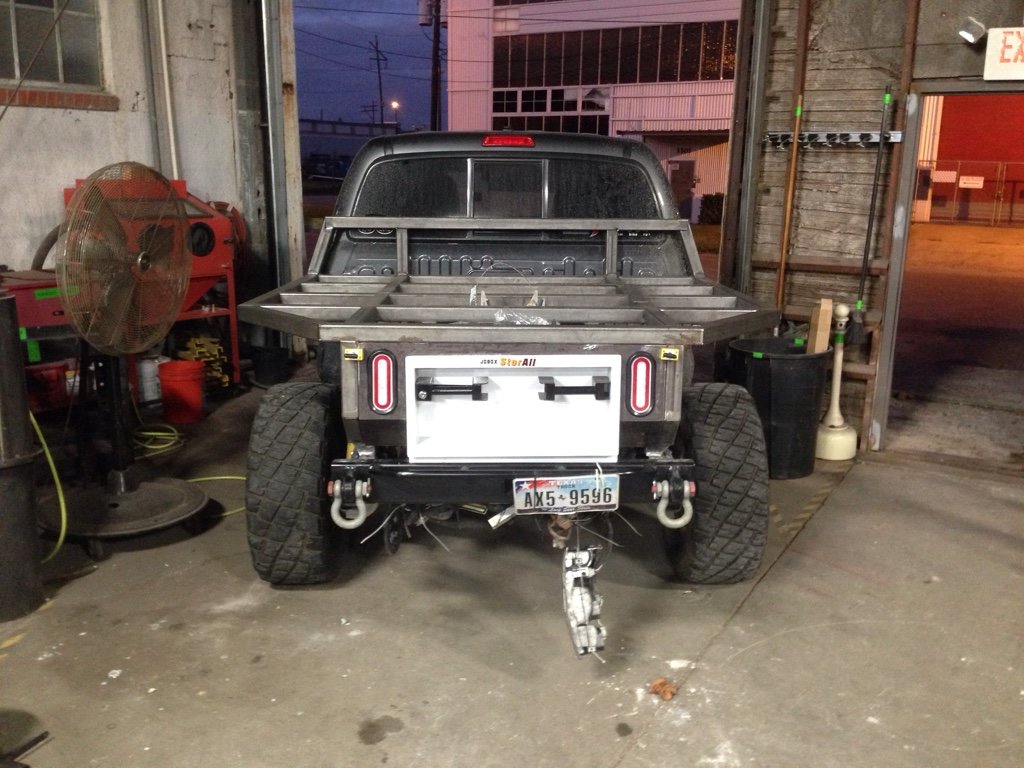

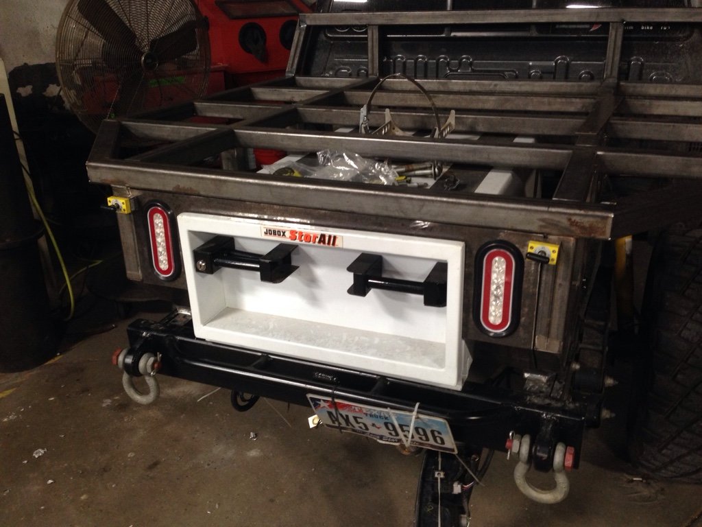

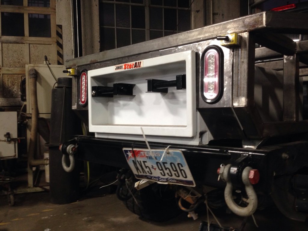

    The lights are stop/turn/tail. I'll have a secondary backup light.
    Thanks buddy. It's amazing what one piece of plate does for a project. Maybe I'll get to weld it on tomorrow. :)

    Truck looks mean from the rear currently.
    What is your states law regarding the wheel being covered/mudflaps?

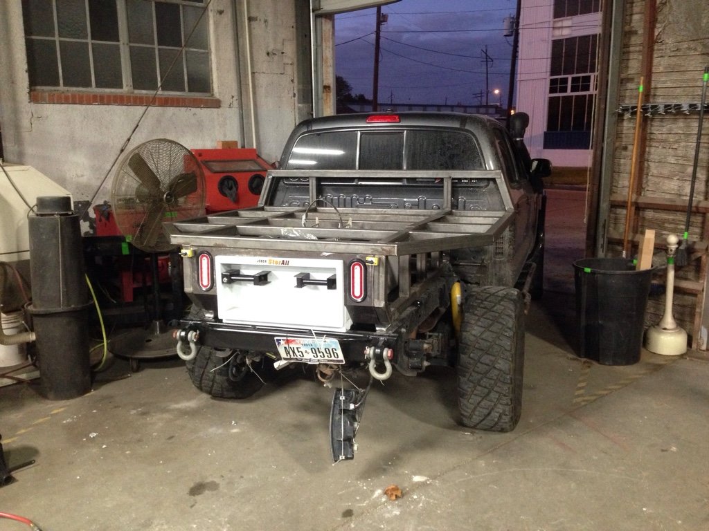

    Thanks.
    There isn't one. I've been running around for three months with just the toolbox on the frame and haven't had any problems.

    What about side marker or clearance lights for the rear?

    Can't see how I'd need side markers. Are you talking about the rear or up on the headache rack?
