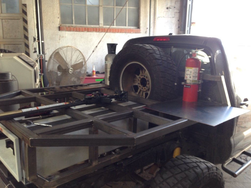

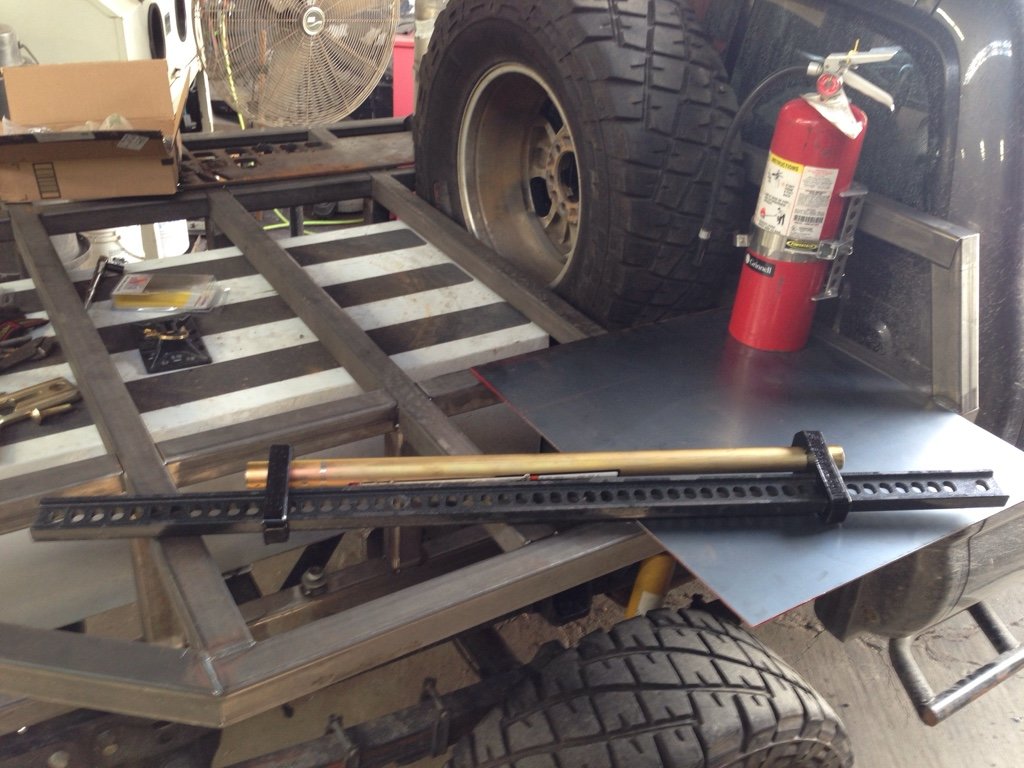

    Trying to figure out where everything is going to live. a35fa54824685d3f2b3227f85e54b8e5_b89ed9ff21cca03ea8ceba7a44b3d6fac469507e.jpg

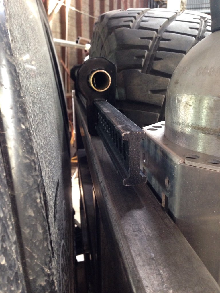

    The plan is to have the foot and lift mechanism in the toolbox. The handle and main beam will sit on top of the headache rack. 60f62e95e398b875f13e922d7ad2ca47_8f655055e3ad044852342336a433dafcb2eaa9c8.jpg

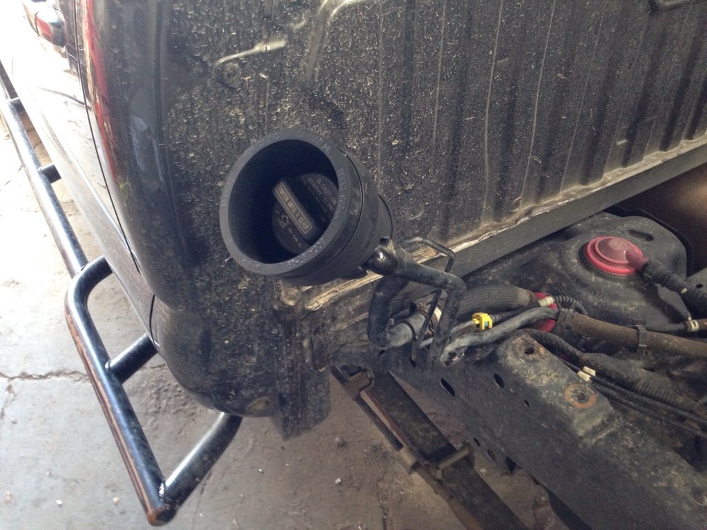

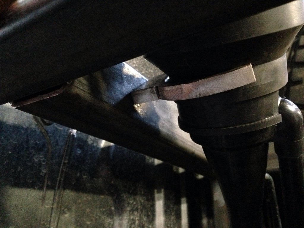

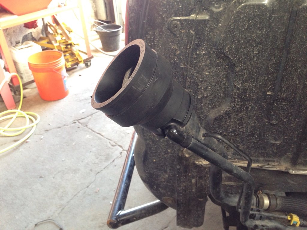

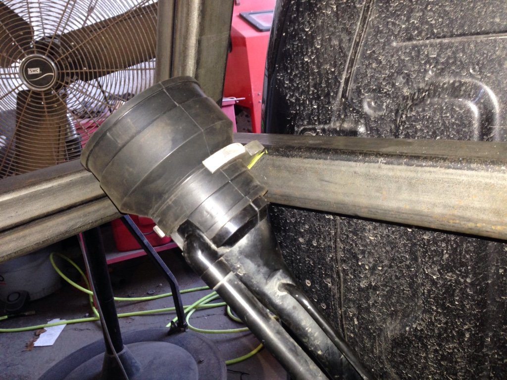

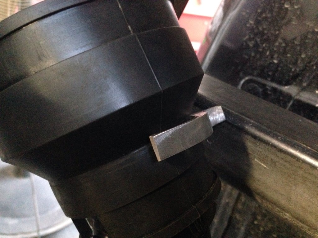

    Going nowhere fast today, but I think I have the filler neck figured out.
    I added a spacer to the lower mount. Yes, that's a socket. I promise to find a real spacer at some point.
    Then I cut out a bracket to hold the new rubber bushing. The bracket is a pressure fit, just enough to keep the nozzle from moving around. I can also pull it out with effort, so taking the bed off won't be impossible.

    looks good man. sometimes sockets make the best spacers :D

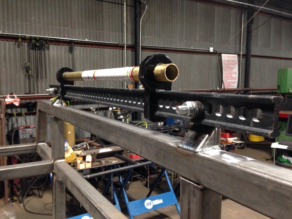

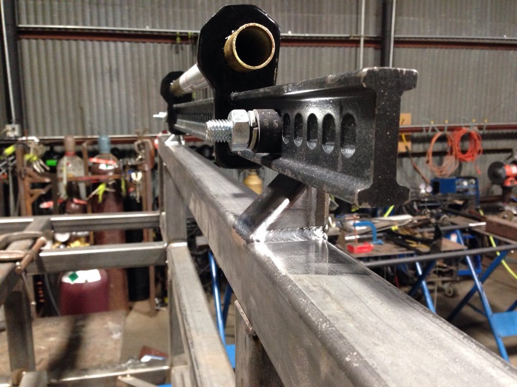

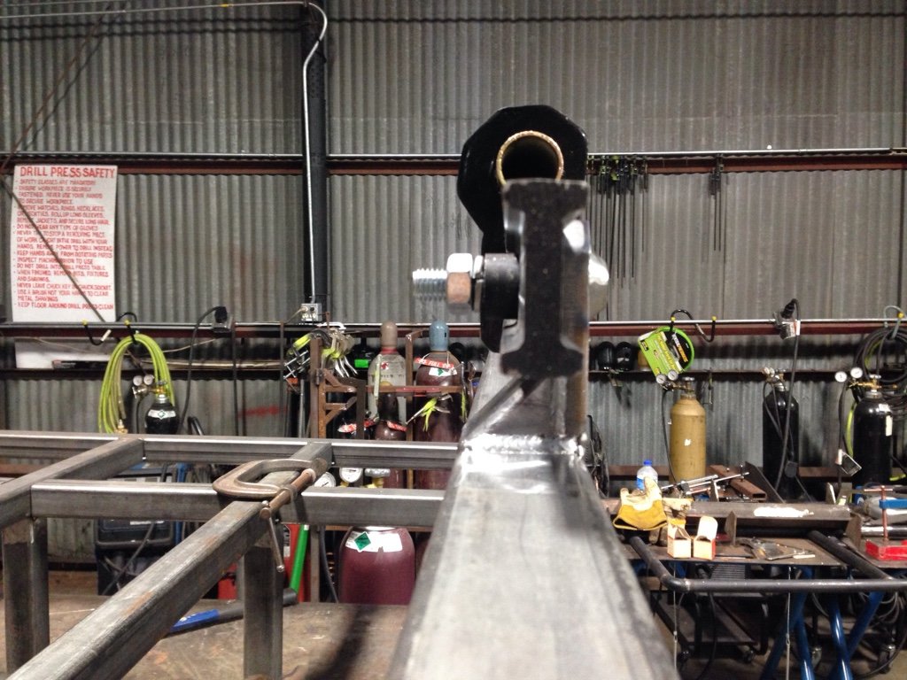

    Hi-lift mount complete.

    Working on the spare tire hold down points at the moment.

    2011 PreRunner
    Welds on the hi lift mount look great!

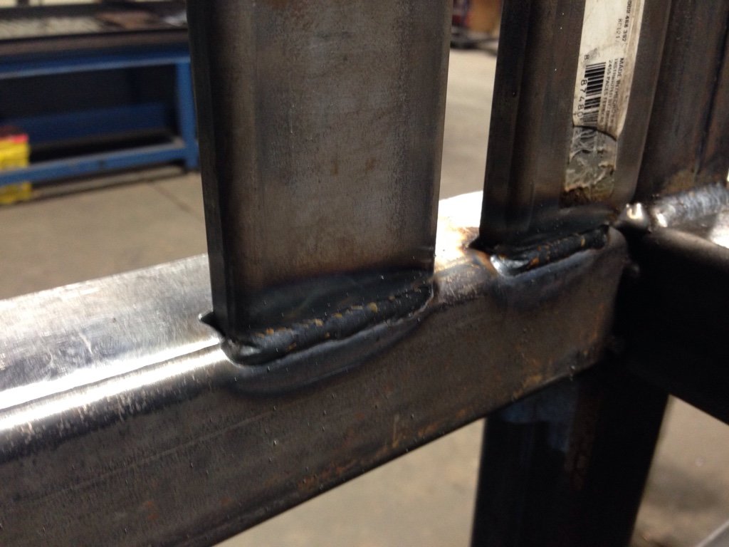

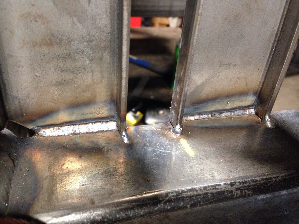

    Thought this was cool.
    Front side
    Back side
