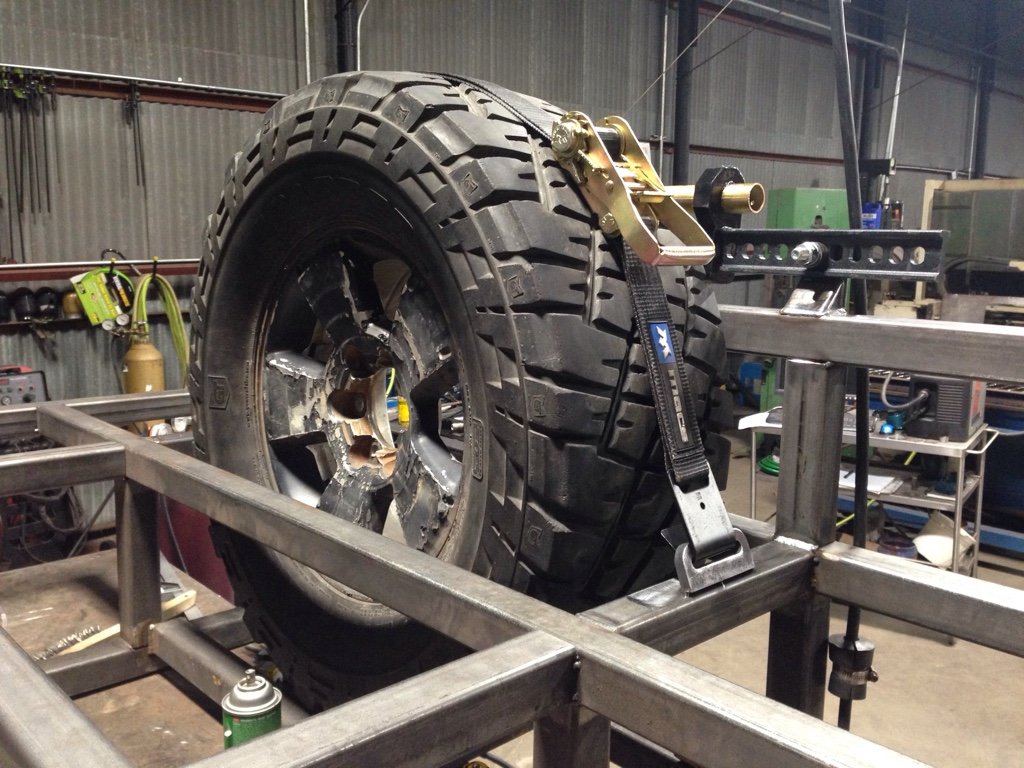

    How do you like those Mac's straps ? Any feedback ? I will be ordering 2 for my trailer build in the next few days

    Awesome stuff.. I'm only building park benches at the moment..
    Are you considering using UHMW as an isolator on your tire mount? I'd hate to see abrasion on a sidewall from rubbing on steel for a few thousand miles.

    This is the nicest strap that I've ever owned. The ratchet is smooth as glass and breaks over and releases very easily. The strap material, stitching, and hooks are top notch. You won't be disappointed.
    Good thought, but I don't think that will be an issue. I have a gap on either side of the tire for one, and the smooth side of a square tube shouldn't cause any issues.

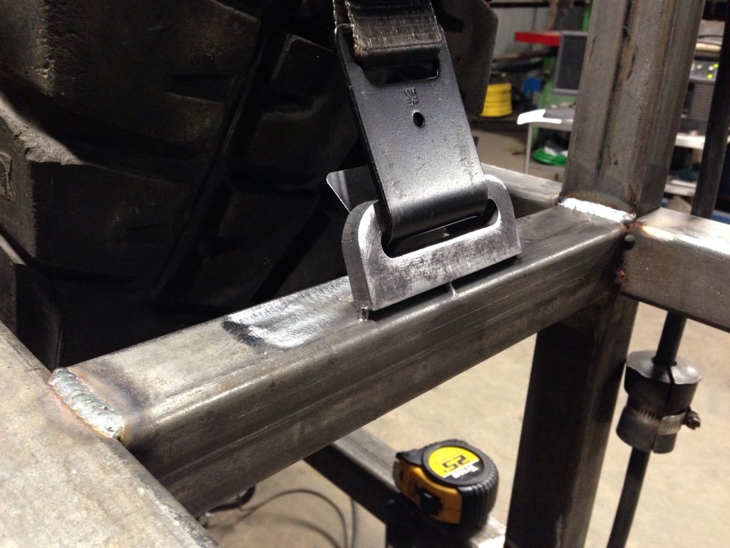

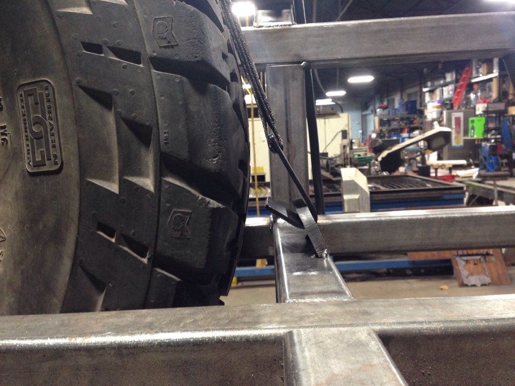

    Any thoughts about standing the tire holddowns straight up? It would give you more surface for welding and there doesn't seem to me to be much benefit to putting them at an angle - other than it looks cool. :cool:

    By attaching the hoops at an angle, in plane with the strap, I have reduced the out of plane forces on the hoop. There's plenty of area to weld as I've basically created a bevel weld on the outside that ties in to the vertical portion of the square tube.
    If I had placed them straight up in the middle of the tube I would have been pulling the hoops sideways over a flat plate. That would create a large moment at the base of the hoop that would only be resisted by the flat surface of the tube. Not a good idea. As it is now I have a tension only load on the hoop that translates down to a vertical portion of the square tube.
