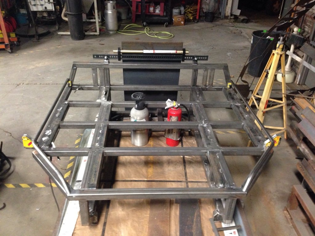

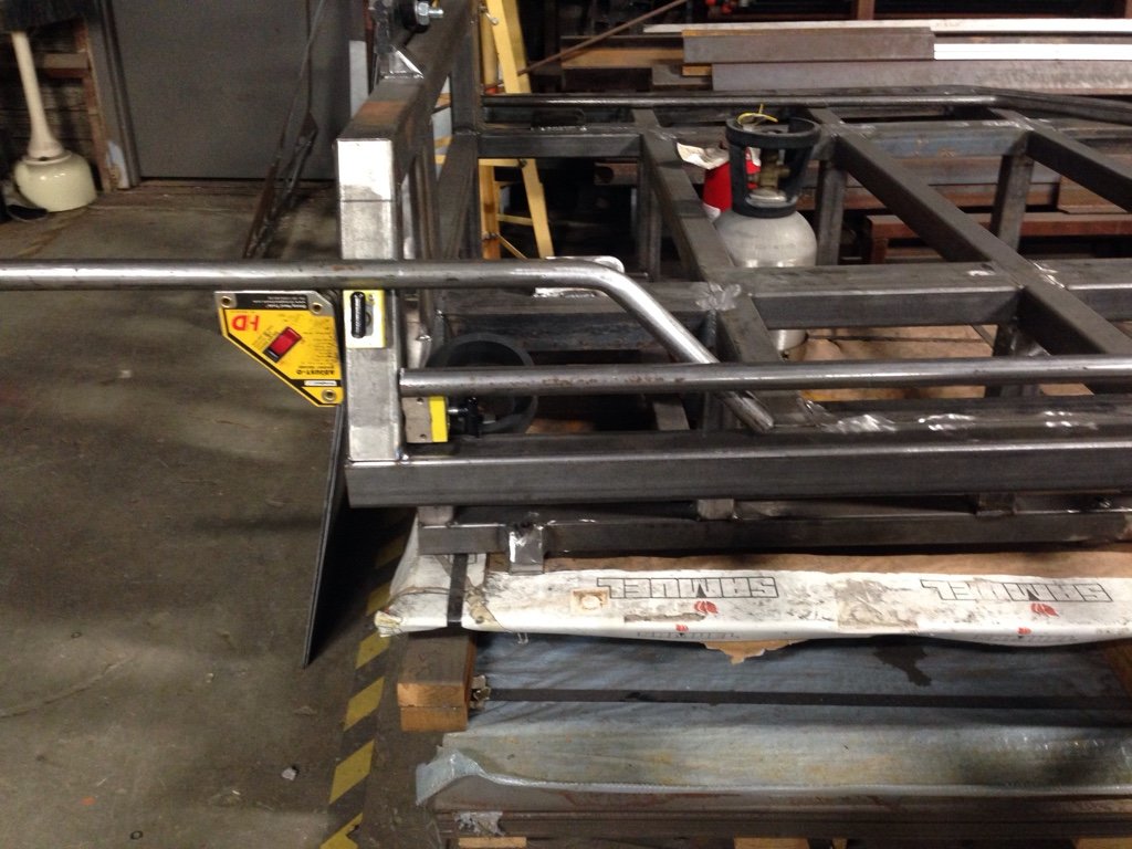

    Working on the outside rails. Need to figure out what to do about the filler neck area. May just stop the rail short there instead of tieing into the headache rack.

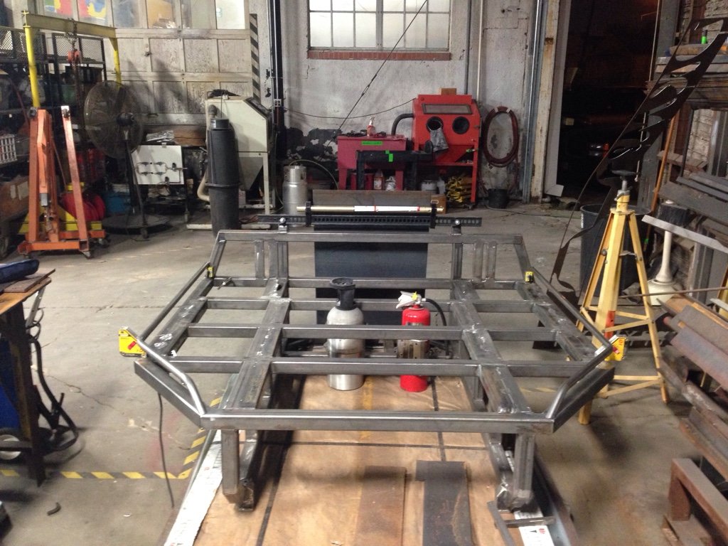

    11, 4dr, TRD Sport, 6sp
    DCFB
    Here's the plan. The middle bar will be cut out on the drivers side for the fuel inlet and left on the passenger side. Thoughts?

    I think that would be a clean way to finish it off. Are you going to fab a plate to mount the filler head in that would contour that area?

    I had thought about that, but I'm running out of time. At some point I could fill that area in with a piece of plate and put an aftermarket fuel door there and run new hoses to the tank. I think this option will leave room for improvements in the future.

    Are you going to do this to both sides? Give it a uniformal look?I know it's more work and material, but it would "balance" things. If not I still think it looks badass.
