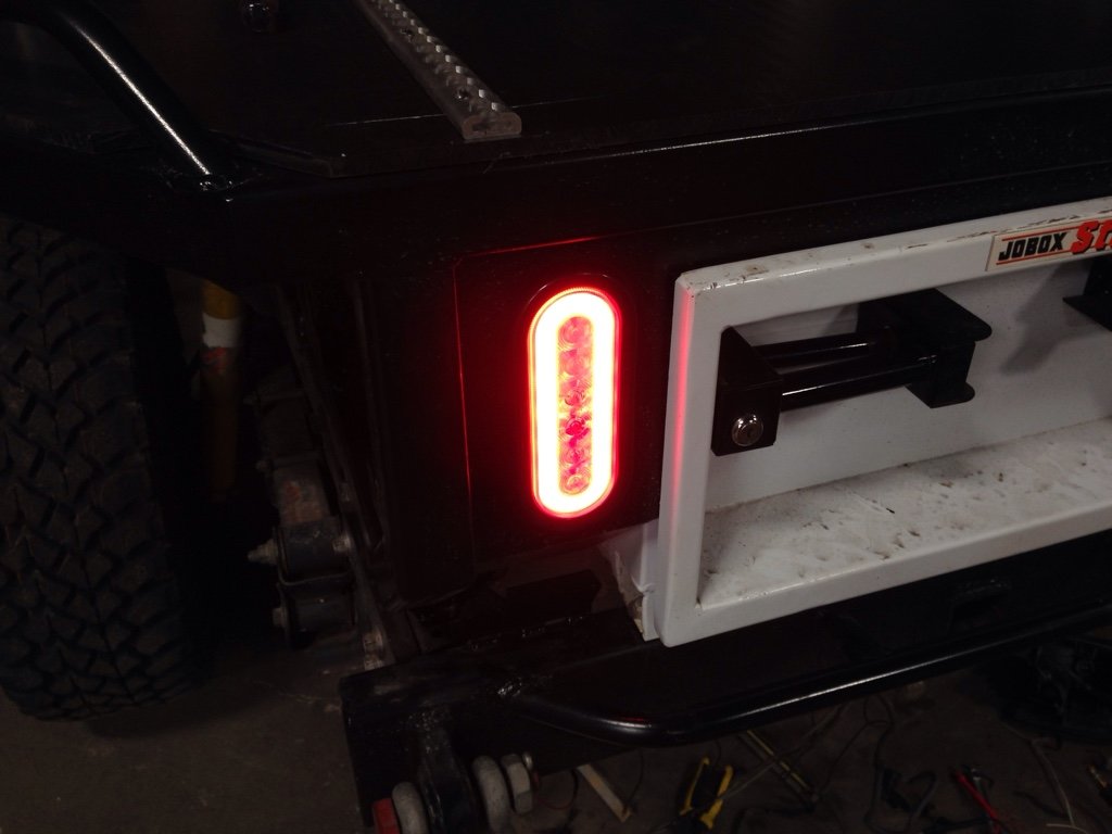

    I'm experimenting with resistors found in the shop. They're supposed to stop hyper flash, but they're actually causing it.
    Glolight 6" oval

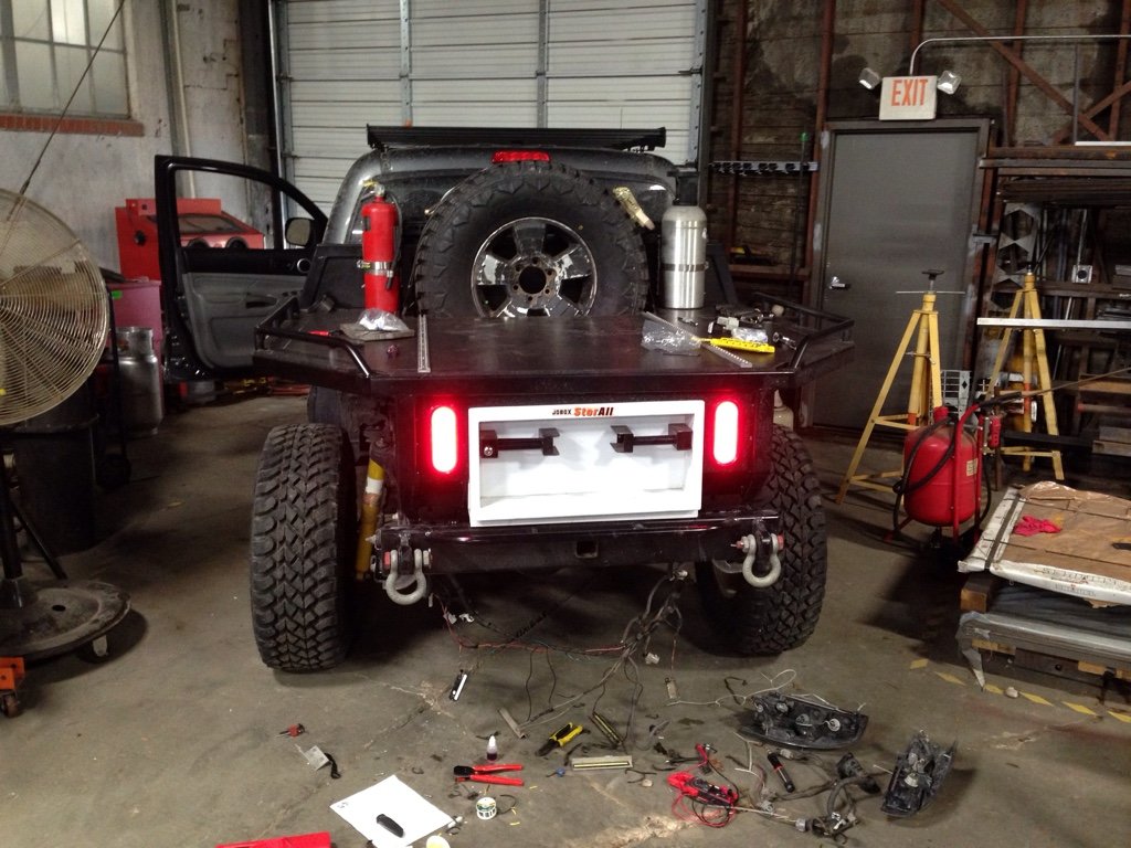

    Not quite ready to drive home, but I'm getting closer.

    At least I have running lights and brakes.
