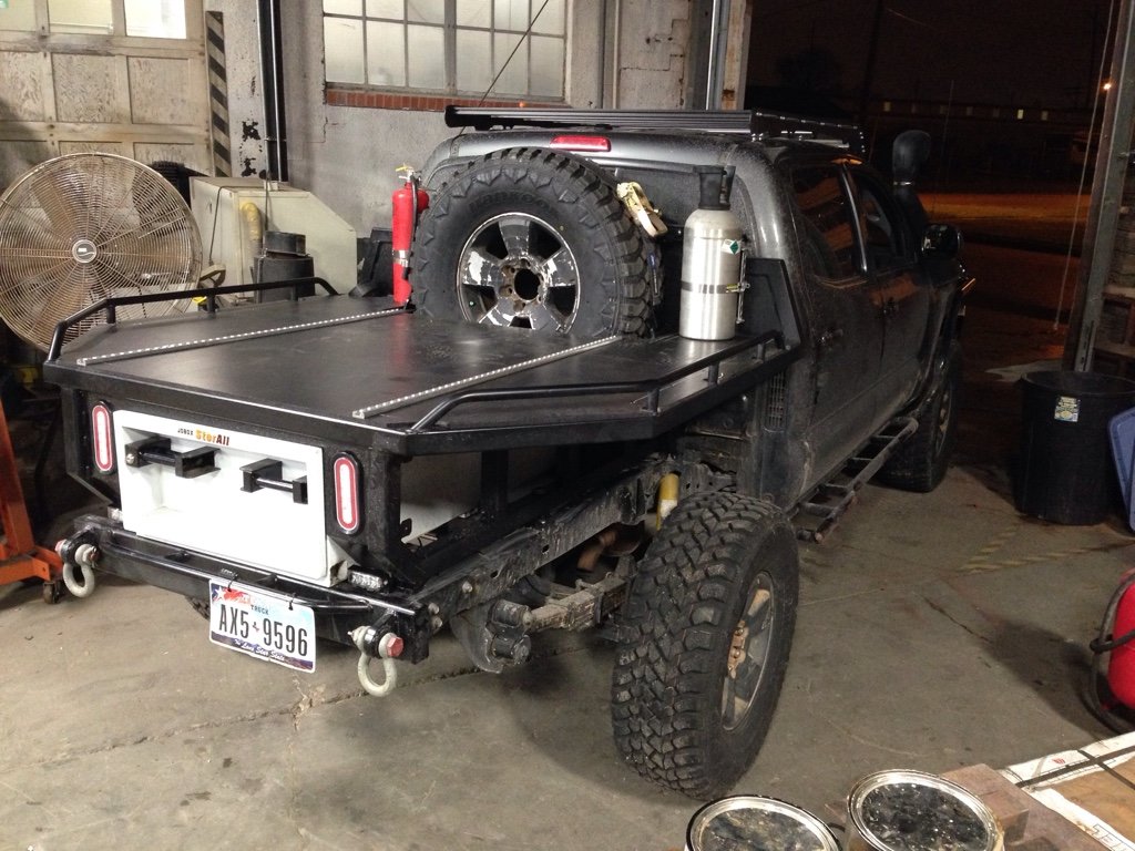

  8. Dec 20, 2014 at 8:04 AM

    Maybe not boxes, but something to utilize the space. I'll see what I need as I go.
    Thanks Howard. The co2 is for airing up tires and running an impact gun.
    I'm out running errands this morning. Figured another pic wouldn't hurt. Need to find a nicer backdrop though.

    That is sweet! a little more lift in the front and the gap in the back wont matter...especially if you go with shock hoops and longer shocks in the back

    Mount the plate on the drawer. It'll be out of the way

    The diode trick will prevent te signal light from spreading to the brake light circuit it will also make the brake lights override the signal light circuit. Not always desirable.
    You will need to use a trailer 4 light to 2 light adapter for correct signal/brake circuit operation plus a set of resistors to keep the flasher from mistakenly detecting a burnt bulb.

    When I load down the bed the truck will sit level. As it is I'm debating taking a little more preload out of the front.
    :thumbsup:
    Skeptical huh? Glad you like it.
    That's the plan, just have to take the handles off and drill two new holes in the plate.
    The current plan is to put a diode on both the brake signal wire and the turn signal wire before I merge them into the single line feeding the tail light. We'll see if that works. If not I'll look into the adapter you mentioned. Do you have a link to said product?

    dang less preload? you aren't afraid of the tires rubbing?

    They're going to rub until I get my new wheels in January. Then I'll be cutting the fenders, but won't have to worry about the tires touching the frame.

    Ok, I added the diodes. I now have turn signals, but no signals during braking.
    Styk was on the money about the adapter being needed. I'll have to find one and order it. It'll have to be sent to arkansas though as I'm leaving tomorrow and this is good enough for now.
