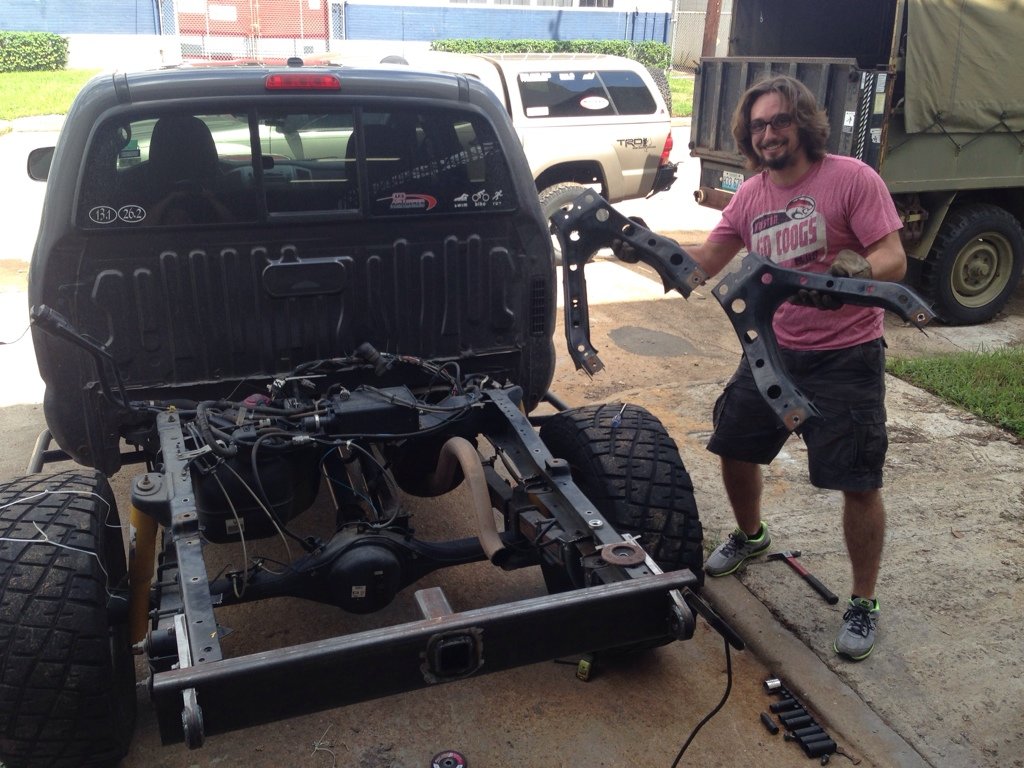

  18. Dec 3, 2015 at 9:08 AM
    #678
    phillstill
    phillstill Long hair don't care
    Jan 9, 2012
    #70318
    9,445
    Phill
    Tulsa
    LT35TANK
    Everything
    Oh My!!!! Look at that hair! :rofl:
  19. Dec 3, 2015 at 9:09 AM
    #679
    SMKYTXN
    SMKYTXN [OP] If it can't be overdone it's not worth doing Vendor
    Mar 11, 2011
    #52810
    14,040
    Nathan
    Houston
    11, 4dr, TRD Sport, 6sp
    DCFB
    You had to go and be all grown up with your new haircut. :D
  20. Dec 3, 2015 at 9:11 AM
    #680
    phillstill
    Jan 9, 2012
    #70318
    9,445
    Phill
    Tulsa
    LT35TANK
    Everything
    LOL, yeah.
