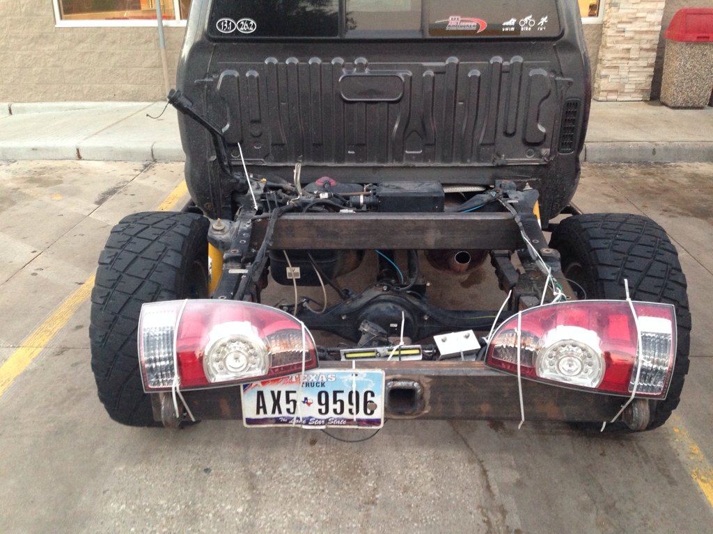

    Hey Nathan. I'm planning on carrying all of the crap that's behind my back seat and in the floor boards. Items like; tool bag, recovery gear, trail vise, etc.
    Here's the cross member we put in last night. I'll get more pictures later.

    I see you incorporated a hitch receiver to the rear bumper, how much would you be able to tow since i dont recall the bumper being bolted to the frame, just welded? :popcorn:

    The new bumper is bolted to the frame, not welded.
    The stock receiver is bolted to the frame as well. I also ran the numbers on the tube I used for the bumper. I wouldn't hesitate to tow the full listed capacity of the truck.
