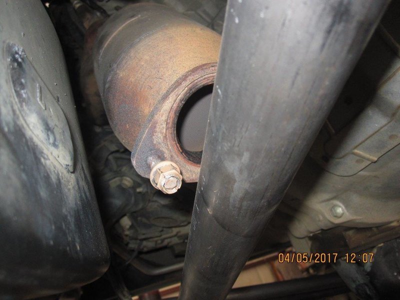

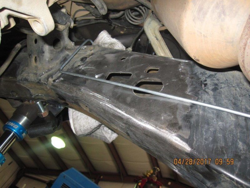

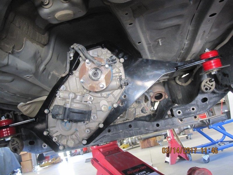

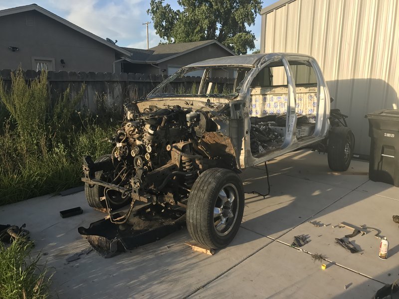

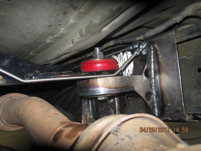

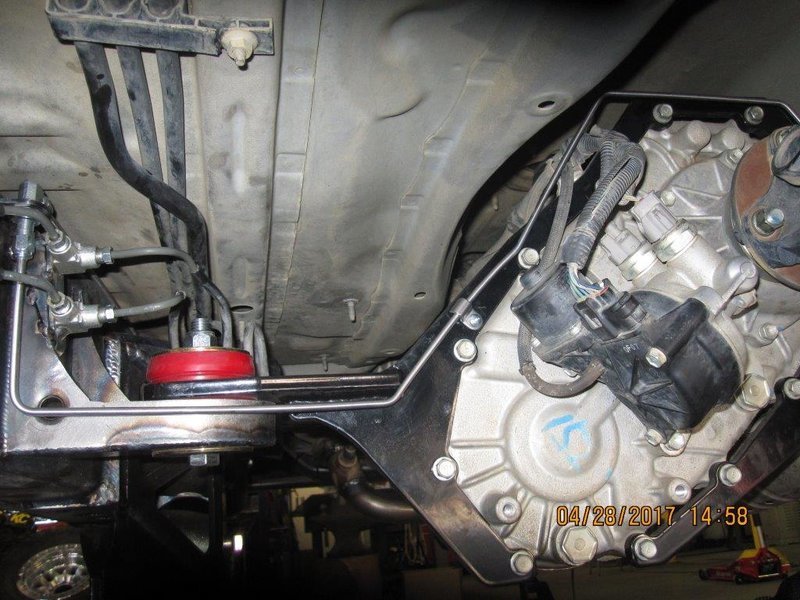

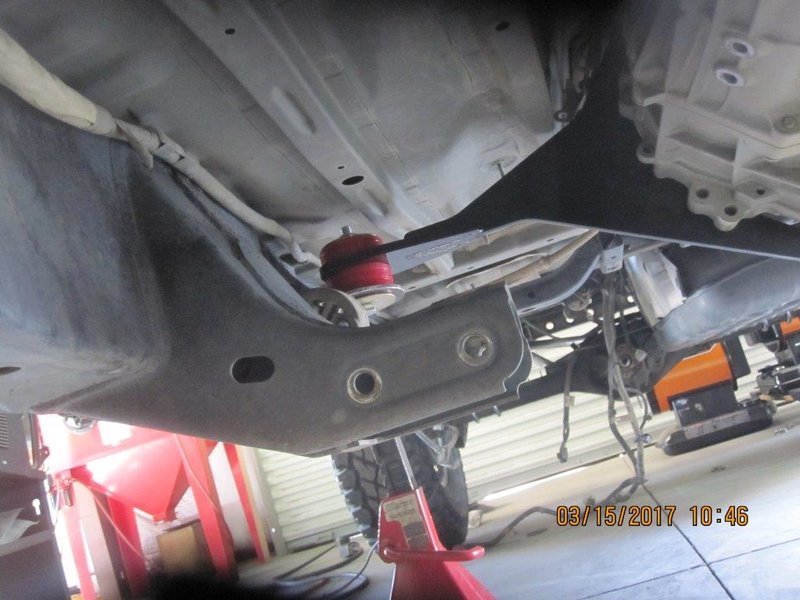

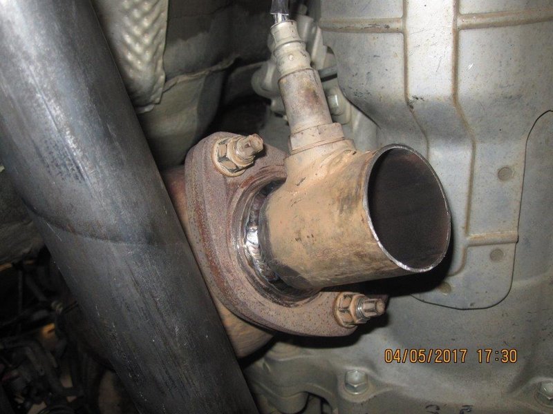

    Found these Pictures, hope they help. Shows the factory cross member in background prior to removal. Sorry took so long:hattip:

  7. Apr 27, 2017 at 8:35 AM
    #247
    Wishbone Runner
    Wishbone Runner Because 4R
    Sep 9, 2012
    #86546
    6,338
    James
    CO
    04 SR5 4Runner
    King/Dirt King
    So did you add a tranny support or removed it all together and this is now supporting the tail end of the drivetrain?

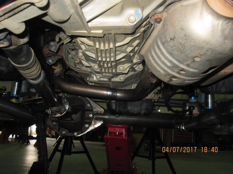

    Very true LOL. That's why I always laugh when people start posting stuff about how easy/fast/cheap it can be done. Yea whatever :D
    Man, this project is really turning out great! Very unique with that rear suspension.
    I was just thinking the same!

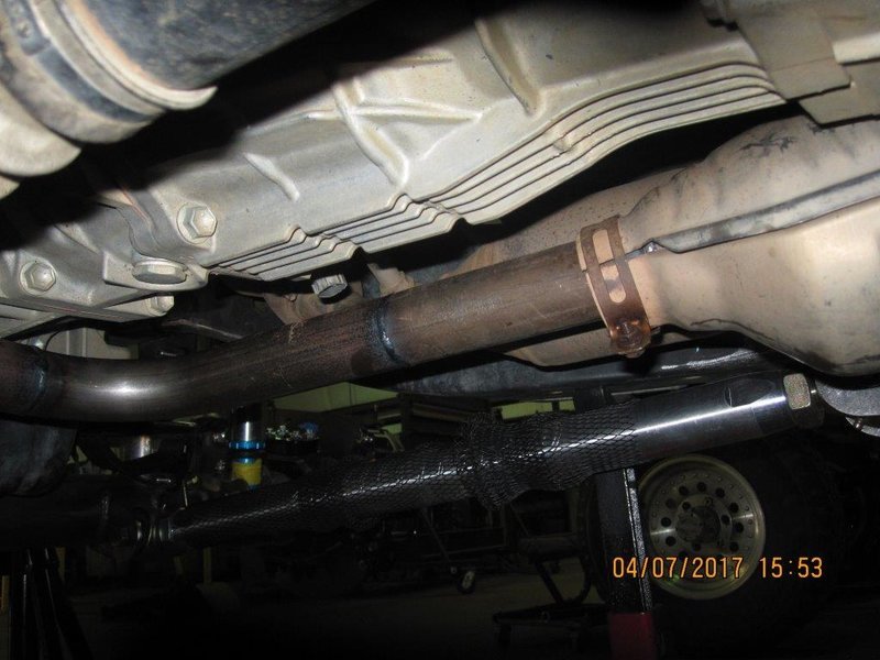

    It's going to be a PITA to deal with dual cases and/or tranny work.

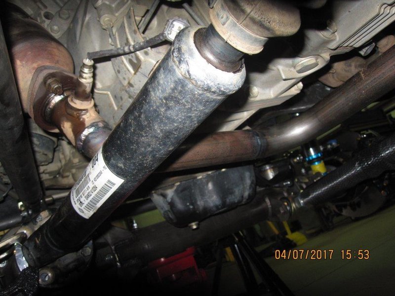

    OP: is it easy to remove the exhaust if you have to do tranny work?

    Correct, this is supporting the tail end of Trans now

    Yeah I have almost 2 years planing and more $$ into this project then my truck was worth.:annoyed:Far as the exhaust/trans is concerned, I have not seen it in person yet but my builder said its not going to be bad at all. We shall see!!

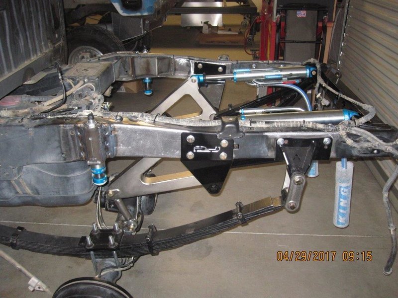

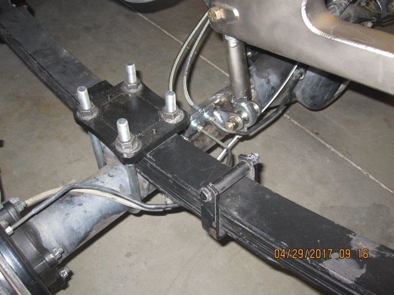

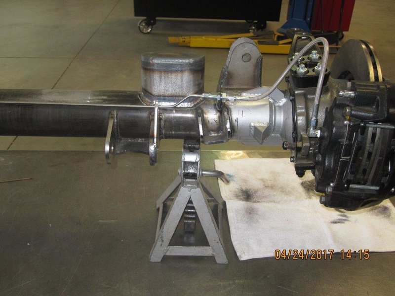

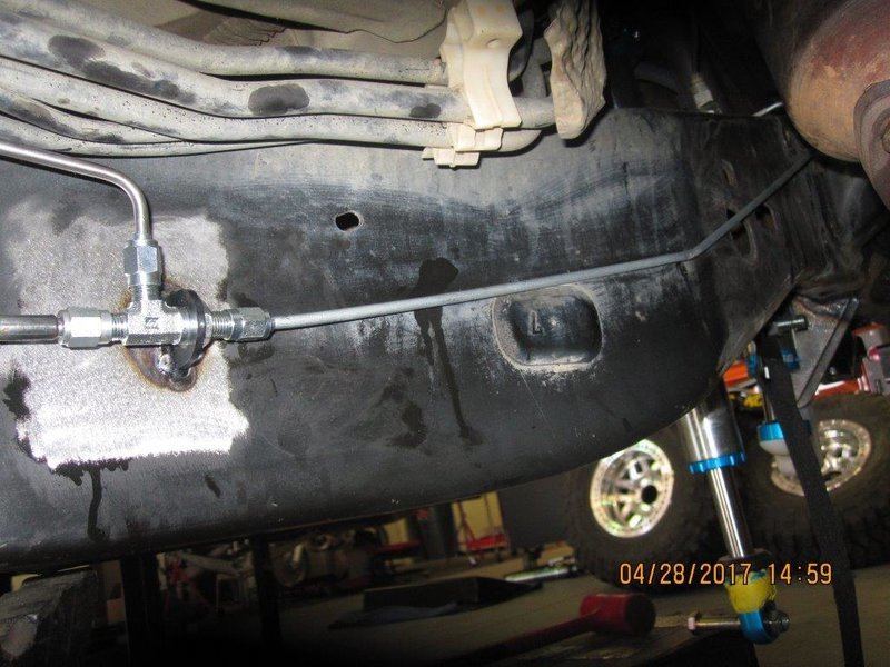

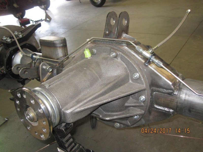

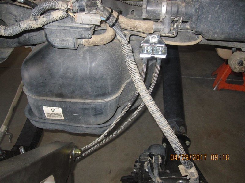

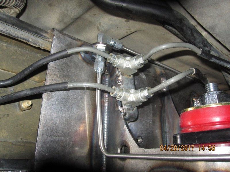

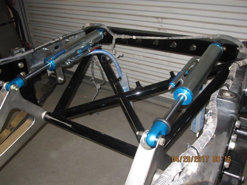

    Some pictures from the work last week...:hattip:
    All the brake lines are in. Single line will run up upper link.
    Rear Brake line mounts installed...
    P2W, Nickel, ChadsPride and 2 others like this.

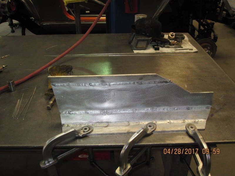

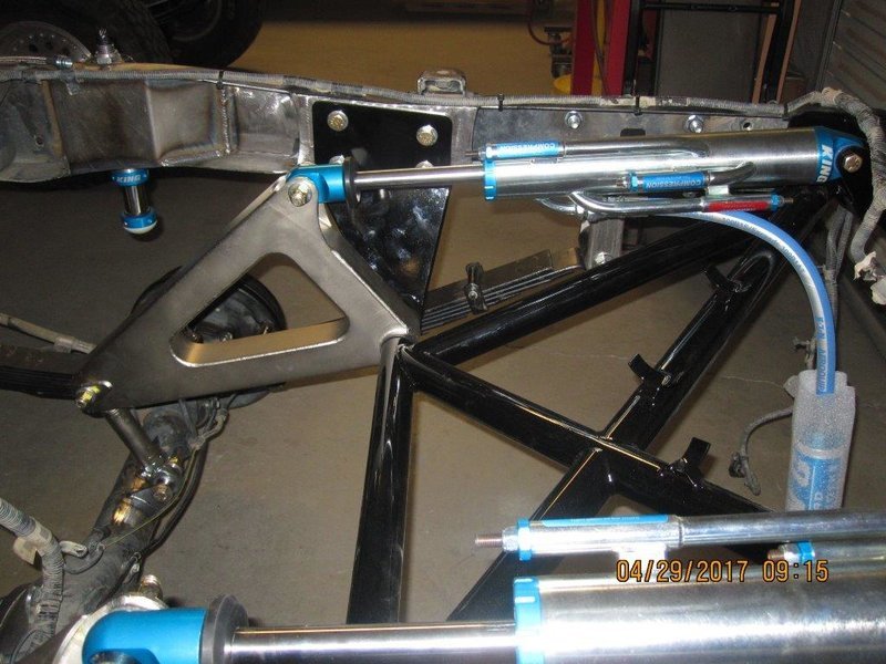

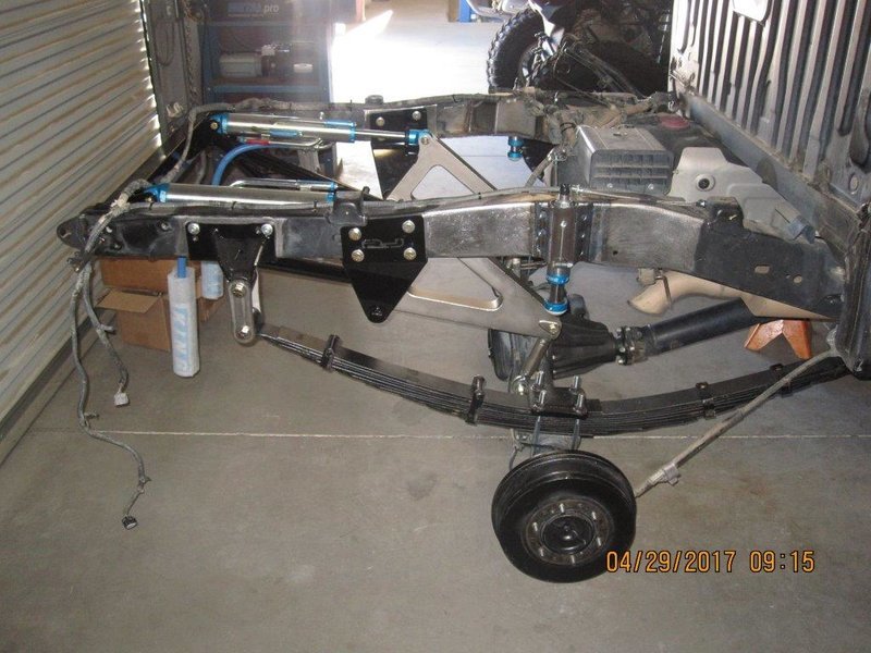

    Rear cage installed after powder coat. I had the Bellcrank and links Nickel plated for that extra Bling...
    Strike pads for the Bumps look great!
    Axle mount for the hydraulic assist.
    Some 4130 Skid plate for a little protection...

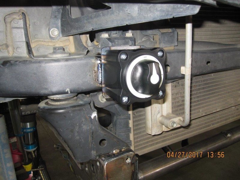

    I LIKE BEER....

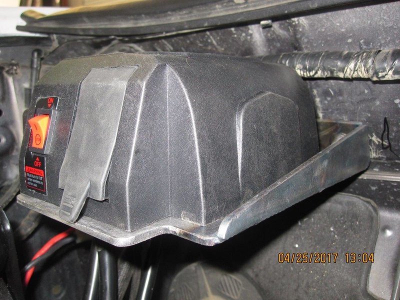

    The winch solenoid was relocated in engine bay...

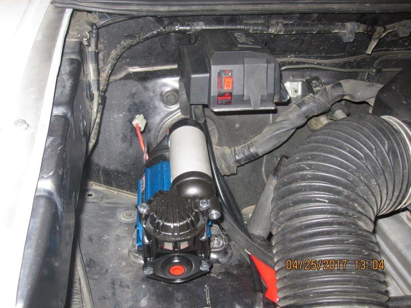

    front ARB Compressor found its home.
    Main power cut off for winch installed...

    Looks amazing, Shane. I'm really digging how clean those fluid lines look and are those AN fittings? Looks like they should be attached to a big ol' high-bypass turbofan engine on an aircraft, haha. That's some incredible attention to detail there. :thumbsup: I love this build.
