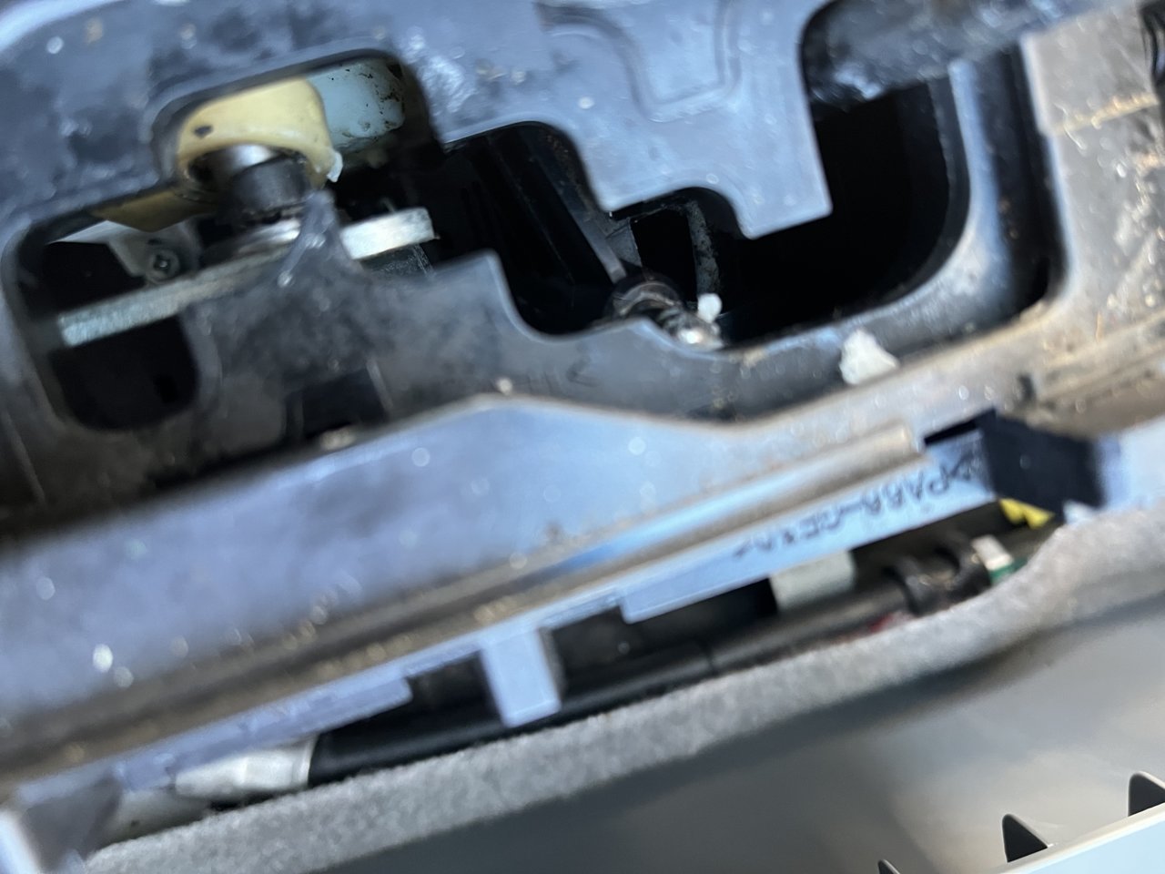

    Ok here is where I’m at
    First pic collar not connected to shifter
    second pic connected collar to shifter but keeps falling. But will fall off in future
    But can’t find anything to hold it in.
    Black washer I think is broken. If anyone knows the part. Please
    HondaGM likes this.

    So it was in drive the whole time cause the cable popped off?
    Steves104x4 and lilredin808[OP] like this.

    Yea there's a grommet that goes in there to hold it on the stud, on some models you can buy it separately but many you have to get the whole shift cable.

    That’s pretty expensive. I’d look on McMasterCarr for a fitting grommet or grab one from a picknpull yard. Lots of different Toyota/Lexus trucks used that same transmission
