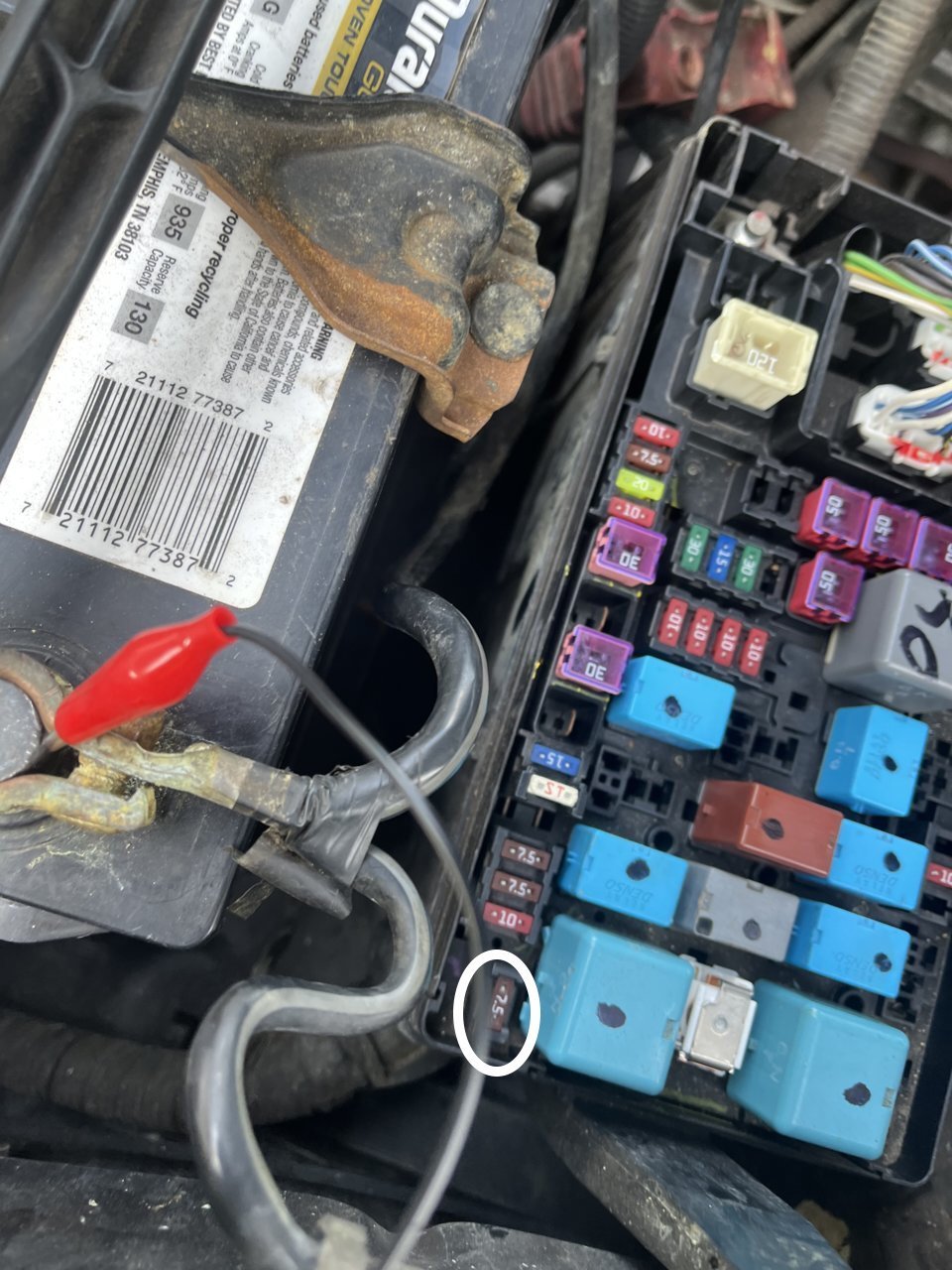

    Idk if I did it right. But connected all points and came out with
    3 no light
    5 lights
    1 no light
    2 no light
    All while cranking each pin

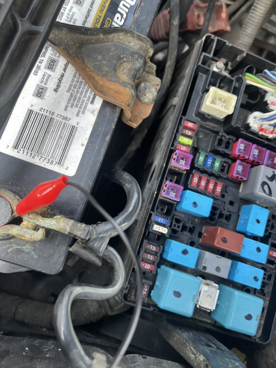

    Not at the relay, you need to check the STA fuse 7.5A

    Check it just as described below

    But does it have power with the key in the crank position?

    Yes one side only. Closest to the fender lights up

    Then the fuse isn’t good.

    Then it's no good if you only have power on one side.

    Fuse is good it’s not burnt out and tested it with the multi meter. Has resistant. I tested the fuse outlet.

    What about with the fuse installed checking the top pins of the fuse?
