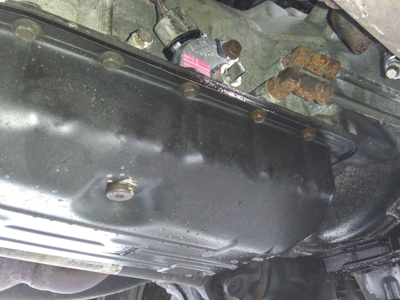

    Um. Where is this located

    On the side of the transmission

    Yea didn't think of that, well you could unplug it and check Pin 4 (Violet) for power with the key in the crank position.
    If thats good then jump pins 4 and 5 together but be careful not to damage the terminals, reinstall the starter relay, and see if it cranks.
    Under the truck on the right side of the transmission.

    FWIW, that picture isn’t of mine.
    I stole it from google. :rofl:

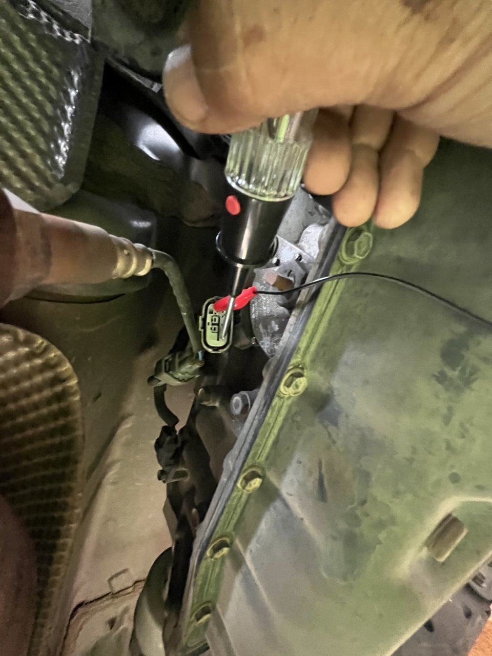

    Ok idk if I did it right. But when we crank it lights up

    Looks like you are using the test light as a jumper.
    Put the clip end of the test light on chassis ground. (Frame, bolt, etc….)
    Then Check pin 4 for power.
    (It probably has power, since the light lit up)

    Put clip to frame and motor to ground. And probe to pin 4. Both locations didn’t light up

    In this picture.
    It looks as if you are jumping pin 4 (red clip) with pin 5. (Test probe)
    You need to put sharp end (probe) of the test light where red clip is.
    Then the red clip to a body ground.
    Ideally, you want to make sure the ground is good.
    I sometimes run a pair of jumper cables directly from the battery just to have a good ground.
    But any way, you need to see power on pin 4 (The purple wire) before we can move forward.
