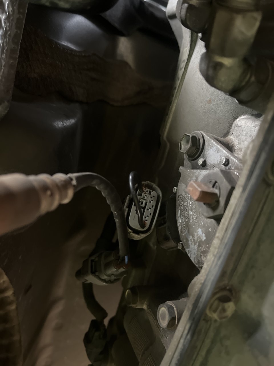

    I was using a wire from a bread bag to fit in the hole. but I can redo it

    Never used that, but I think it would work.
    Easy test would be at the battery.
    Place the bread bag wire in the test light jaws.
    Then probe side to positive and wire to negative.
    If the light lights up, the bread bag wire is ok to use for testing.

    Ok connected a jumper to the negative of the battery. And connected the clip ent to the jumper. And probe to pin 4. And crank lights up

    Now put your breadtie jumper between Pin 4 (Violet) and 5 (Black/Yellow) of the connector, install the relay and see if the truck starts.

    Jump pin 4-5 and no crank
    Sorry it took so long. I thought the bread wire wasn’t strong enough was looking for bigger wire
    you know what. It’s getting kind of late for me. Still got to make dinner can we continue tomorrow.

    You had the starter relay, STA fuse, and starter plugged in when you did this test?

    When I was cleaning up. I noticed that I never plug the sta relay back in. Sorry
    But the starter signal wire was plugged in. Going to check the sta relay first thing tomorrow when I get home from work.

    Ok I reinstalled the sta relay and checked pin 4-5 by the transmission both 4-5 lights up when cranking. Connected 4-5 with jumper crank. And still no cranking from motor
