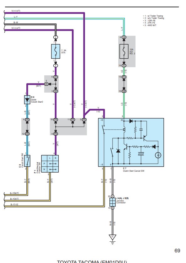

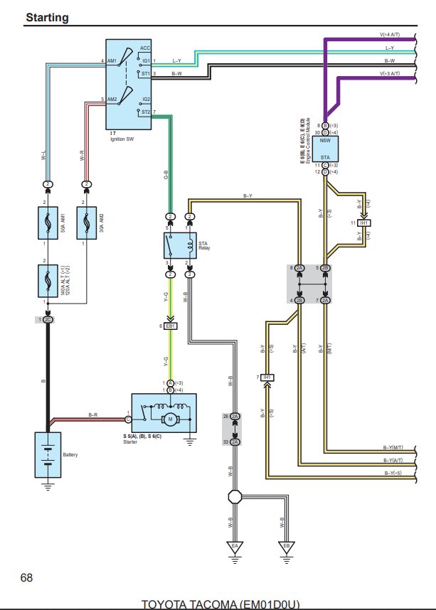

    Cool. Here's some diagrams.

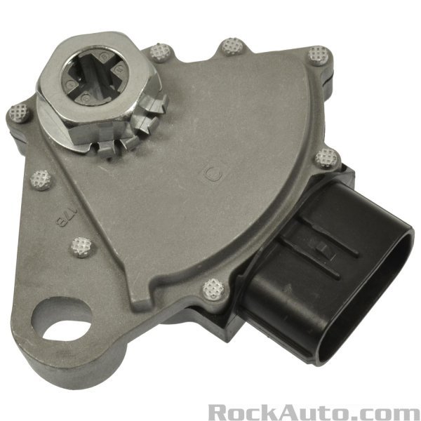

    Do u have any suggestions to fix that or do I have to take it to a transmission shop

    You can replace it but it can be a real pain to replace especially if your in an area where they salt the roads.

    No salt on roads. We don’t live near the beach. Do I know parts I have to get please

    It's typically called the transmission range switch or park/neutral position switch, I don't know the Toyota part number for it though.

    Thank you looking it up now and seeing if they have it in stock

    They have it in stock at O’Reillys. Going now. Lyk when I finish installing

    You’re in Hawaii right? Otherwise I would say go OEM for how much of a bitch replacement can be. You still have super salty air. The transmission shaft likes to fuse itself to the part where it goes in the switch

    Yeah. Ur right. Oem would be better but this is my brothers car. Just want him to to be able to drive.

    That switch has to be set correctly when it is installed, there should be an alignment mark on it. I'll see if I can find and post the installation procedure.
