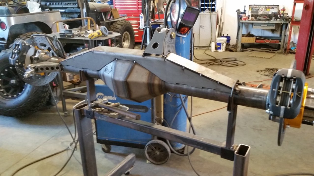

    '11 TRD Sport 4x4

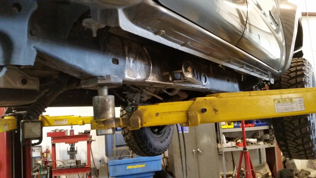

    Everything is tacked up and slowly getting there

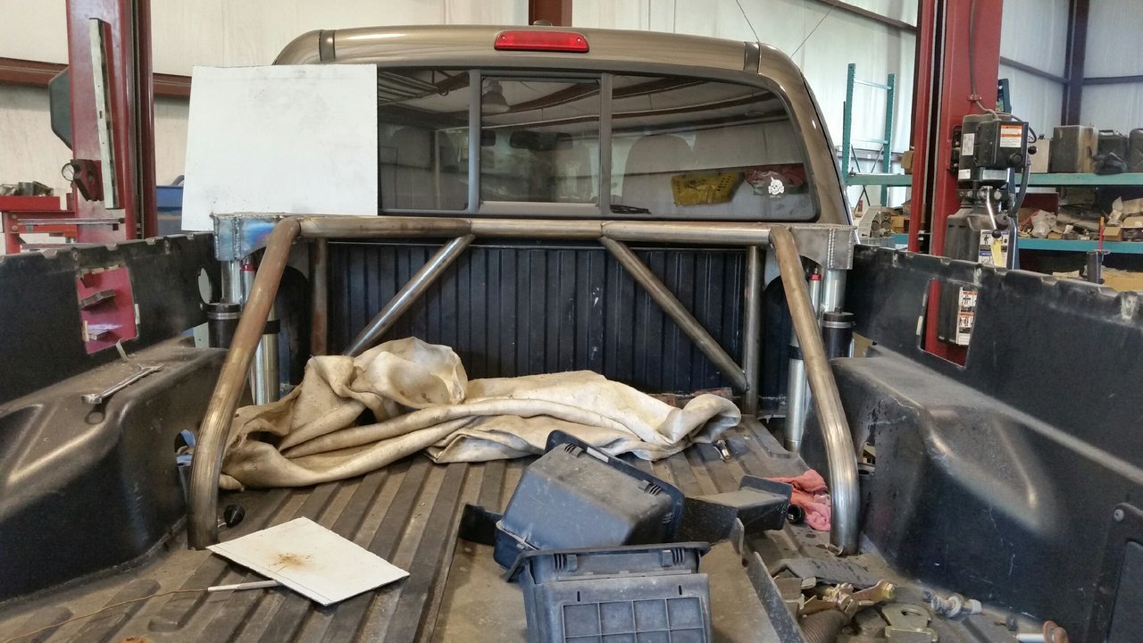

    '11 TRD Sport 4x4
    Bedcage is getting tacked up, more pics to follow

    WTB; 2nd gen well built Tacoma
    Might be time to get rid of the flimsy plastic bed and weld up a tube frame to support the bed sides.

    '11 TRD Sport 4x4
    It's gunna have metal braces supporting the bedsides but I couldn't live with myself if I had a truck without a bed lol

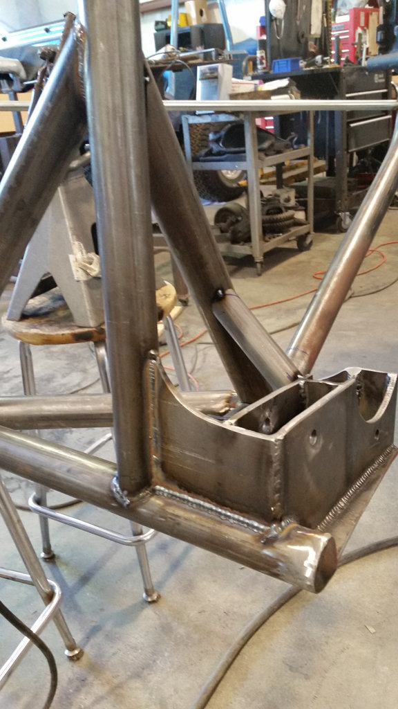

    '11 TRD Sport 4x4
    Start of the bedcage. Making it so I can eventually tie in a cab cage.

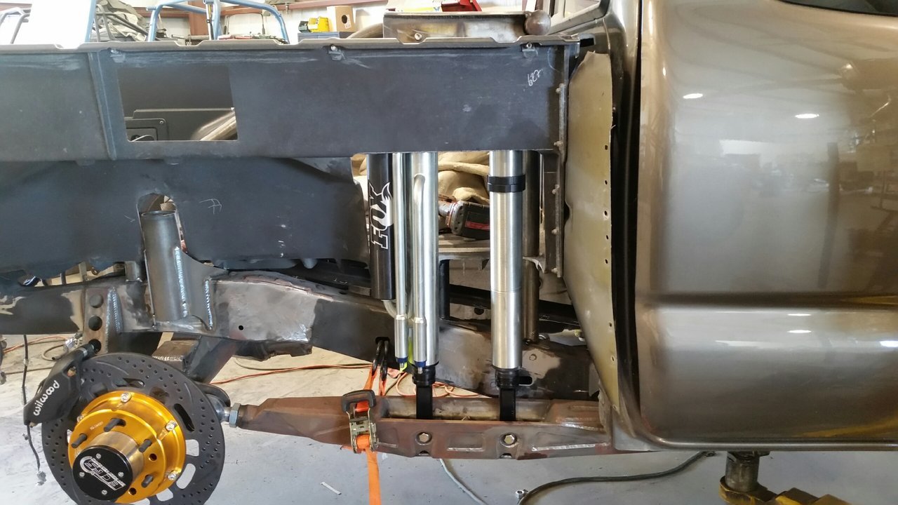

    Coilovers/Bypass mounts
