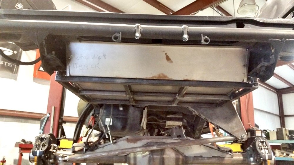

    I really like the idea of the basket under the bed.. Would really come in useful

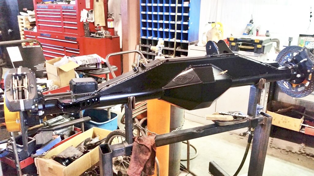

    Thoughts on the trail gear 9" housing? Did you get a roller axle or?? Looks like east coast gear drive flanges but the rest looks like trail gear. Looking at getting one in the future.
  5. Oct 24, 2017 at 5:26 PM
    #105
    89ztrain
    89ztrain [OP] Well-Known Member
    Aug 11, 2012
    #84569
    400
    North Carolina
    '11 TRD Sport 4x4
    Haven’t had a chance to test it out yet, guess time will tell. For the price of the Roller I don’t think you can beat it, sure beats the stock 8.4 axle. Only real “issue” we’ve ran into so far is not being able to use the ABS/wheel sensors

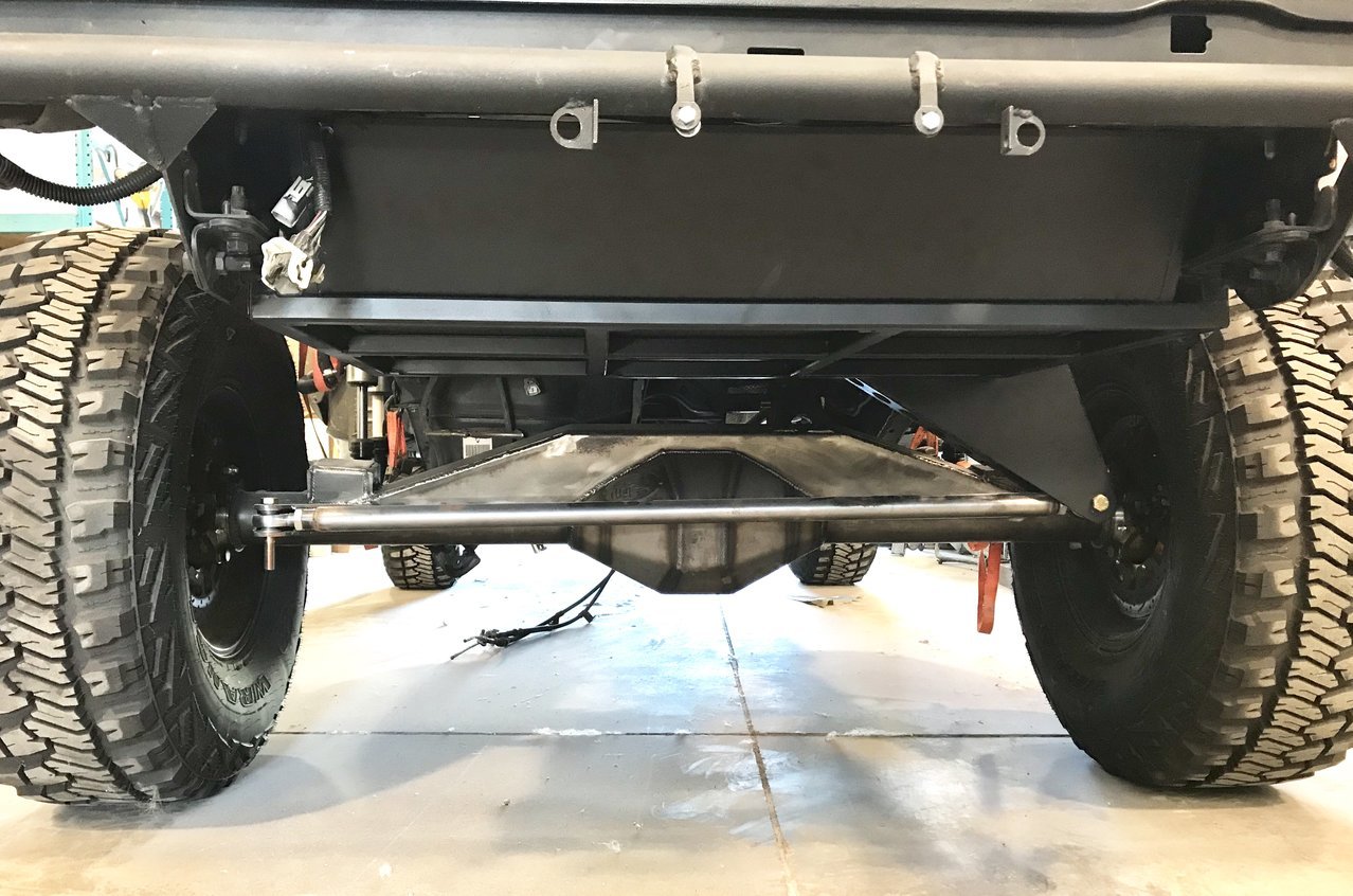

    Los Angeles, CA
    Prerunner Daily Driver

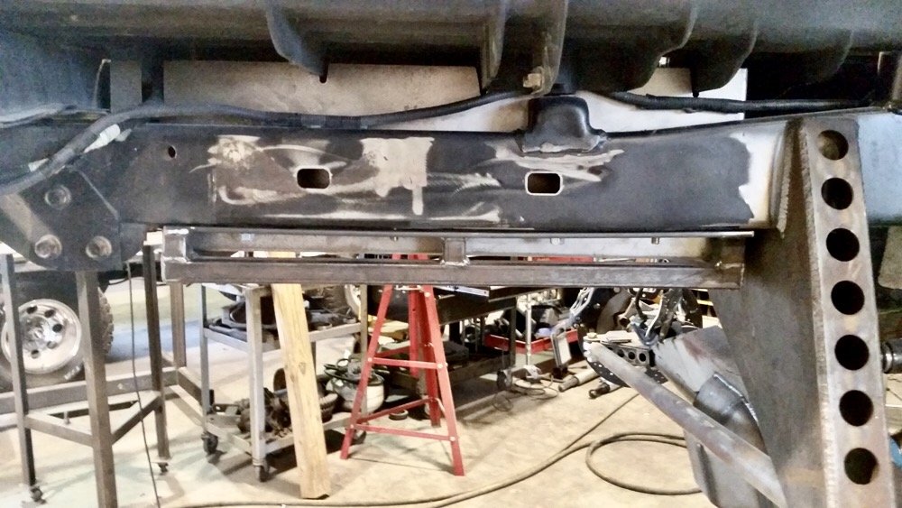

    This is great! Do you have any pictures of your upper link? Do you have it going to the factory crossmember? Thanks

  10. Nov 3, 2017 at 4:29 PM
    #110
    89ztrain
    Aug 11, 2012
    #84569
    400
    North Carolina
    '11 TRD Sport 4x4
    Sorry this is the only picture I have right now. Unfortunately only got to see the truck for a bit when I took this but next time I see it I’ll get you a better pic and let you know the mounting location!
  11. Nov 3, 2017 at 4:33 PM
    #111
    Evenflow

    Wow, the distance from your lower to upper links at the axle is very minimal, did you mock it up in any of the link calculators ?

    Do NOT run your third to the OE cross member unless you completely box it in and reinforce it with kicked bracing made out of tubing. The OE cross member is not strong enough and it will tear completely...ask me how I know.

    I haven’t done any of the actual fabrication on the truck. I’m gone between 220-280 days a year with work, not to mention I do not have any skill when it comes to welding and fab work. All the credit for the fabrication goes to Scott at Metalwerx Fab here in NC. I had a hard time finding a good shop on the East Coast that was willing and possessed the skill/knowledge to build a quality long travel truck. He has a racing background, and being on the East Coast builds a lot of full tubed rock buggy’s and what not. I think the Tacoma is a nice change of pace for him. No clue on how Scott set up the geometry of the 3 link but I’ll be sure to ask next time I’m at the shop!

    I would never do that. You have any pictures of that carnage? I'd love to see it.

    Sorry no pics but it was reinforced and even had a tube brace from the boxed portion where the tabs were to the inside of the frame. The inside layer of the frame tore too right where that brace was welded to it ! Basically there was constant flex in the cross member and it ended up snapping clean through.

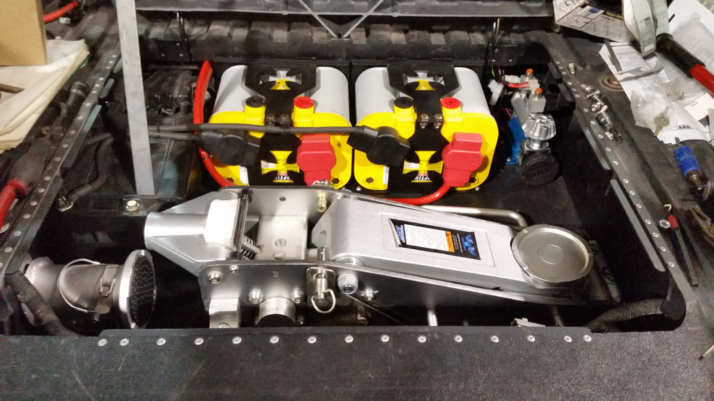

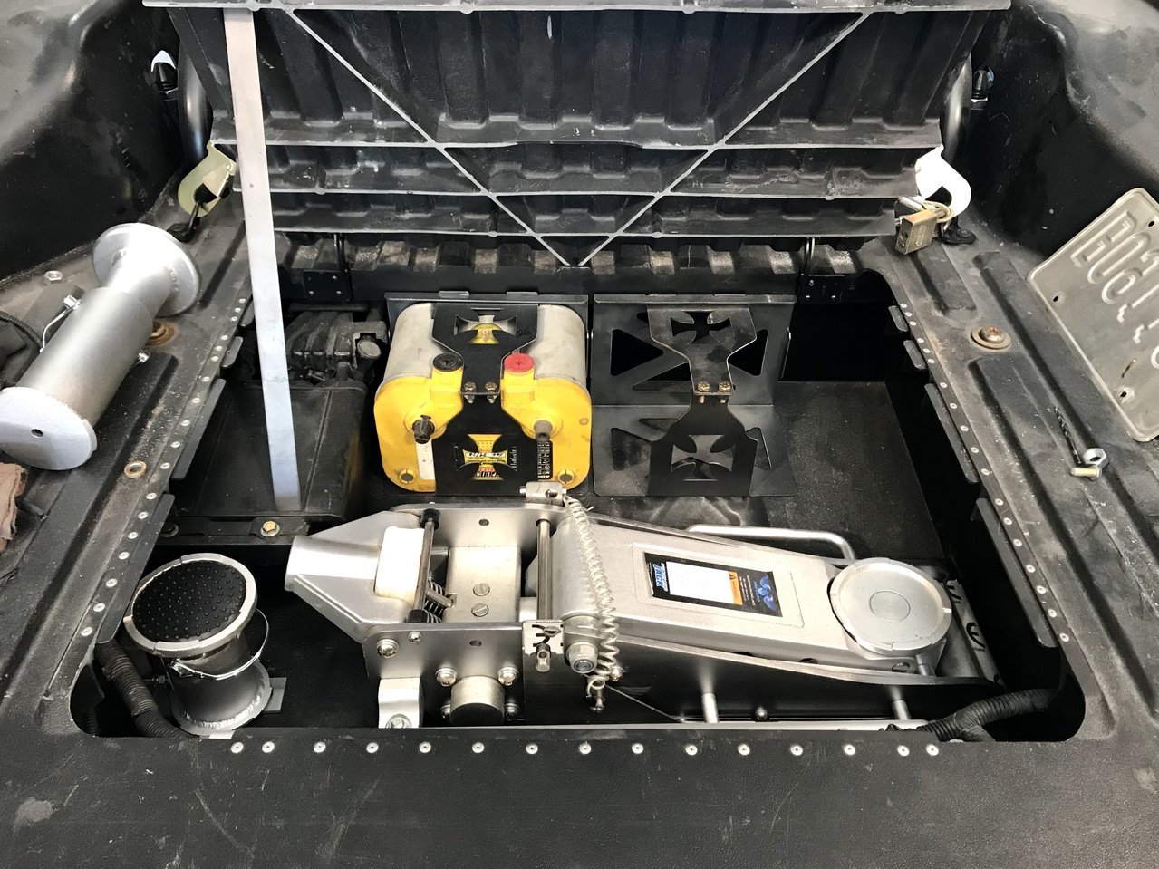

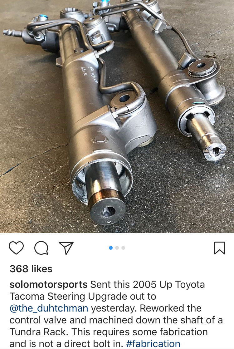

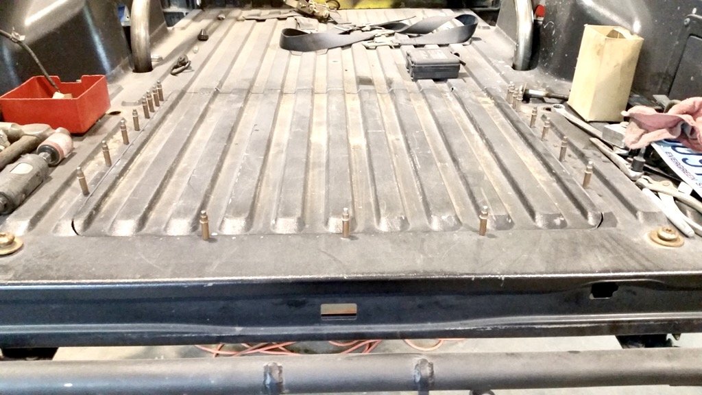

    Bed compartment is getting buttoned up. Batteries, compressor, jack, and latches are installed. Axle just got back from powder coat as well. Waiting on Solo Motorsports 4x4 XLT kit and Tundra rack for the front.

    I didn't know the tundra rack would fit a Tacoma..
    ChadsPride likes this.
  19. Dec 5, 2017 at 6:46 PM
    #119
    89ztrain
    Aug 11, 2012
    #84569
    400
    North Carolina
    '11 TRD Sport 4x4
    It won’t without the modifications Solo does. Hit em up
