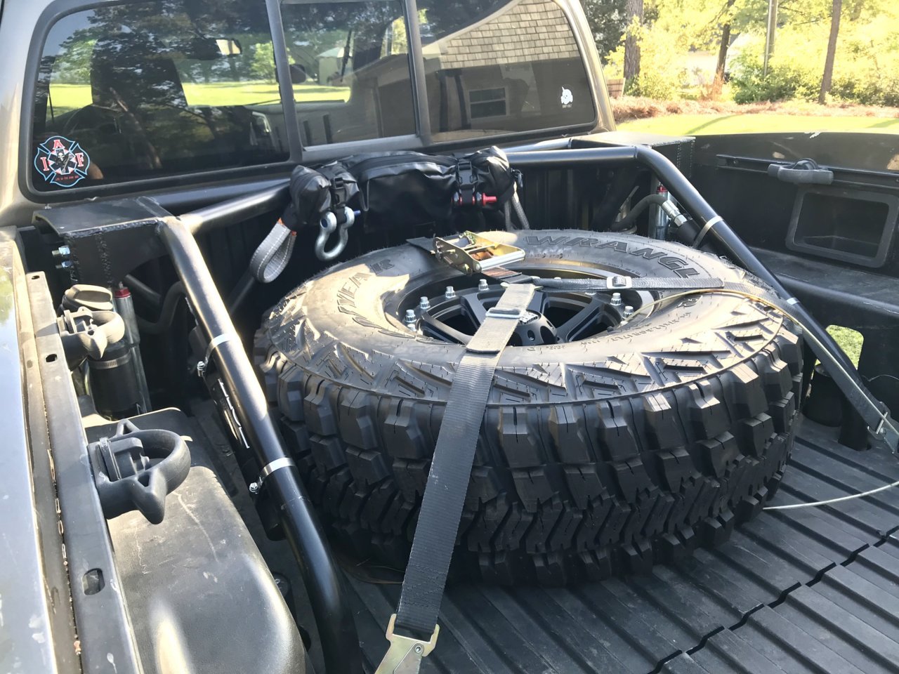

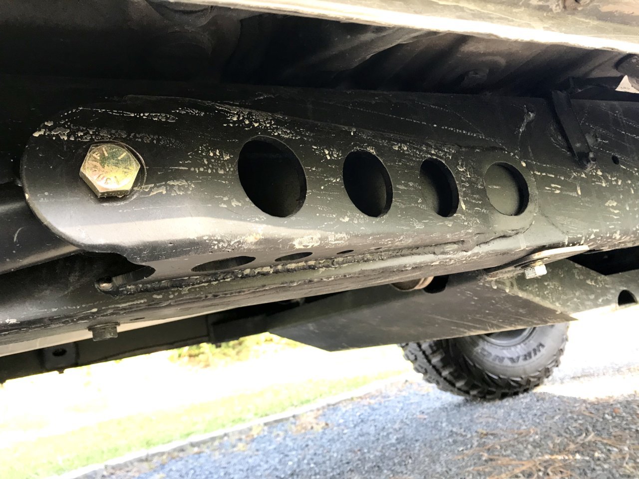

    Trailing Arm mounts:
    Panhard upper mount:AAB3B3D1-3BA1-407D-ABC5-5EDDF572E734.jpg

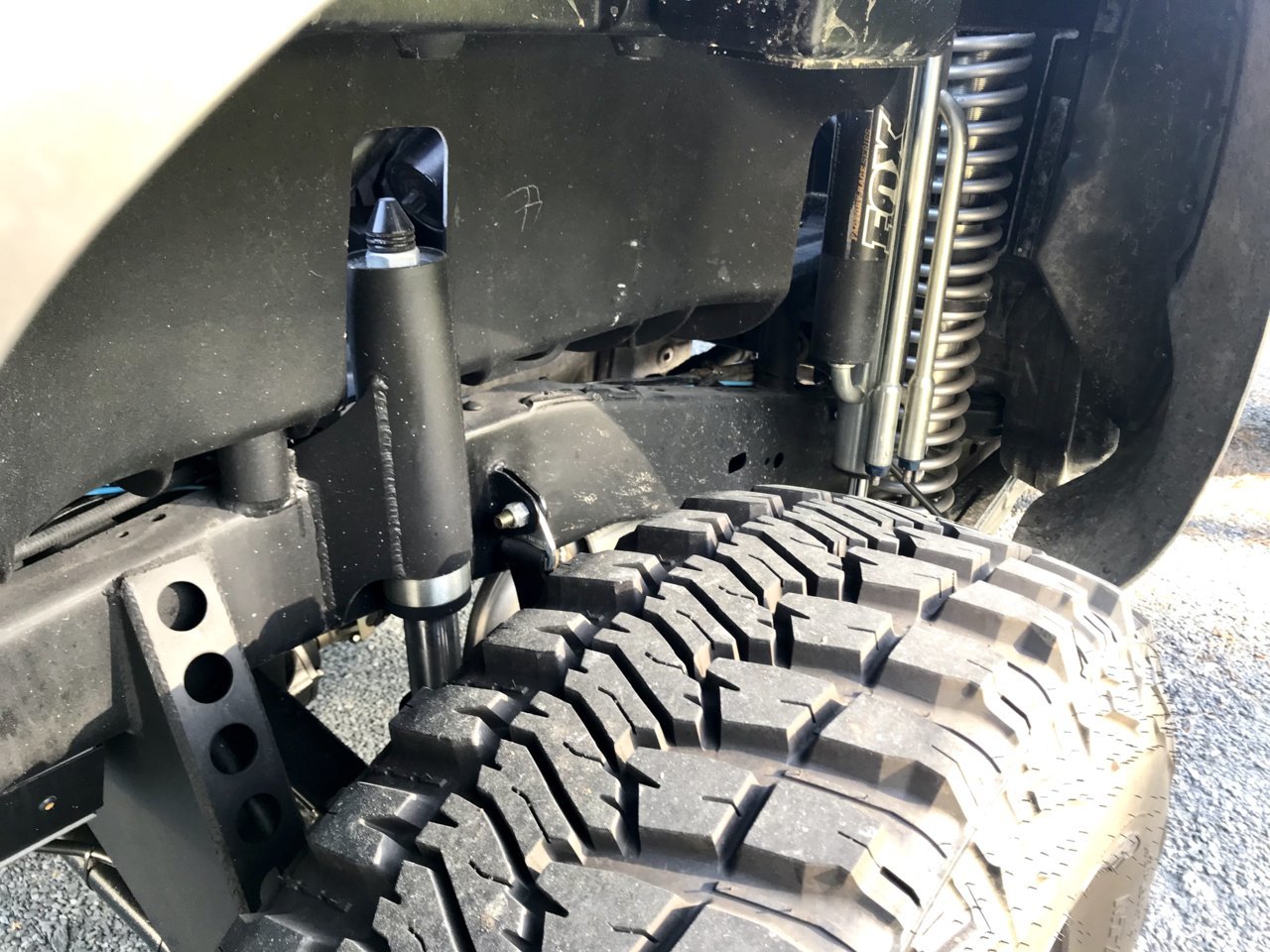

    Ending up getting the 19” out of the Solo kit and strapped the rear right around 27” (10 up/17” down) For all you NC folks out there, I had a great experience with Scott at Metalwerx Fab in Hickory NC. He is a real stand up guy and was straightforward and honest with me throughout the entire build. I’ll be dropping the truck back off in June for a cage and a few odds and ends (supercharger??)

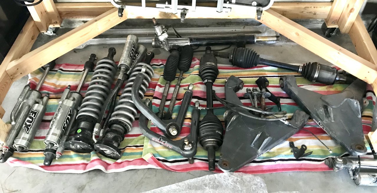

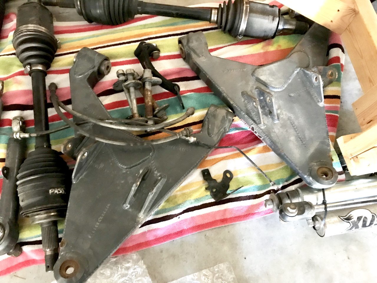

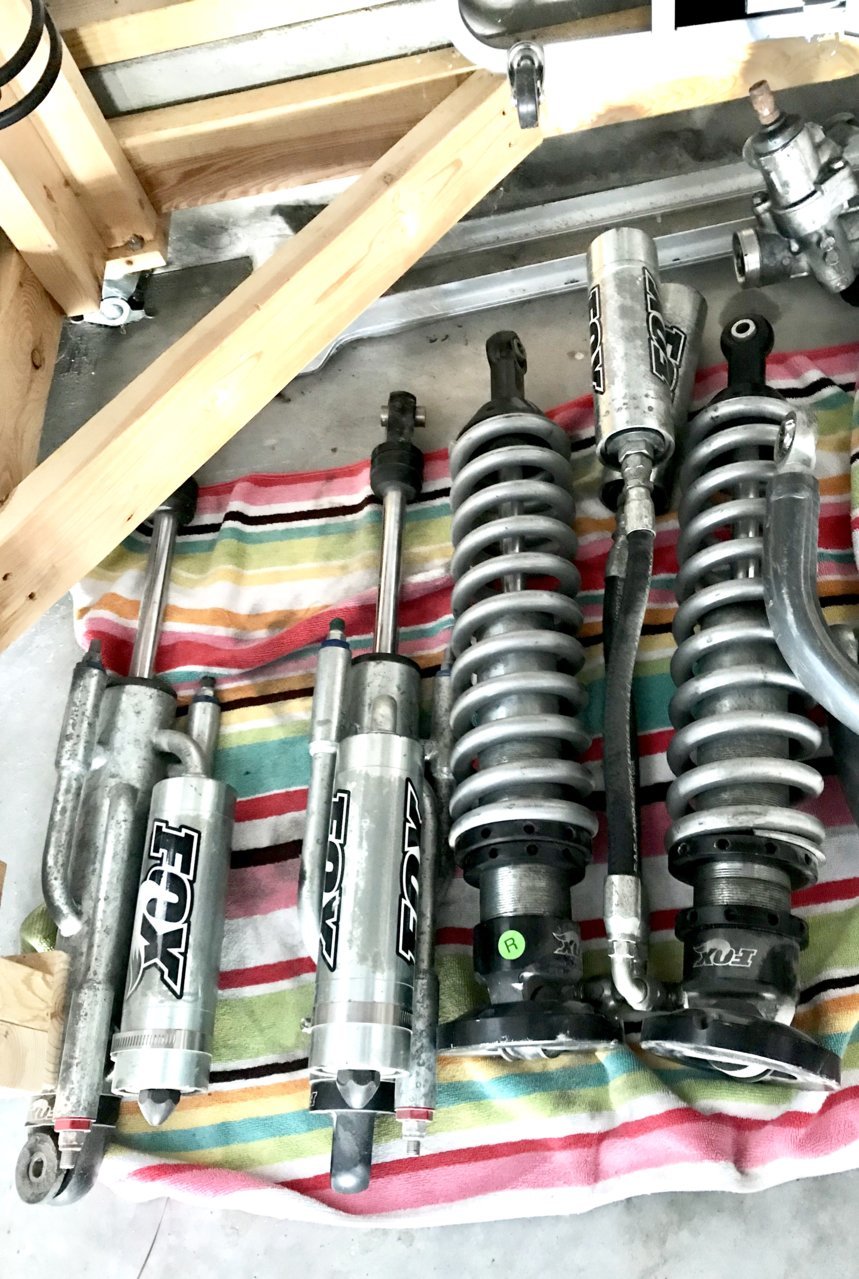

    Selling the 05-15 4x4 Camburg kit that just came off my truck. Bought it in ‘16, about 10,000 miles on the kit. Heim Uppers, 4x4 axles, Fox coilovers and triple bypasses, oem steering rack, gusseted spindles all for sale. Hit me up via PM for price.

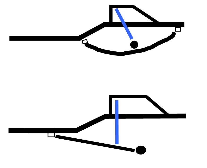

    No ridicule intended amigo that's why I ended with the crazy comparison and the funny rim shot emoji. There are plenty of people ( including myself ) running links without a fully caged truck. Caging your truck is far more about safety when you have a suspension capable of "extreme" driving IE: roll over safety.
    The most common failure point I have witnessed on multiple occasions is the rear bump area, the rear end of the frame will fold right over from a hard bottom out. This is one of the reasons why plating the back half of the frame has become so popular.
    I'm not an engineer but here is a quick sketch of a typical leaf sprung truck w/a bed cage vs a link set up w/ a bed cage. So logically why would a linked truck put any more force on the frame ?
    chasecamper[QUOTED] likes this.

    Those pics are awesome! No, seriously. I can tell just by glancing at them that the main point of stress is where the links bolt onto the frame, in the front. I will use these pics for reference in the future. But on second glance, doesnt the leafs have the same situation?

    To add to what you have said, a bed cage for a linked truck needs to be stronger than a cage for a leaf sprung truck because its taking all of the damping and spring force. But as you said, you will see your highest forces at your bump stops. Either way, adding a cab cage is almost entirely for safety however its generally accepted that if you are going fast and hard enough to use the full capability of links, an accident without a cage would be very devastating.

    I would actually say that the main stress point is in the bed cage where the coilover is, that front pivot point on the link is just that - a pivot point IMO

    The main point of stress is actually the cage taking all the force from the shocks and springs. Until you hit your bump zone and then its wherever your bump stops are mounted.
