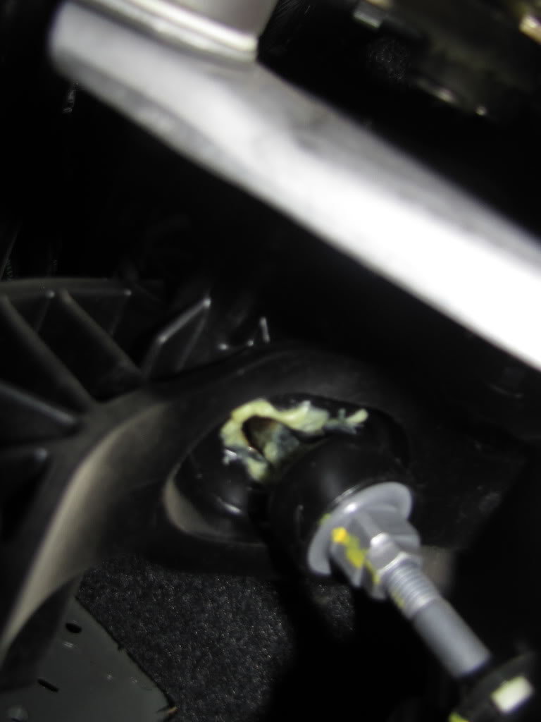

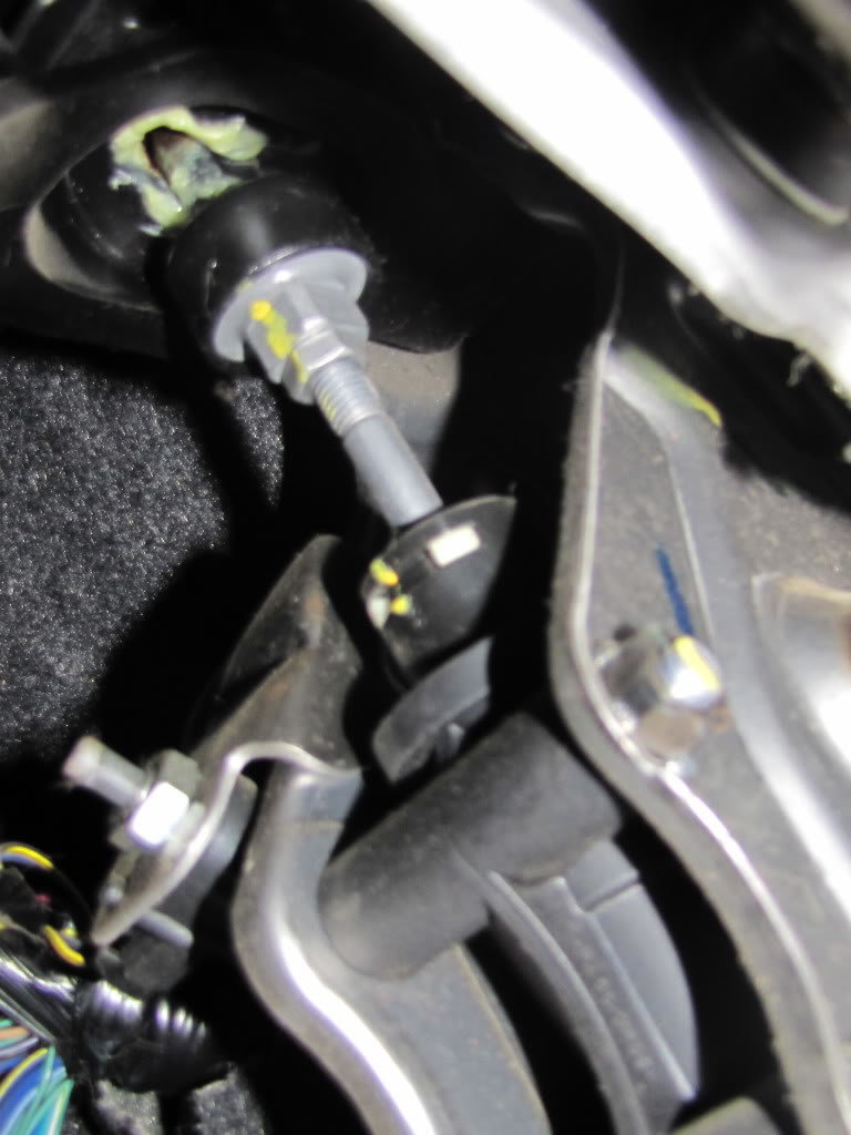

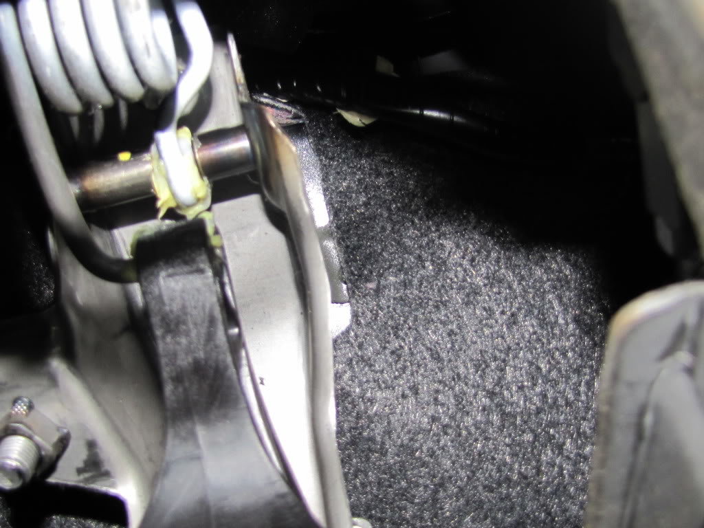

    Yoytoda
    Yoytoda The Little Truck That Could
    Oct 2, 2009
    #23690
    4,947
    Roland
    Big Bear,CA / Upstate NY(Saratoga)
    2010 Tacoma Regular Cab 4x4
    completely stock
    With the clutch pressed you need to grease the return spring pivot on the chassis and the pedal lever.
    With the clutch lever up, grease the pivot where the master cylinder piston connects to the pedal.
    This made my squeak go away.
    I also took the slave cylinder loose and used lucas waterproof bearing grease between the ball and the clutch actuator arm. You need a 12mm to take the two bolts loose and the slave cylinder comes off. dont push the clutch pedal with the slave cylinder removed
