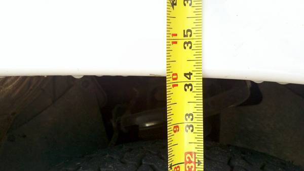

  18. Sep 28, 2011 at 6:52 PM
    #18
    Superx2
    Superx2 Well-Known Member
    Feb 20, 2011
    #51552
    1,619
    Joey
    Iowa

    The tube steps just make it look lower. Take them off and see how you like it. I also think stock height vehicles with rims that have a lot going on make the vehicle look lower but that's just me
  20. Sep 28, 2011 at 7:01 PM
    #20
    jandrews
    jandrews Carolina Alliance Southwest Region Ambassador
    Jun 7, 2009
    #18122
    12,186
    '09 FourDubDee TRD OR
    A-TRUCK, Fat Kid in the Bed, Custom Pinstriping, Ported and Polished Muffler Bearing, Hi-Performance Bed Mat
    Tube steps, sliders, etc. all give the optical illusion of being lower to the ground...and technically do cause a small loss in clearance, but in the case of sliders I'll deal with it.
    Stock trucks from wheel hub to fender is about 20" front and 21" rear. Measurement from the ground can vary due to tire size.
