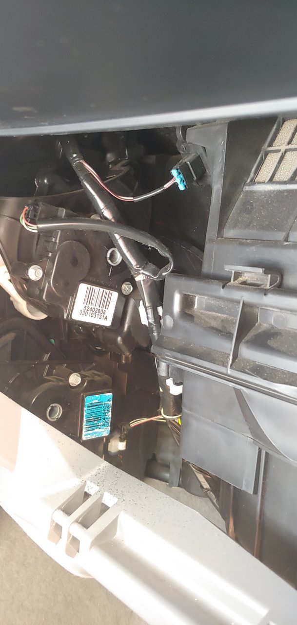

    I'm not sure as that is a 1st gen, I'm asuming the linkage to the heater control valve (which the 2nd gen trucks dont have).
    2nd gen trucks don't have any linkage on the HVAC system, in the case of the temperture actuator it drives a cam that moves the door, the mode door actuator drives a cam that moves multiple doors in sequence, the recirc door actuator is physically attached to the door and moves it directly.
    It's not very common for the cams and levers that move the doors to break or bind up on 2nd gen trucks but it has happened.

    20220424_163908.jpg Update:
    Looking at the recirc and two panel control actuators, all modes and function seems to be perfect and all in correct position. All modes are flawless and clean with no grinding, noises, etc.
    Here's a picture of it on full cold, face vent, recirc closed

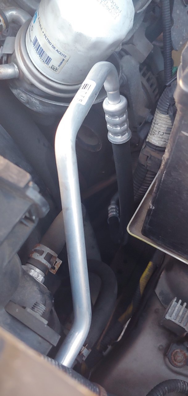

    UPDATE: I forgot to post a final update on what the issue was. She was definitely leaking refrigerant. I didn't get a picture of the old hose, but here is the new one installed. The old one was covered in freon and green factory dye. Replaced it, charged up the system = ice cold again!
