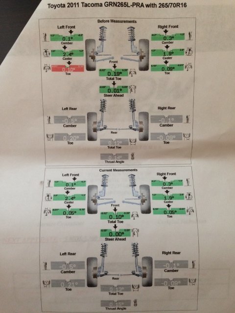

    So here is an update and I would appreciate some input/help. A few days ago, we had a cold front come through with strong winds. Because of my issue, I have to FIGHT to keep my truck straight on the road when the wind is like this (more than normal - but this all began with these new BFG AT's). Because of this, I was pulled over as the office thought I was under the influence. Luckily, I had paperwork with me to show I had this issue and was fighting with the dealership on it. He was very understanding and sent me on my way.
    That was my breaking point. I am not quite pissed. However, I have narrowed this down to the truck pulling to the right on none windy days (more than a vehicle should - so no wonder I fight to stay straight).
    Yesterday, without appointment, I took my truck to the dealership (Toyota of Grapevine). I explained my issue to another rep (New tires, wavy driving, pulling to the right, alignment done, tire pressure changed, etc). I explained that it is extremely noticeable past 60mph and if needed, I would ride out with the mechanic. I also wanted the alignment checked again because just hours before I had our company mechanic put this on a lift and look - he said a wrench hadn't even made it to adjust anything and that he doesn't believe an alignment was done. I was willing to wait....and wait I did. I was there from 12:30pm to 4:30pm. At around 3:30pm, I was called back and explained that during those 3 hours, all the technician did was drive it around the block at 45mph (something about can't go above this on their own due to company policy) and didn't find any issues. I started to get frustrated and said nothing I had asked had been done and wanted the alignment looked at again. I waited and an hour later I was told "good news - he adjusted the alignment and the truck is better now". I thought odd..how can it be better now if the mechanic said he couldn't find the issue. I said OK, but asked to see the readings of the alignment (print out). Mysteriously no one printed it out....but said it had been done. This is when I explained that I wasn't leaving until I had a reading/print out and if I needed to contact Toyota about the lack of service here, I would. Truck went back on, new alignment readings and I was back on the road.....STILL with a pull to the right.
    Below are the readings from the previous alignment and the alignment yesterday. Knowing NOTHING about alignments, I was told on 11/16/2013 that my alignment really needed to be done. Also, could the alignment from yesterday really have different numbers? Also, both times I told them the tires put on were 265/75/16 vs the stock 265/70/16 the "computer" tells them to do the alignment at. Again, does this matter?
    Here are the readings. Help me understand.
    Alignment 11/16/13
    Alignment 01/24/14
  9. Jan 25, 2014 at 12:15 PM
    #29

    How much lift do you have? Factory UCAs? You might wanna ask the tech if your caster is maxed out. You might have more adjustment but they're not touching it cuz it's technically within spec. Caster at 3 on both sides might help. You might need aftermarket UCAs for that though. Also, is this your first lifted truck? I ask because it took me awhile to get used to the lifted truck feel. My Taco has always pulled to the right also and I've never been able to fix that. I just got used to it.

    I have absolutely not lift at all, just the slightly different size tire.

    Thanks guys. I have rotated the tires twice since this has began and still resulting in the same issue. I am scheduled to take my truck in to my original dealership on Friday. I want them to tell me what is wrong vs me telling them what I think is wrong.
    Toyota of Grapevine has to be the worst dealership for repairs I have ever messed with. They spent $30k on my previous truck trying to fix and issue they never could (I eventually saw all invoices).
    I do have a question. On both alignments, they obviously did it to "computer spec", but did it on 265/70/R16. However, the BFG's I had put on were 265/75/R16. Would they need to change their alignment settings with a different size tire?

    I don't think so. My alignment sheets all say the same thing even though I'm running 315/75r16
