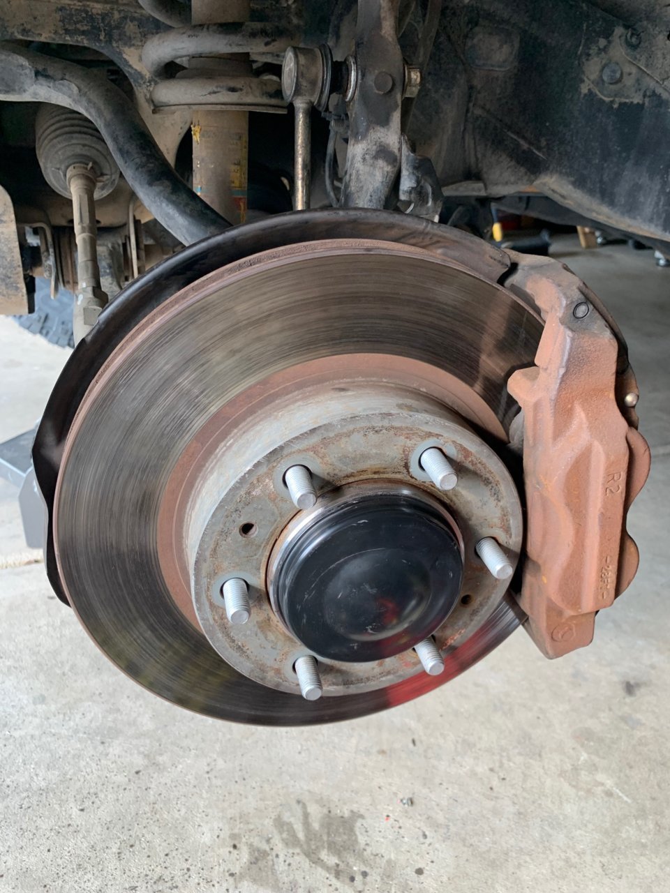

    I also picked up two Toyota seals for the back. These were good but I replaced them anyway. Looks like the inner seal failed at some point and that lead to the bearing going bad. IMG_5958.jpg

    Everything locktited and torqued to specs. If you want to save about $1,000 do it your self.

    Good idea to flip the brake rotor for hub removal, makes me wish I’d saved my old ones.

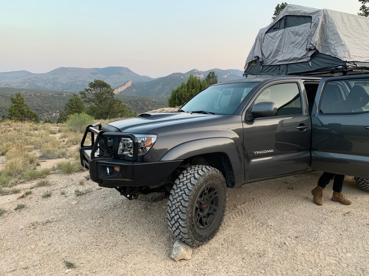

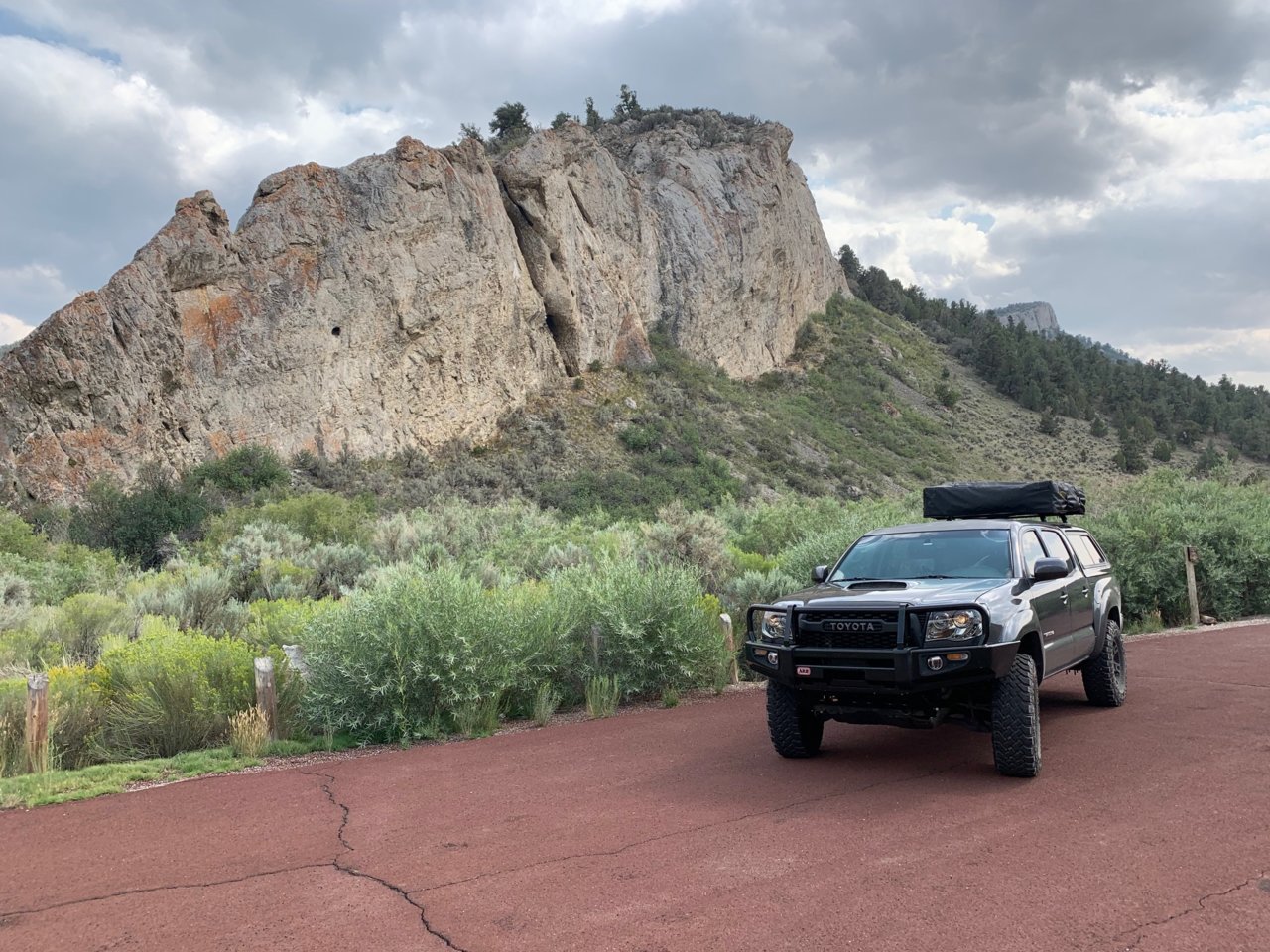

    Well I have been really busy these last few weeks. ARB Front Bumper installed, Bed rug deluxe installed, new front headlight pods and new front grill. The transformation was spectacular if I do say so myself. These mods breathed new life into my rig. I also installed new Toyota plugs and a Toyota MASS Air Sensor as well as oil change and all filters changed out. The in cabin filter was pretty damned bad! If you have one trust me just change it. Cost me $10 bucks or so. I ordered a new X2 Battery 27F. These are rebadged North Star batteries which are probably the best you can get. I changed out all the old grill clips for new factory ones. Here are some pics from my trip. I need to figure out a way to quickly take on and off the roof top tent. Its off now but is a pain to load on by myself. Had the wife help me to get it off the top. Any ideas?

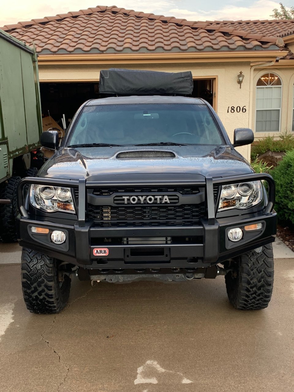

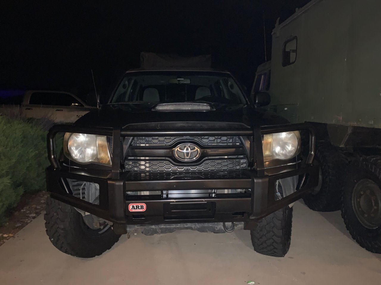

    BEFORE NEW HEAD LIGHTS AND NEW GRILL.

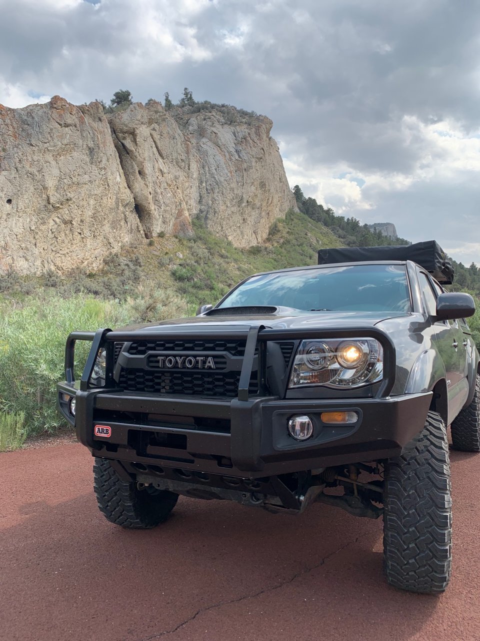

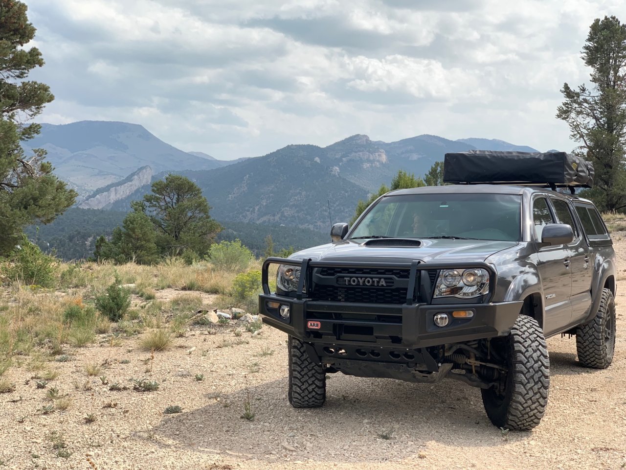

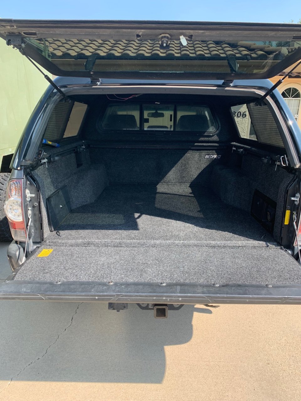

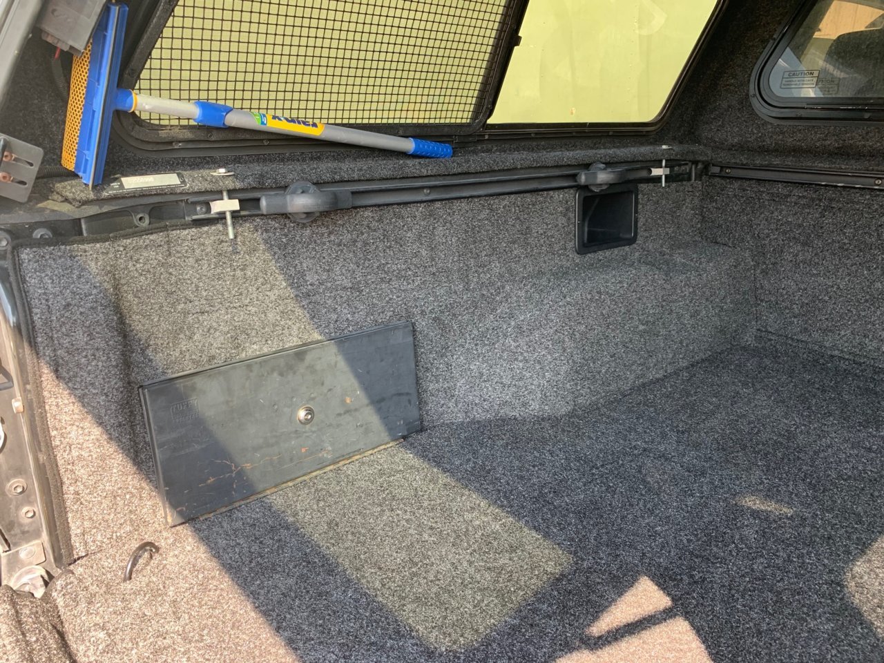

    BEDRUG INSTALLED. THE ONLY ISSUE I HAD WAS GETTING THE SMALL PLASTIC POCKETS TO STAY IN. THEY WERE NO LONGER ABLE TO CLIP BACK IN PLACE UNLESS I CUT THE CARPET WIDER THAN THE CUPS. TO FIX IT I JUST PICKED UP A SMALL PACK OF 6 #8X1" BLACK CREWS. I SIMPLY SCREWED THEM TO THE BED WALL THROUGH THE CARPET. WORKED LIKE A CHARM.
    MY NEXT PLAN IS TO TAKE THAT TUFFY BOX OUT AGAIN AND REPAINT IT.
