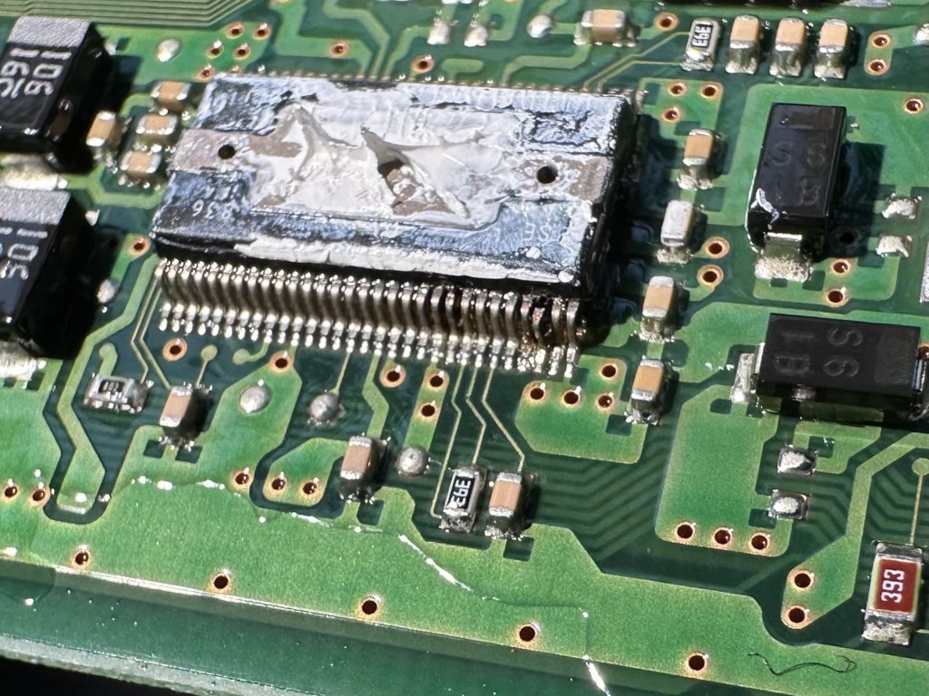

    Popped open the ECU, it was a junk yard unit already, only held in with two screws.

    Yea that IC looks fried.

    Yup, it’s cooked. Thanks for all the help so far. I’ll update when we get the new one installed.

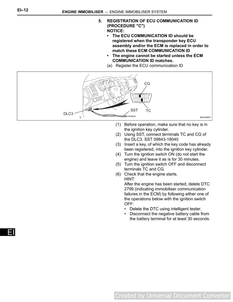

    You will need to perform the Immobilizer registration once the replacement ECM is installed for the truck to start.
    The VIN should also be re-written to match the truck but this isn't necessary for it to run.

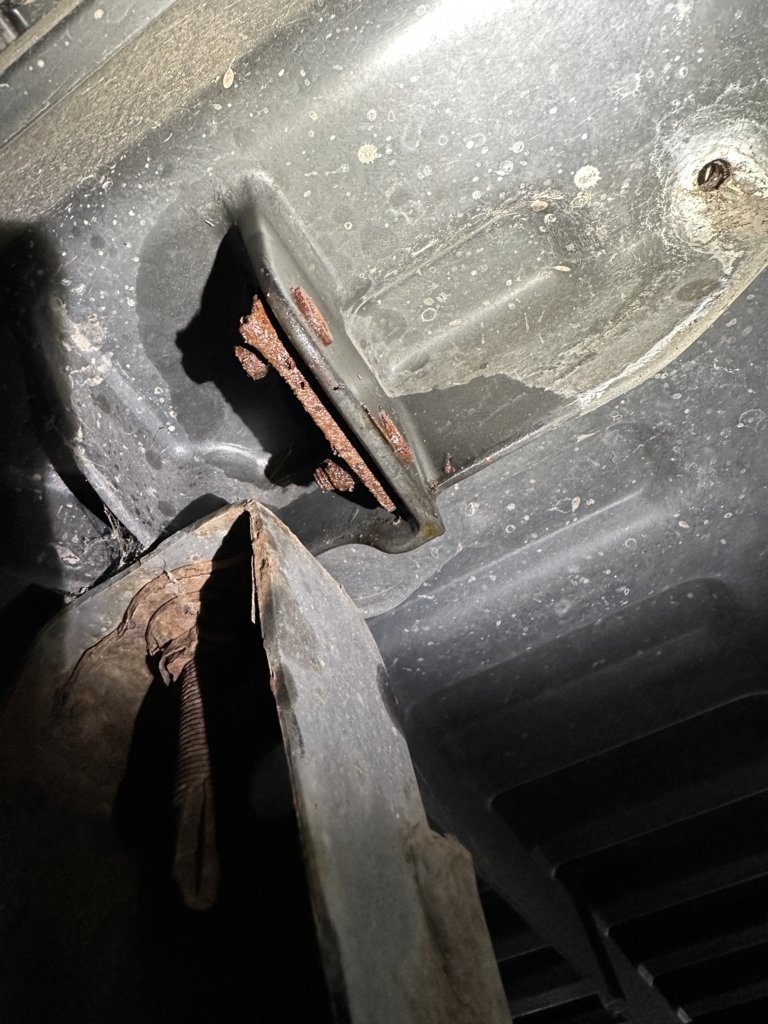

    What do I even call this thing to start looking for ways to remove/replace it? It’s the rear fender support rod mounting point.
    We already bought the bracket, but the bolts snapped removing them.

    Never mind, a unibit on a 90° was able to handle it.
