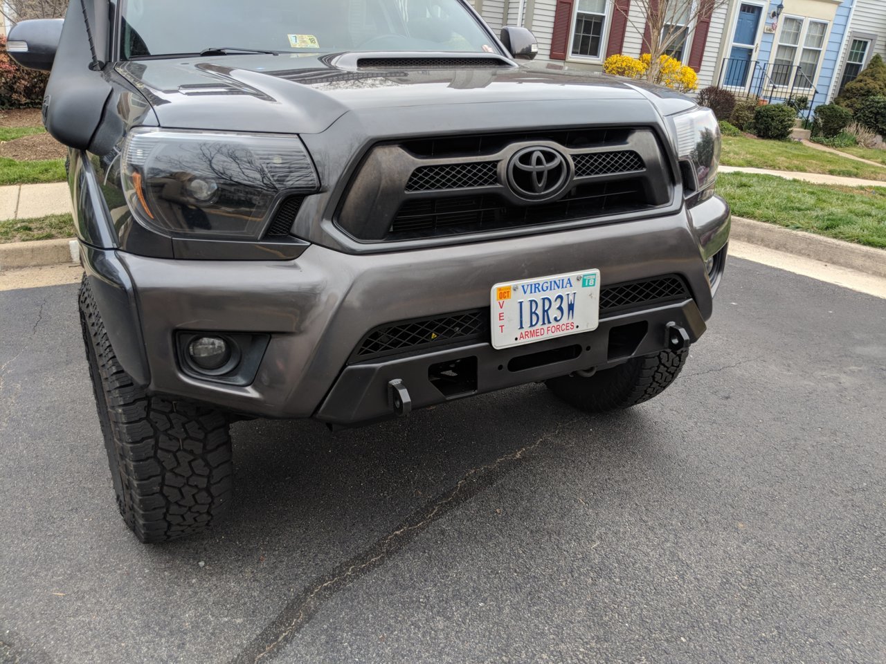

    Got lucky with a warm day and managed to paint and install my bumper in under 4.5 hours after it getting delivered.IMG_20180406_081850.jpg

    Did you need help? I took some photos while I did my install in case other people needed assistance. It's not 100% but should help
