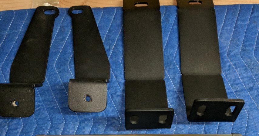

    Yes please. Pm me a few photos. I'll be doing it solo so knowing where the parts fit before lifting and adjusting would be super helpful. I also am installing a Warn 9.5 XP so any recommendation on the best place to mount the solenoid would be great too.
    The written instructions above are also helpful. So a few shots (if you have them) of the 4 extra brackes would be super.

    Thanks for the photos. There are 4 braces looks like the two that have the nuts (on the left) are what connect to the plastic bumper. The other two, I am unclear.
    Where are the expected "cuts in the plastic bumper"? (I have an old dremel is that going to be sufficient?)

    The two on the right are support braces that go where the bumper mounts to the frame.
    Since my bumper was the first one they built I didn't do any of the cutting (they took care of that when it was there for the fabrication work). I imagine a Dremel would work or you could pick up a $20 4" angle grinder with some cutoff wheels from harbor freight (that's what I used on my rear bumper and fender flares).

    Nice !! that makes sense. I suspected that the braces fit there (based on looking at another lo-pro install guide) very cool.
    Makes perfect sense now. (also nice to see which bolts go where) :thumbsup:

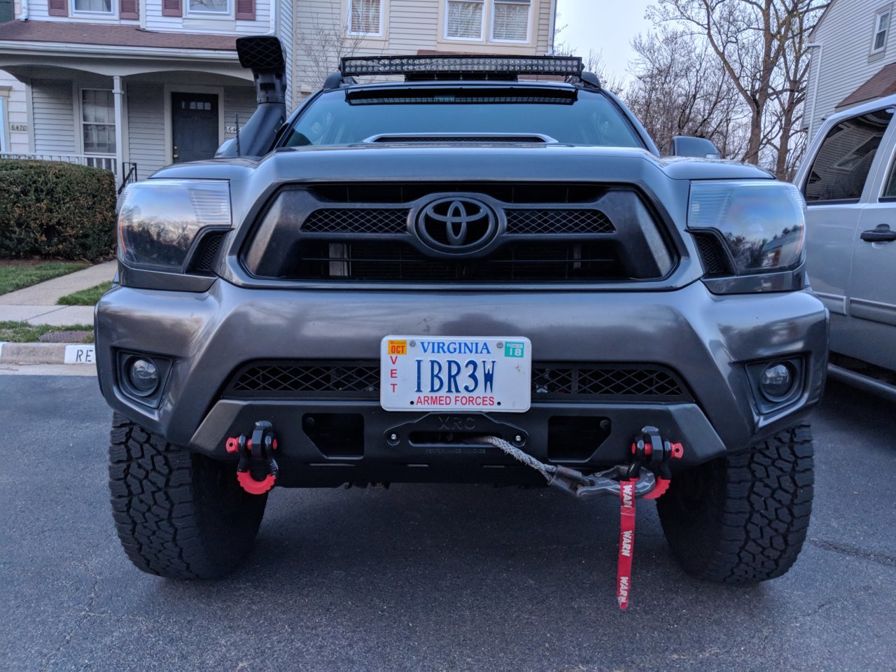

    Looks great now that my shackels are here. Just the look I wanted.IMG_20180408_193647.jpg
