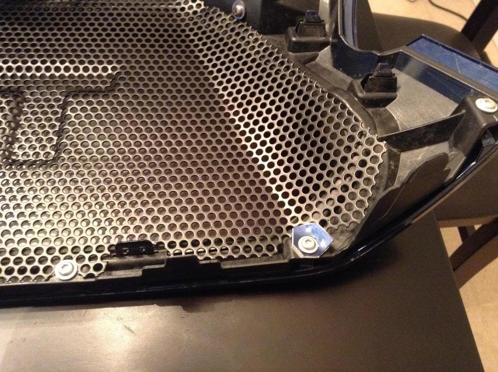

    Im the same way... I check it everytime I walk by it... and probably 50 percent of the time it needs pushed in. I think this also contributed to the whistling to some degree. im thinking I need to somehow secure those tabs at the bottom of the whole surround on the corners. They're also the first to pop out when I removed the surround from the truck.
    My initial thoughts on it, are that with hacking out the plastic inner piece, it lost its rigidity, and then installing the mesh and securing it in place may have bent or warped the shape of it ever so slightly that it doesn't stay in quite as well as it did... again... I'm going to look into securing it somehow... maybe a cotter pin through the tab once its in?

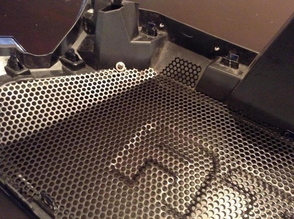

    That is also something that, as homer puts it, something we might chime in about. you might not want to make that cut in the mesh there where that bolt is where he put the plastic "washer" in the first picture... Unless im missing something its just a spot where it could be bolted down with factory screws, but its missing on both sides. just my 2 cents, and trying to help.

    I tried realigning it again, but it still keeps on popping out. Also, the top part where the hood and grill meet seems to not be lining up properly either. It's a little higher than it was before I installed the grill.
    The cotter pin sounds like it'd be a good idea. I was thinking of just drilling a hole in the tab and zip-tying it onto something. lol.

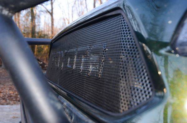

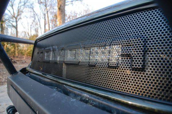

    Finished! Wish I could re do it but not bad for a first try.

    For the guys that are having trouble with the grill/frame sitting right, loosen the bottom torx screws by 1/8 to 1/4 turn. That will allow the frame to relax a bit.
