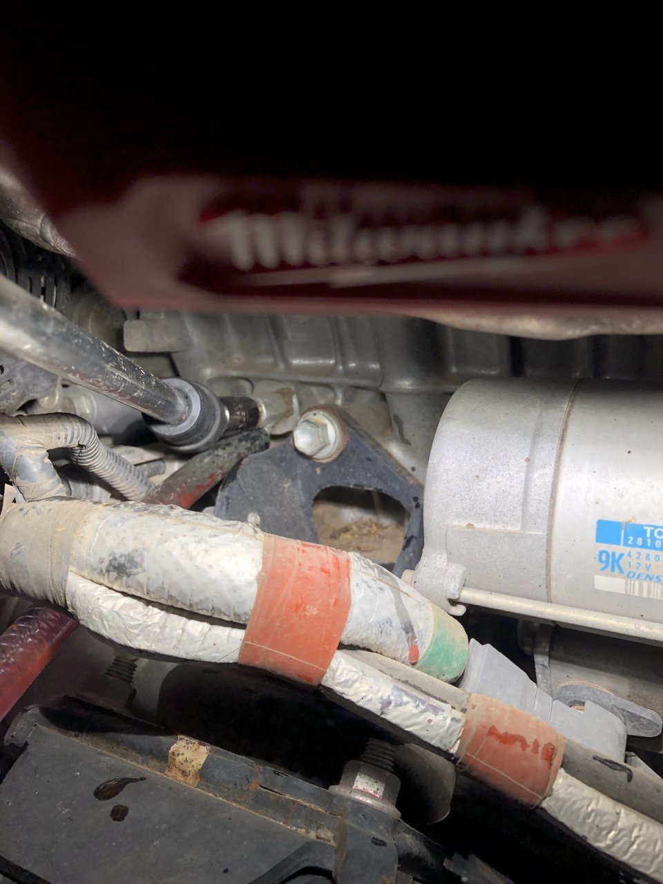

    If this is a shot of your 2015 tacoma it has the later version of the v6 and may have a different
    style drain plug on the driver side. I checked and mine (2012) has the short one under the exhaust manifold
    as shown in the earlier post.

    If you are taking about the video in post #9, my drivers side drain plug situation looks the same. You have to fish around blind for it, feeding the 1/4" ext. I show with a 10mm socket, turning slowly until the socket catches on to the drain plug.

    Your arrow implies that the black fitting is the drain plug. Is this in fact a 1/4 drive extension w/ a 10 mm socket
    and NOT the actual drain plug ?

    My arrow points to a 6" 1/4" extension with a 10mm socket on the end. Anyone who knows what an extension looks like would understand this. The drain plug would obviously be on the socket end of the extension buried underneath.

    The heading on the post said Drivers side drain plug, Not 6" ratchet extension and 10 mm socket attached to drain plug.

    And common sense would dictate the tool(s) in the photo are used to loosen the Drivers side drain plug.
